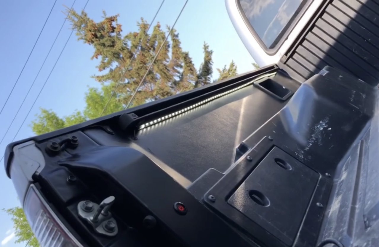

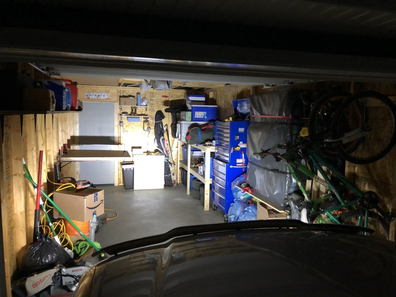

    Installed some box lights with a custom switch.

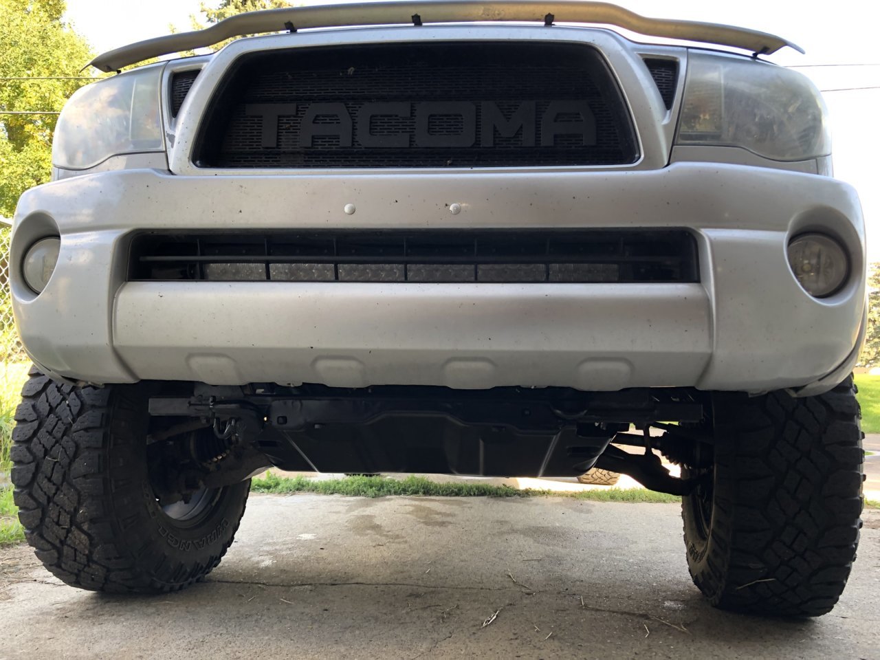

    Painted some rust on the skid plate!

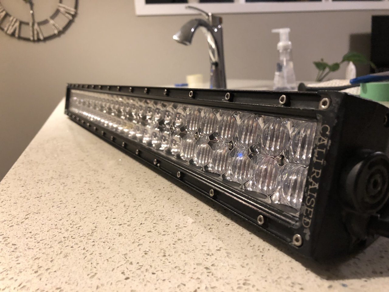

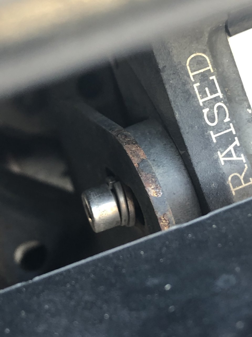

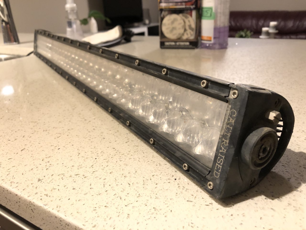

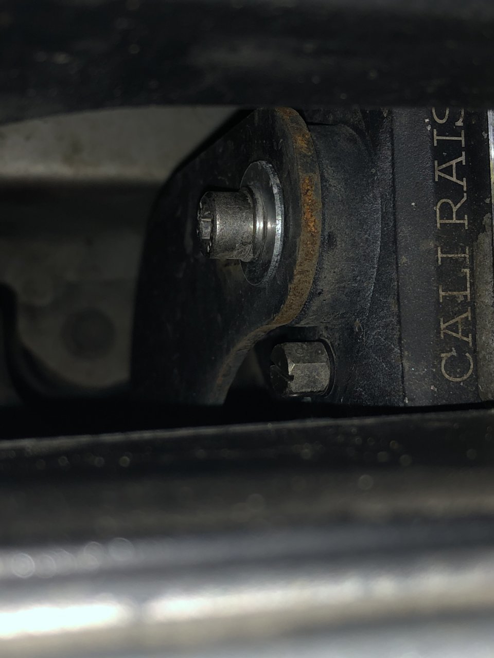

    Cleaned up and refinished my Caliraised light bar that's hidden in my bumper.
    I also upgraded the tiny useless washers they provided. The bar kept rotating upwards and pointing to the stars.
    Light bar before cleaning:
    Light bar after cleaning:
    Original washer:
    New washer:

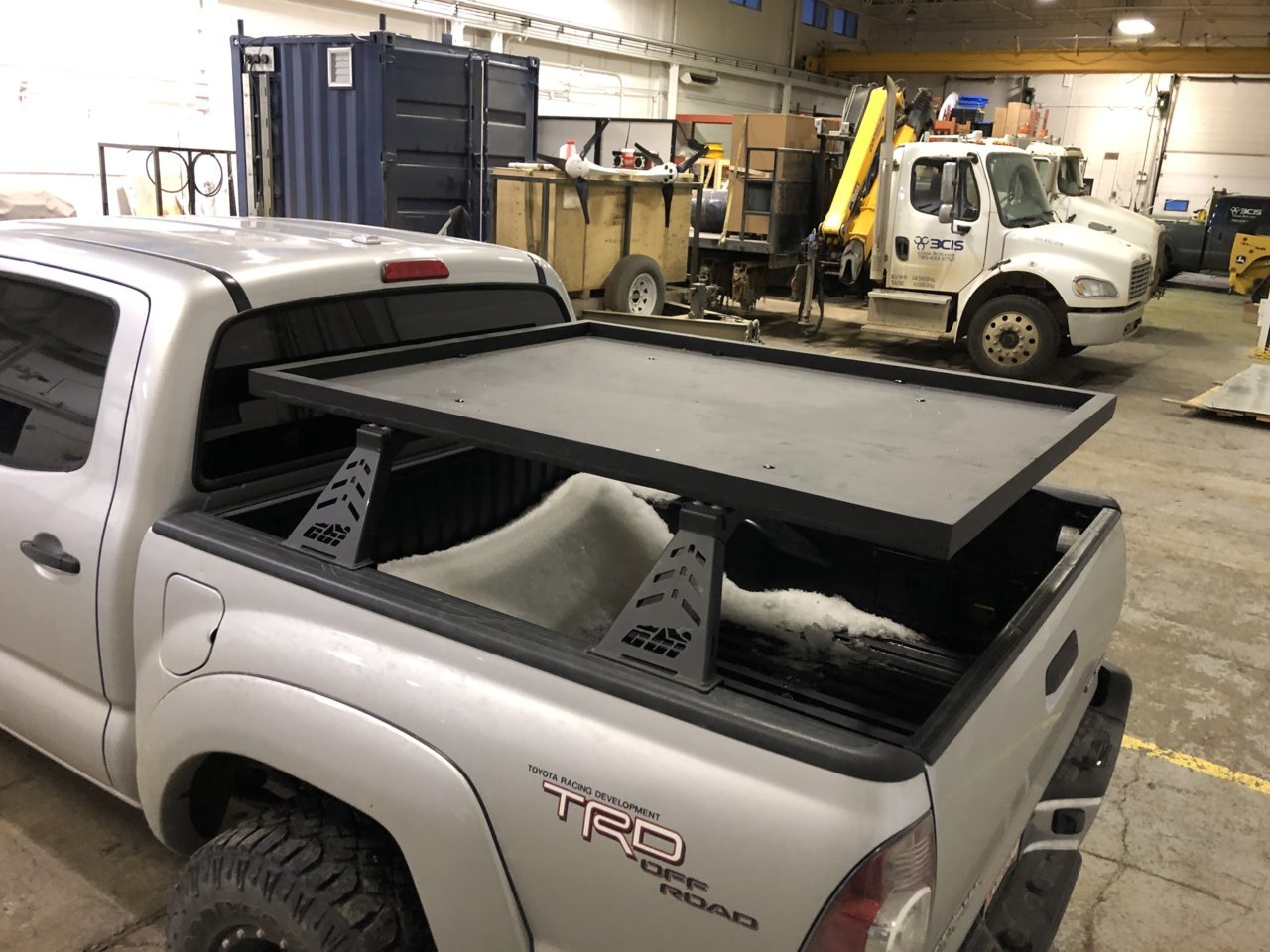

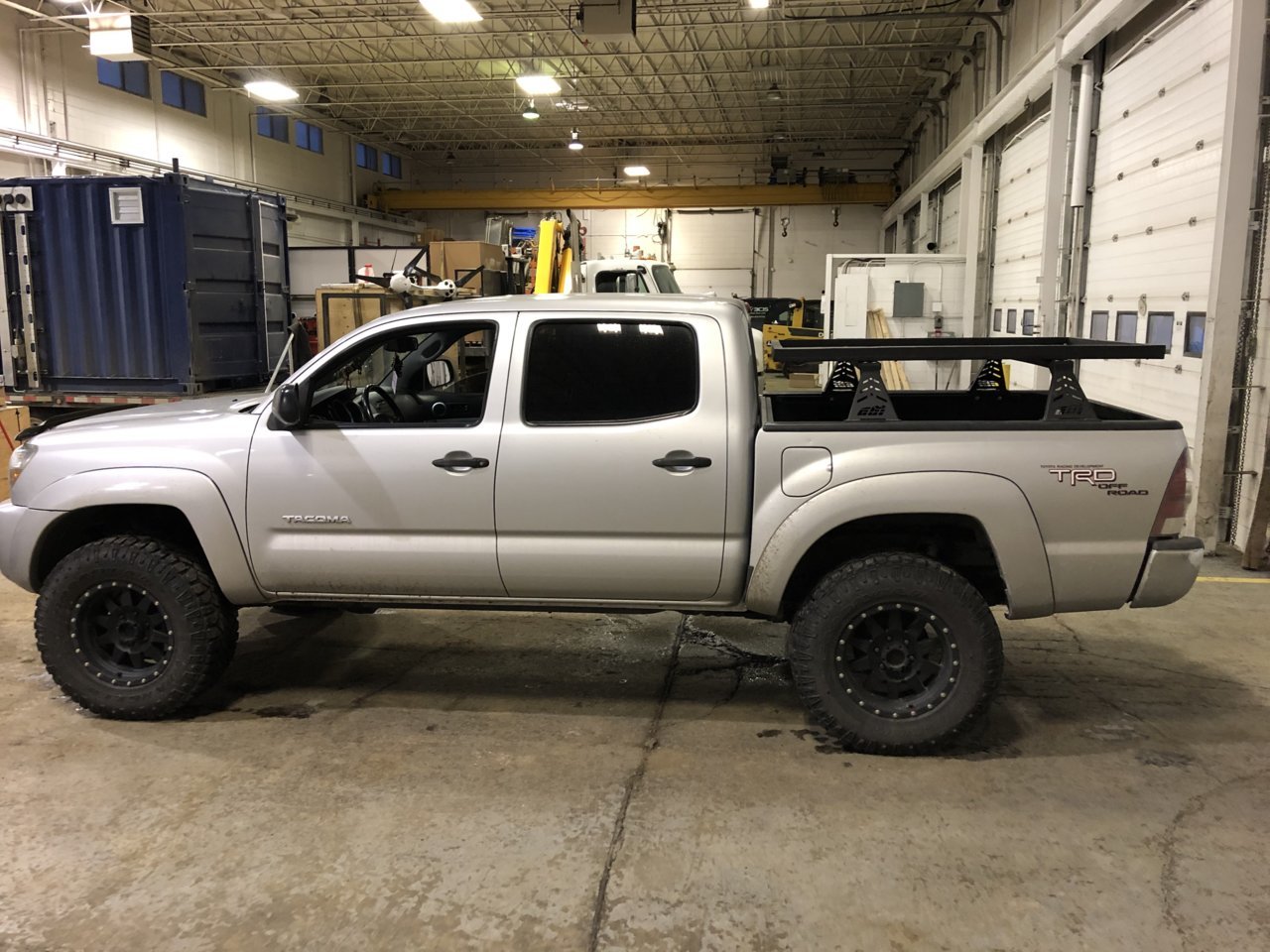

    Hard to fit everything in a 5' box when going skiing in the mountains with 4 people in a taco.
    So I built a little rack out of wood to but stuff on. It has a bunch of tie-down points.

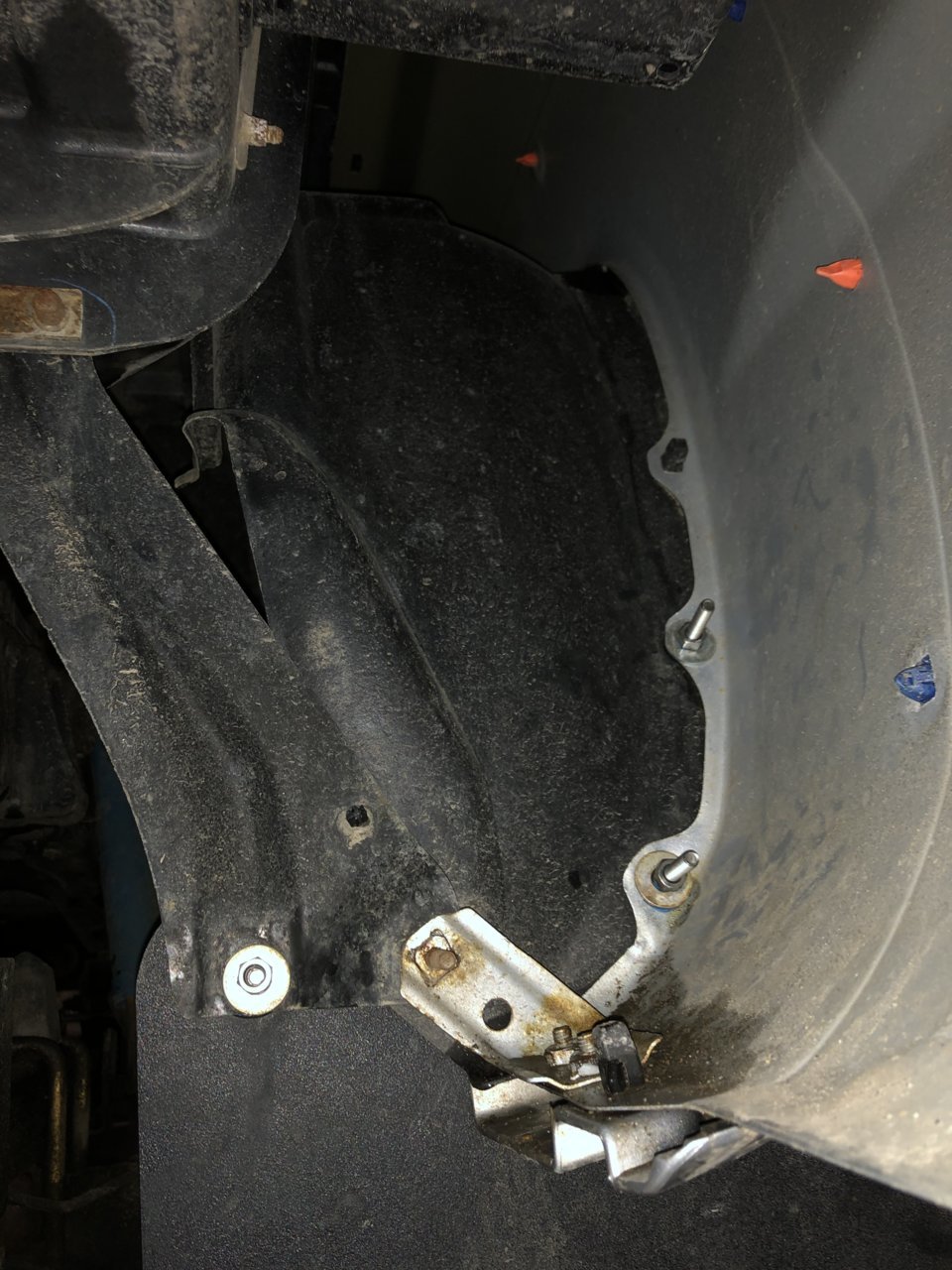

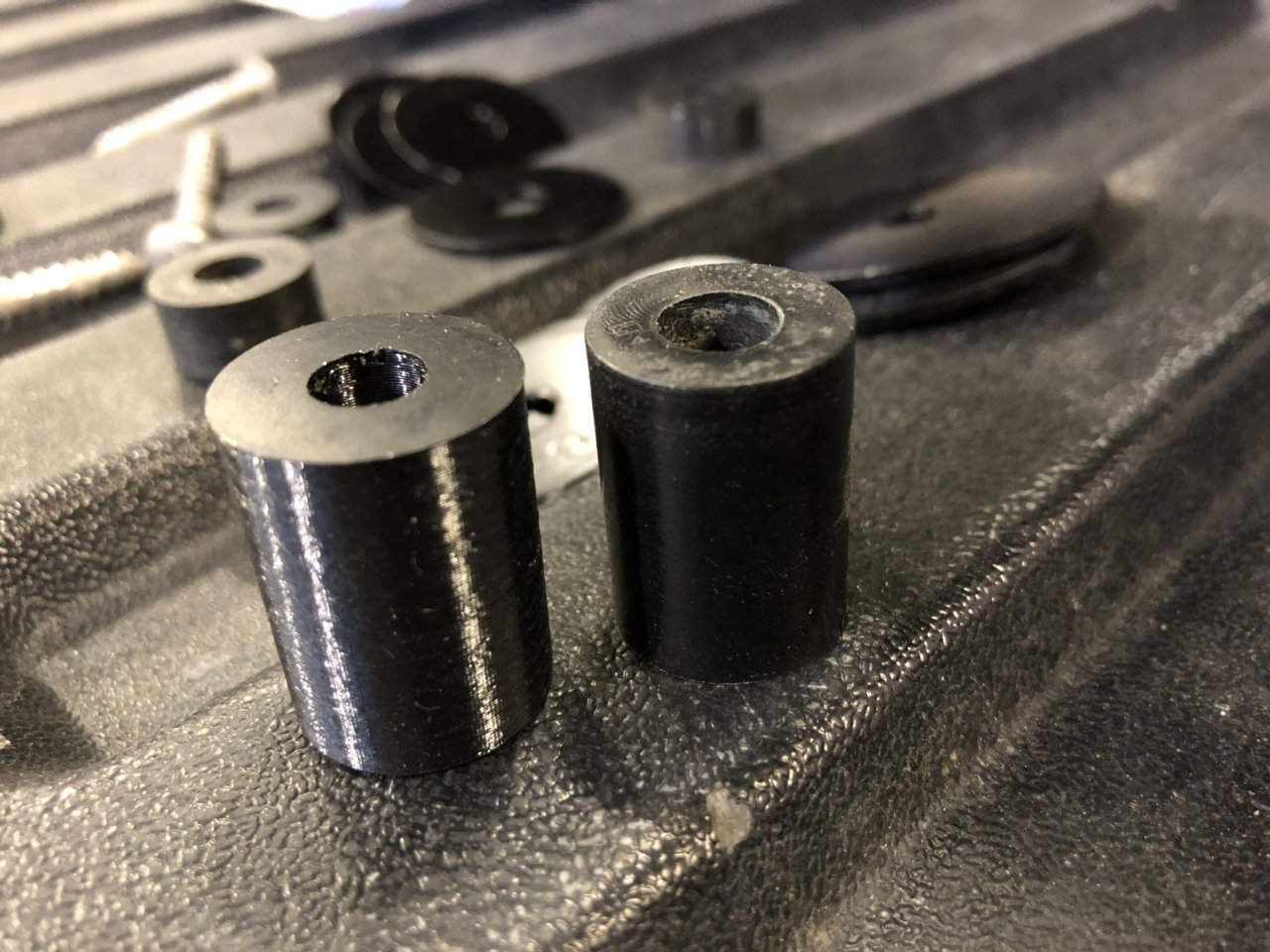

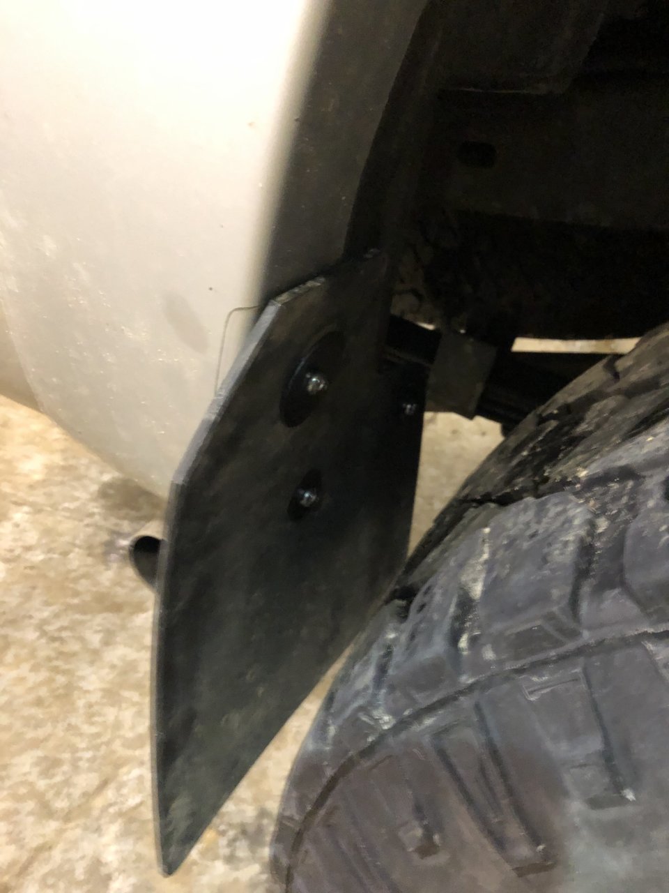

    Re-installed my Rokblokz mud flaps after ripping them off...
    These flaps are great but they screw into the factory plugs. Makes a very easy install but not any stronger.
    So I bolted the :censored: straight through with SS bolts.
    You can see the 3 new SS bolts and the factory plug at the top.
    Since I lost the spacers after it ripped off, I 3D printed some new ones out of PETG.
    Right: Rokblokz
    Left: 3D print

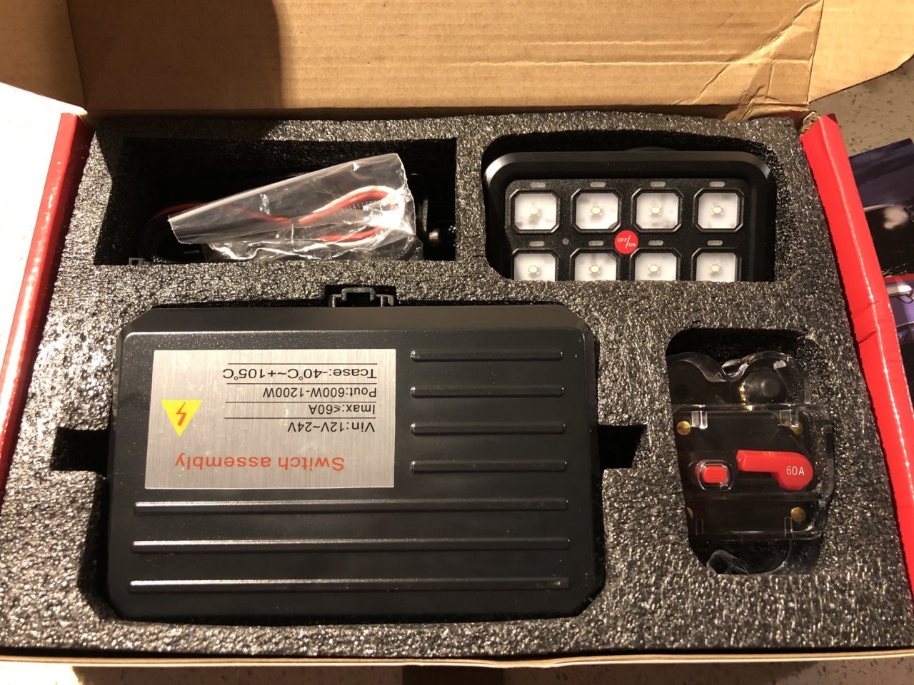

    Started my lighting project!
    Amazon / Auxbeam 8 gang switch panel system.
    Decent quality! Hopefully it holds up.
    Building my own Aux panel. Design almost complete!
    More to come!

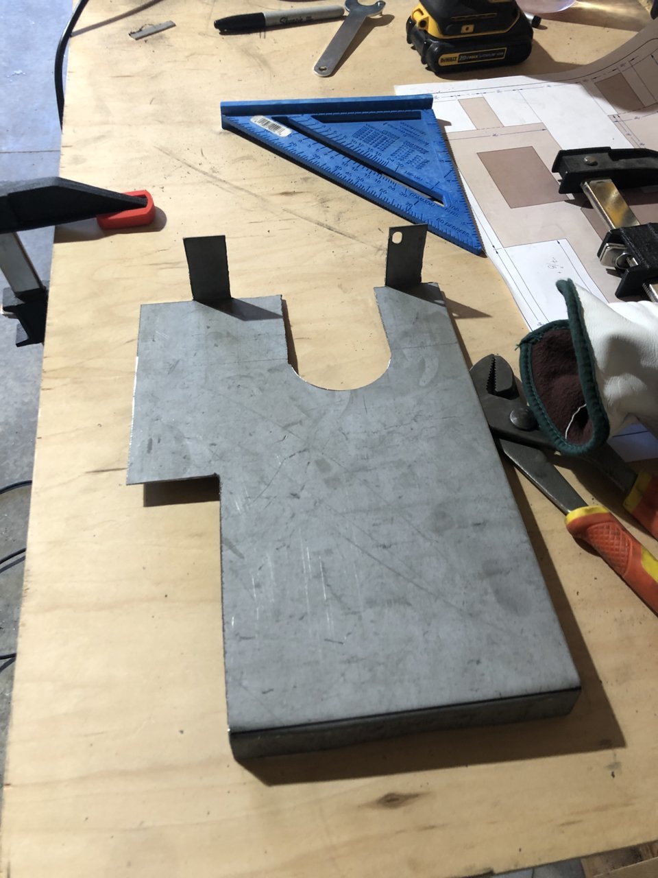

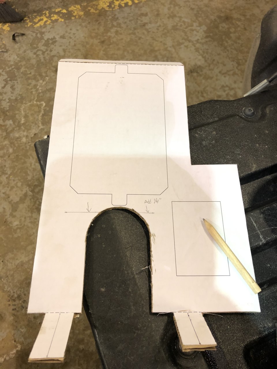

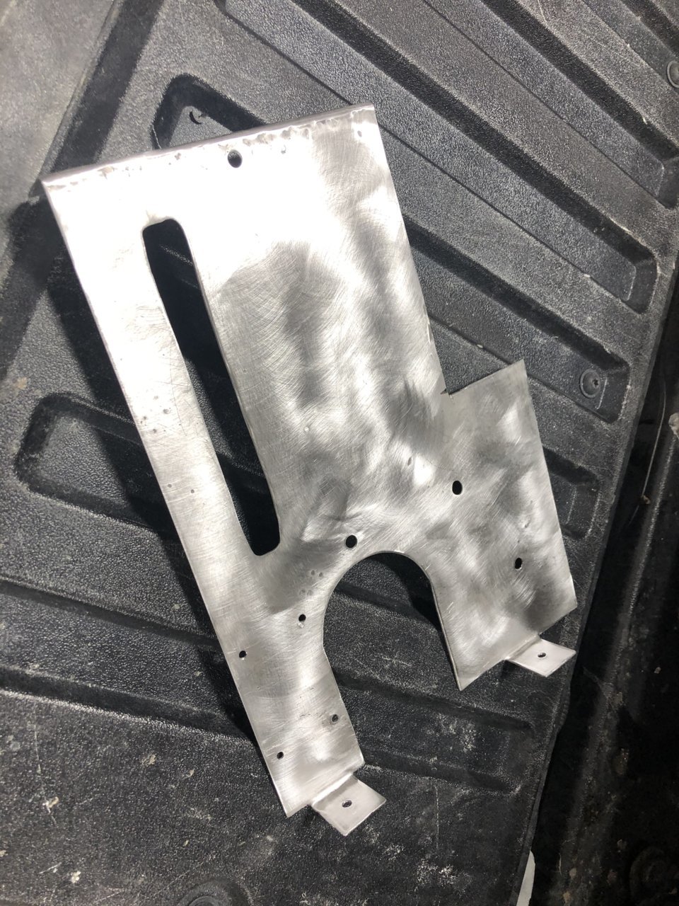

    Finished up the AUX Electrical Panel!
    I decided to fab up a panel to place everything on since having a manual, there is nowhere to use the included mount.
    Here is the panel unpainted:
    Here is everything installed in the engine bay. I added 2 bus terminals that are wired in to the 60A breaker for my other accessories that I won't be running on my Switch Board. These include bed lights (switch in box), other light bar (hidden switch by shifter), etc.
    Here is everything installed inside the truck.
    I bolted the Switch Board to the headliner. I ran the 2 wires through the pillar down into the engine bay. 1 wire is for running the Switch Board, the other wire is for dimming the Switch Board. The dimmer is a momentary push button. The mount that the 8 gang Switch Board attaches to was included in the package. But I did make the mount for the push button.
    Here is the Switch Board when the ignition is on. Keep in mind I don't have any of the sticker/labels on, so the lights won't be as bright. There are 5 brightness levels.

    I needed to buy/add some items that weren't included in the AUX controller package. I can't complain with the price of the controller.
    Here are the items I added/needed:
    - momentary push button
    - 18 AWG wire
    - shrink tubes
    - shelf-soldering shrink tubes
    - terminal connectors
    Overall I am very satisfied with the product. The instructions that came with the package is useless, therefore you need to have some slight knowledge in automotive wiring. I am a rookie at this and I did just fine. The price is much cheaper than something like Switch-Pros or sPOD. Yes this system is not as fancy but it works for me.
    I can't wait to wire up some lights and accessories to this system!
