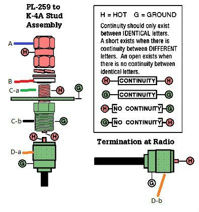

    Radioreference.com forums are great for troubleshooting things as well. Have you tried a continuity test between the end of the coax that enters the radio (ground & signal) and where it connects to the antenna (ground & signal)? If that checks out, the cable is fine (also check continuity between the ground/shield and the signal wire, there should be no reading at all).
    Also try a cont test on the antenna and mount. Here's an image I found. Hope it helps!!

    Thanks. I'll try and check this tomorrow after work
