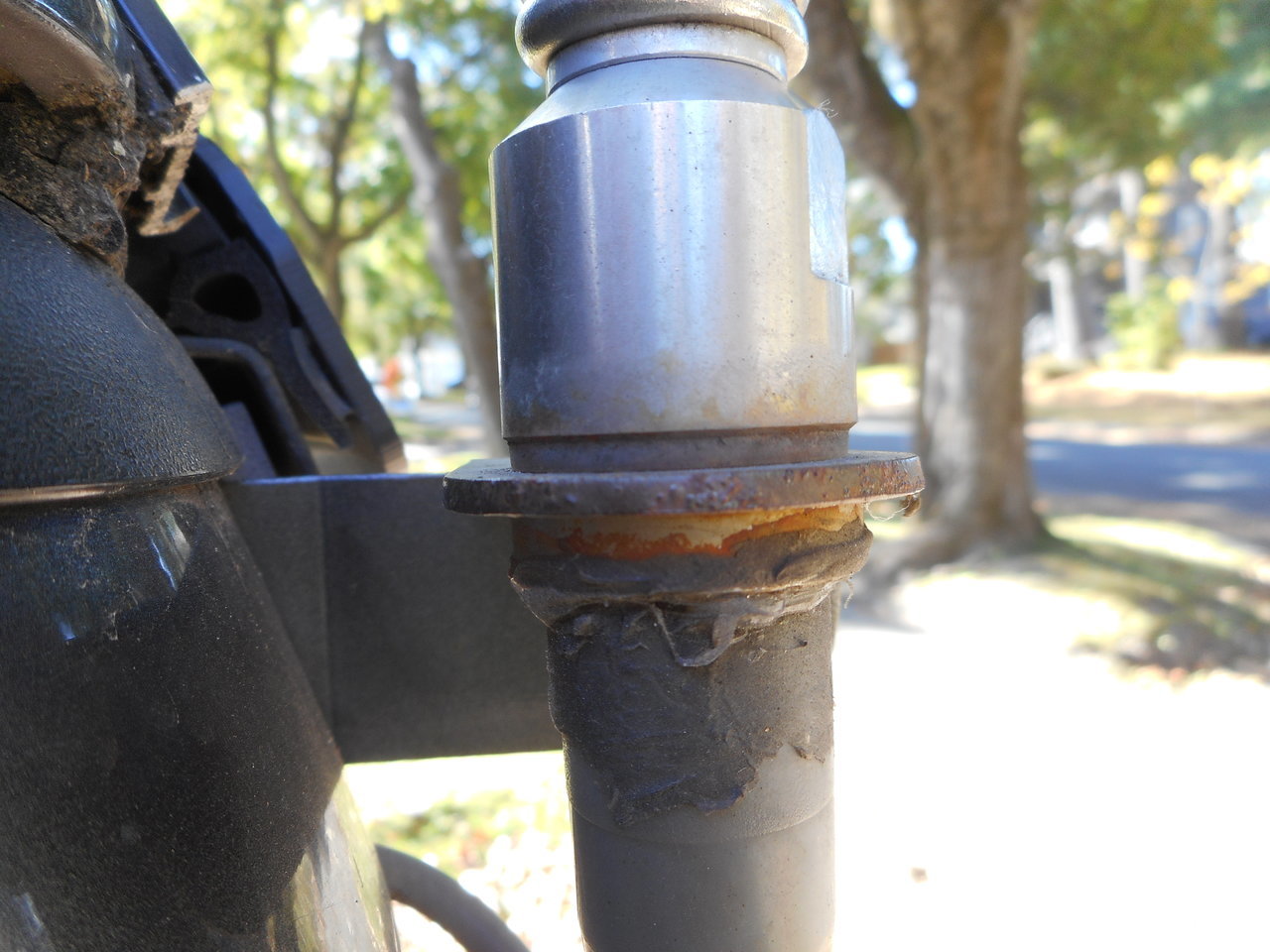

    Here is what your mount should look like... should have the plastic insulator on top of the mounting surface. also with that mount, there is a plastic insulator on the socket screw that comes in from the bottom. last thing to remember is if your surface on the bottom has paint, or powder coat on it, you'll need to sand that away to get a good ground.
