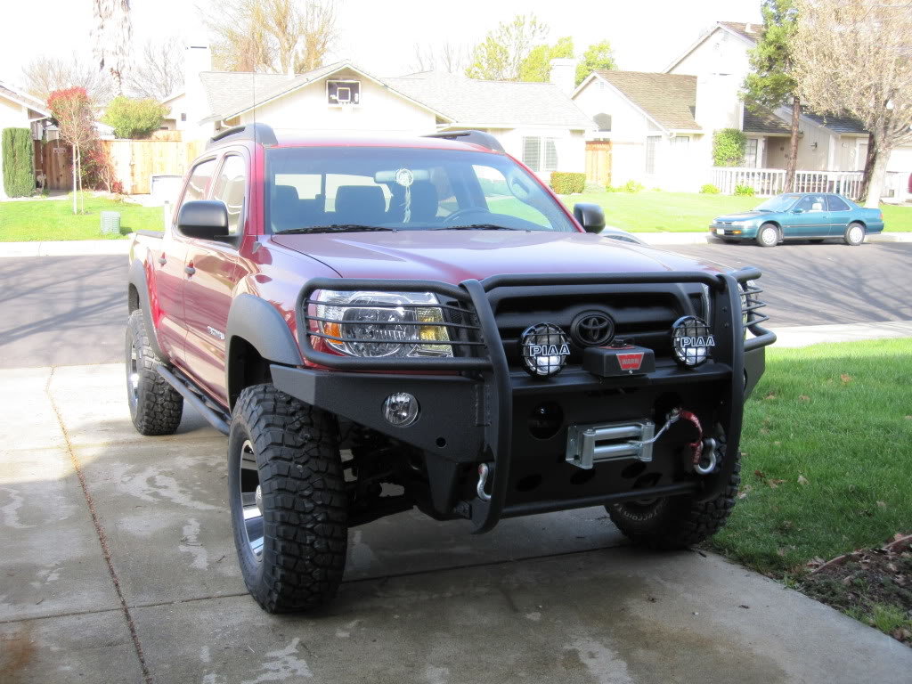

    Well, I started with a stock, 2007 Double Cab, 4X4, SR5 with the optional mechanical limited slip rear differential.
    It didnt' stay stock for long . . . and mods began:
    First, Redline hood struts (highly recommend) . . . huge difference. With all the times I've opened the hood . . . BIG time saver.

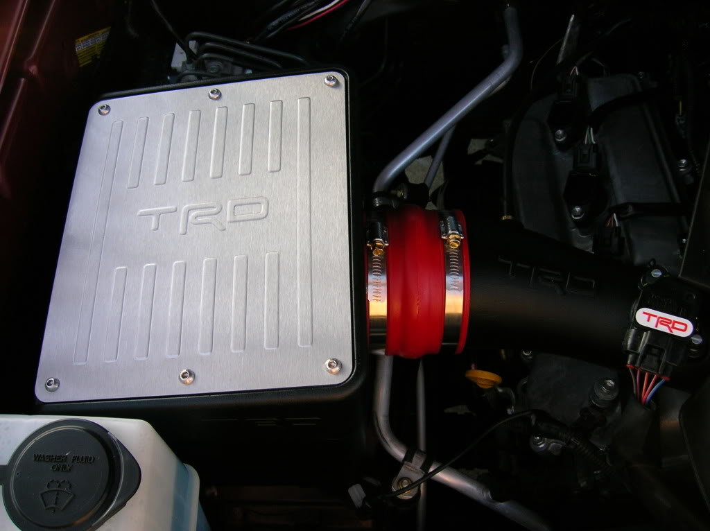

    Then, TRD Cold air intake, and new exhaust (Magnoflow muffler and stainless steel tip). I did all the work and welding.

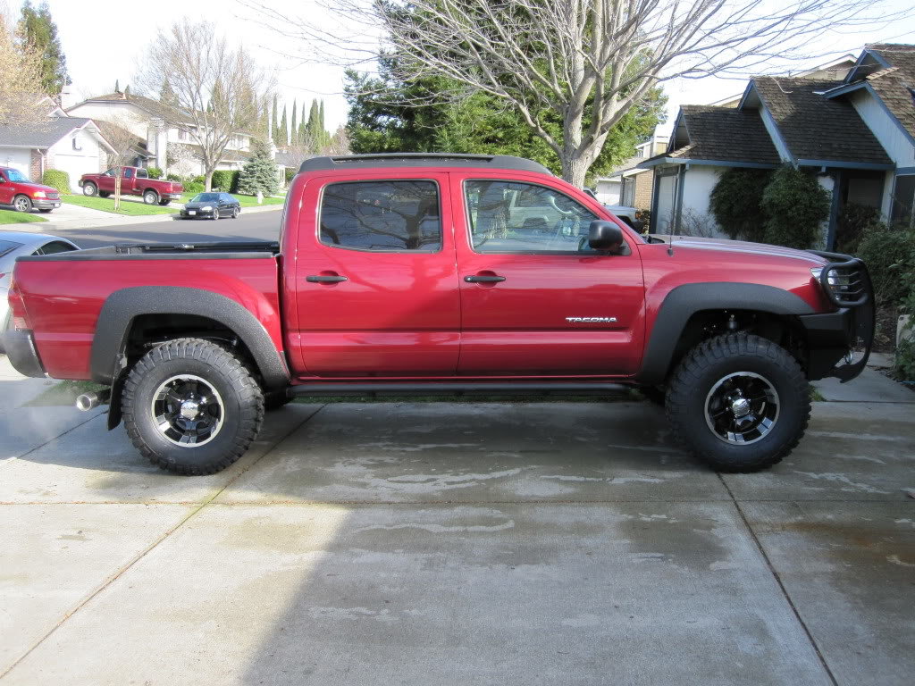

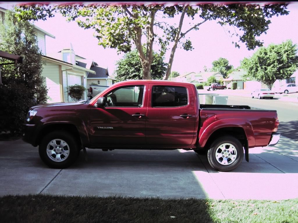

    HOW SHE SITS NOW
    BEFORE (STOCK)

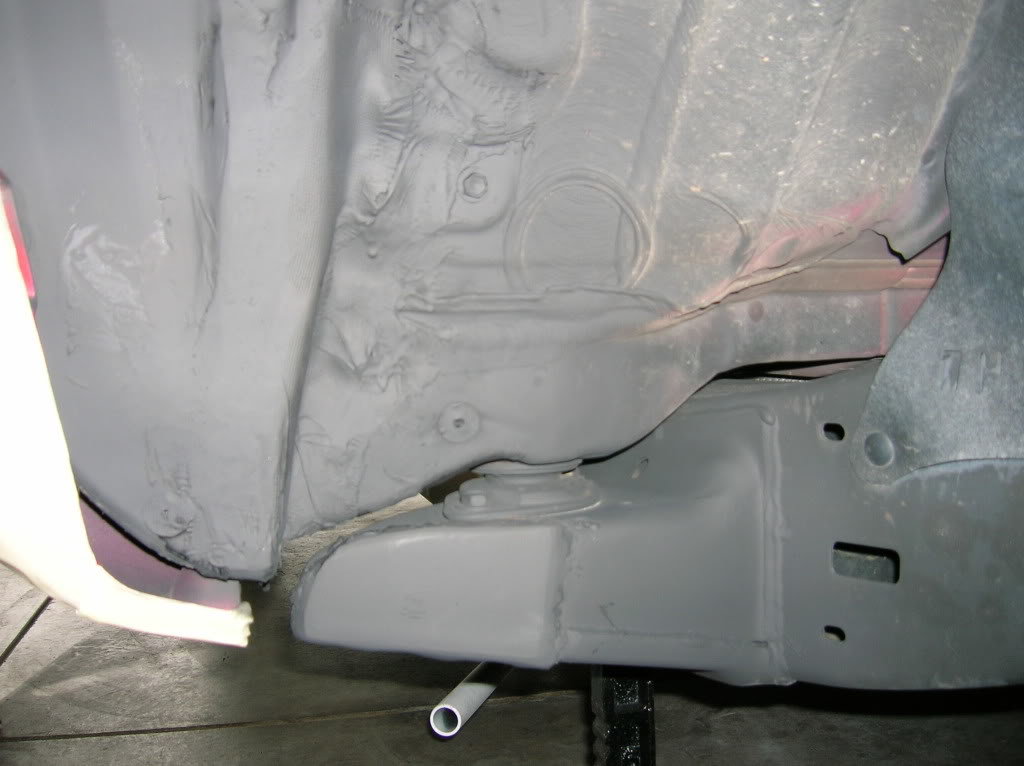

    5. Custom recovery points in rear attached to frame/tow package

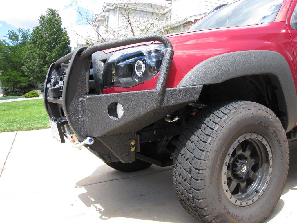

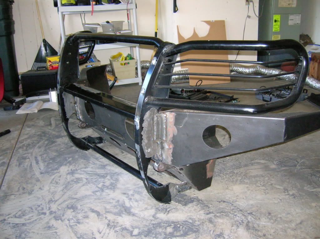

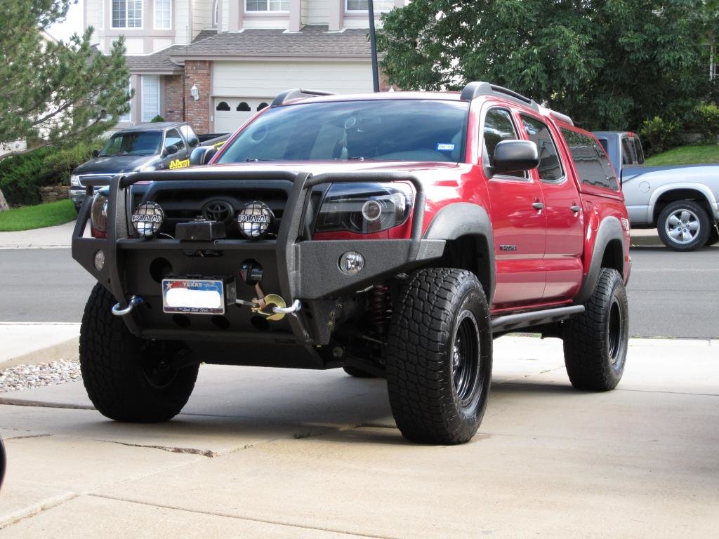

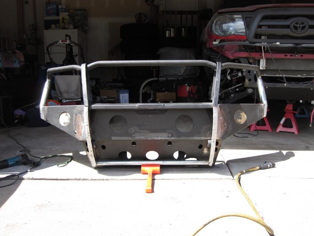

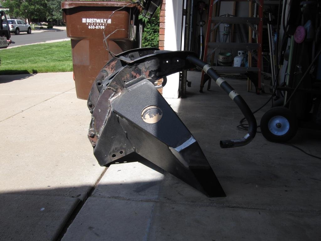

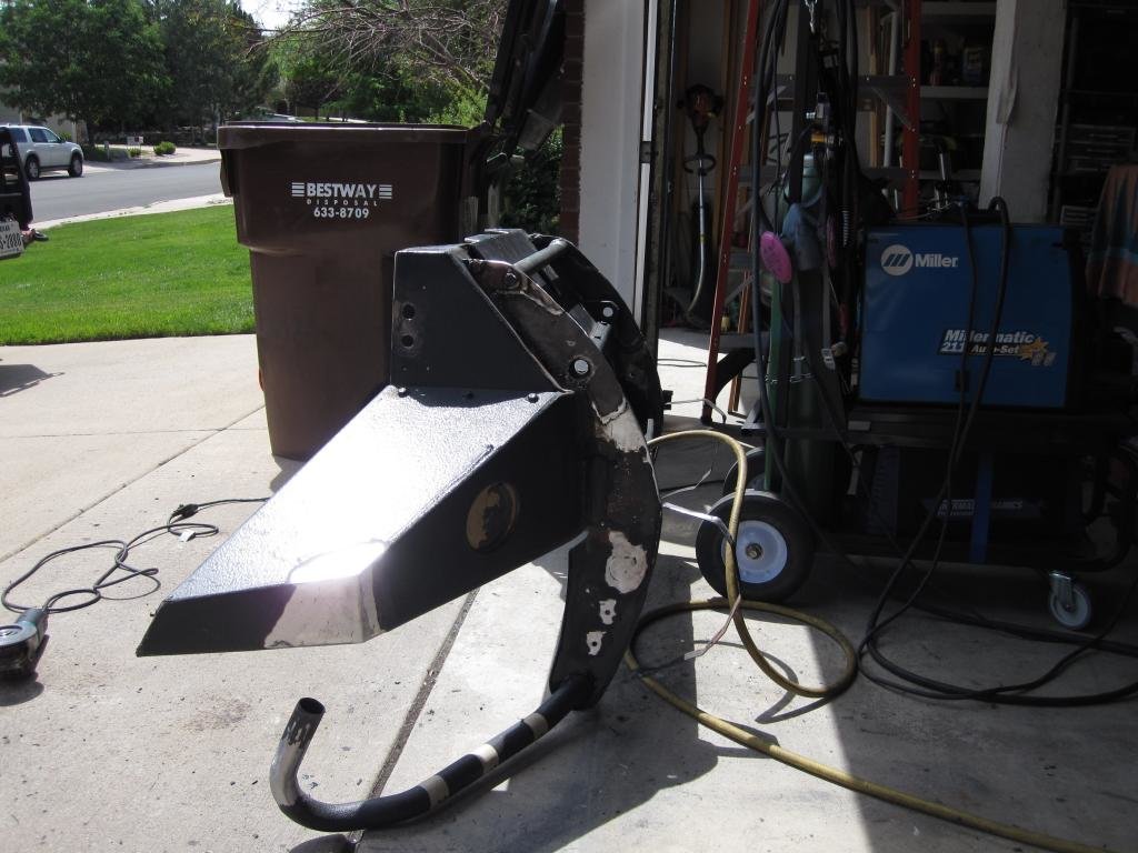

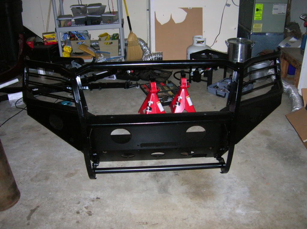

    Bumper before Rhino Lining:
    Later bumper mod to eliminate gap/improve angles:

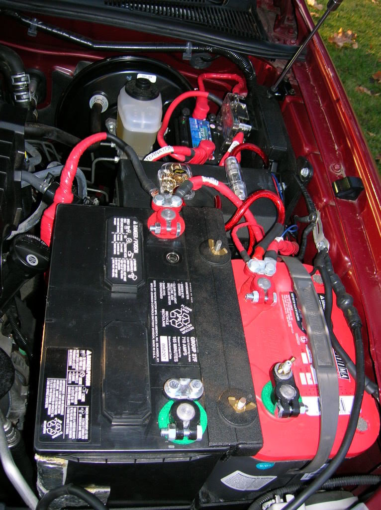

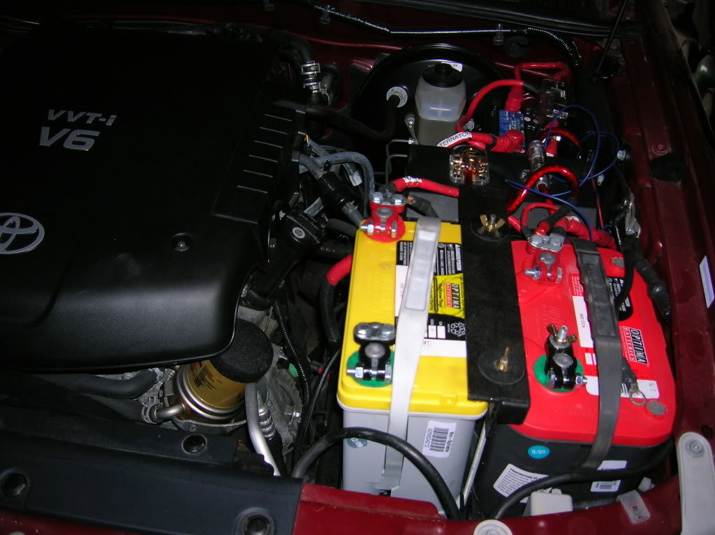

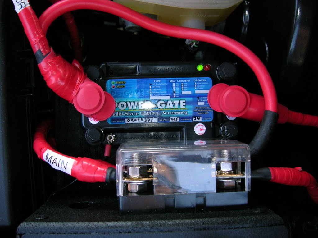

    Then, on with the dual battery install:
  7. Dec 7, 2009 at 9:16 PM
    Dr. Sleep
    Dr. Sleep [OP] Well-Known Member
    May 8, 2009
    #16977
    320
    Shane
    Colorado
    07 DoubleCab SR5 4X4
    Power-Gate Single Rectifier:

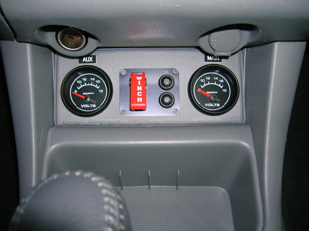

    Battery Gauges and Winch controller:

    Awesome! Cant wait to see pics of the bumper on your vehicle!

    yah, lets see the bumper on the truck!
    i've never even thought of that before

    Dual batteries modified for more room between batteries and oil filler neck. Went with a less wide Optima for 2nd battery.DSCN1036_9a384a624ff5a37c0b2296aa4db175d575ef321d.jpg

    man that guard looks awesome.. i have the same color truck and am about to purchase the guard.. wish i could mod it like yours, looking forward to seeing in on your truck

    badass truck man!!! really liking the hybrid bumper/brushguard setup!!
