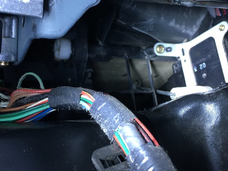

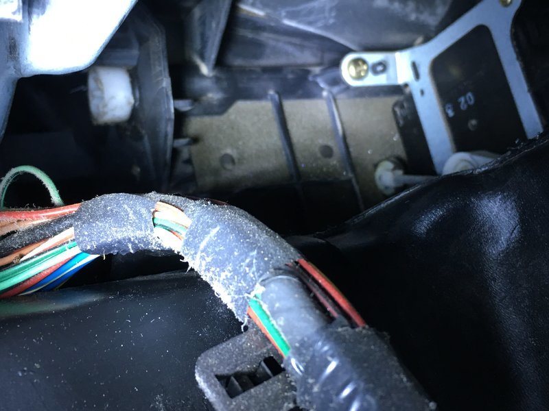

    Unfortunately I don't have one with the sheet of carpet covered plywood I have back there.
    So today I removed the seat, glove box, and surrounding bracketry and we went for a ride. The draft seems to be coming from the vent door that isn't sealing as well as it should. Short of disassembling the whole dash how does one get in there to replace that door with foam rubber surface?

    Update: My local Toyota dealer quoted a price of $650 for the assembly that includes the damper door. :eek:
    I believe I will be removing the assembly to see if I can re-glue some foam rubber onto the surface. Does anyone have instructions of how to remove the dashboard without detonating the air bag?

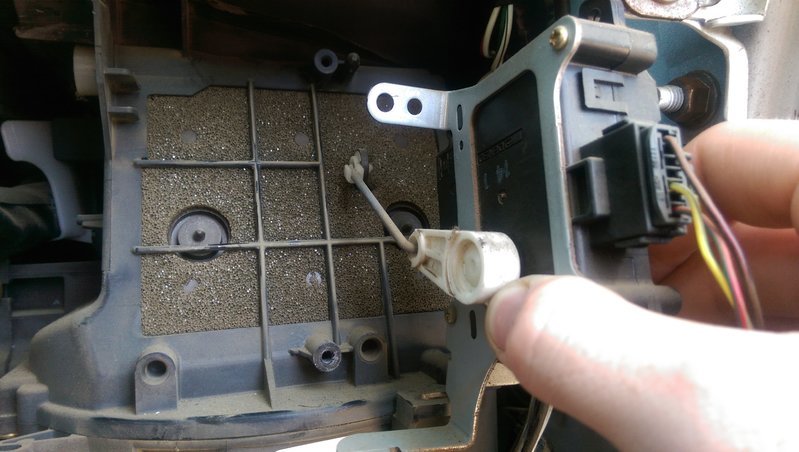

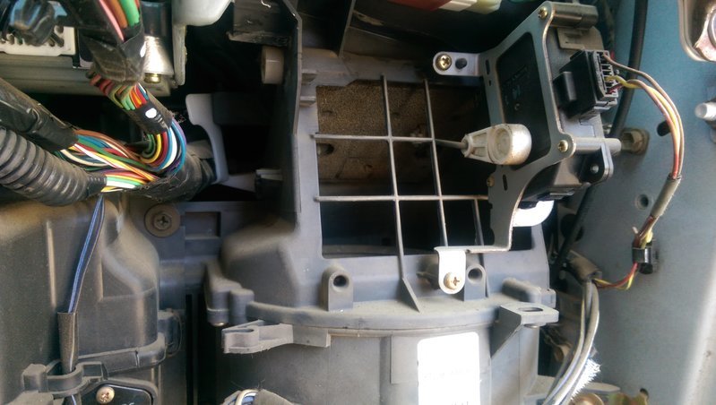

    No sure where the flapper door is, my truck is gutted for a cage I'm building if you know-ish where it is I can try to get some pics for you so you'll know where to go
  14. Nov 7, 2016 at 1:10 PM

    Many thanks for the offer. From inside the cab it is on the upper RH firewall section. Behind and above the level of the glove box. You should be able to see that unique bracket and vertical grill slats as pictured above.

    Looks like a small actuator on the right, the little white arm, maybe that's broken?
  17. Nov 7, 2016 at 1:36 PM
    #37

    Yes, that is the culprit. My motor and pull rod are working correctly but it seems the foam rubber has dried out and allow air to blow by the closed door. How much effort to disassemble the dash to access it? I would like to disassemble to the point I can apply some new seal to the flapper door.
    Many thanks for the info and photos!!
