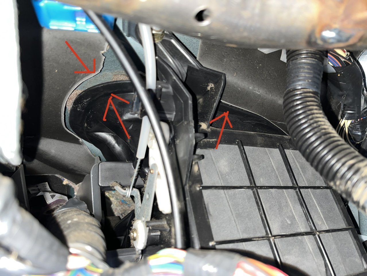

    I have solved this problem, after looking everywhere this was the thread that sounded identical to my situation. I have a 98 Tacoma. The problem is not necessarily with the foam on the fresh air vent door. It is the plastic housing that holds the fresh air vent. It’s where the plastic housing meets the body. There are foam that has deteriorated up there. That’s the foam that you see blowing out of your vents.
    The fix: Drop your blower at the very bottom, three screws, they are a weird star bit but also have a hex on them, I think 8MM but can’t really remember. Open your fresh air vent reach your arm up through it and you will feel where the plastic meets the body that needs to be filled with something. I used spray foam insulation onto a latex glove and smeared it around so it would expand. If I had to do it over again I would probably would have used caulk and not used gloves so I could get a better feel of what I was doing. You can’t see what you’re doing, you have to just fill of where to smear it. The foam I used turned out well, but it is a sticky mess and if you get it on anything it will not come off. Make sure you get a flashlight and look up inside of there and make sure you don’t get any on the vent door so it can still open and close properly. I will post pictures shortly.

    gta3214 Well-Known Member
    Sep 14, 2014
    #138280
    94
    That is where the plastic housing meet the body at the red arrows, make sure you go all the way around with whatever you use to seal it

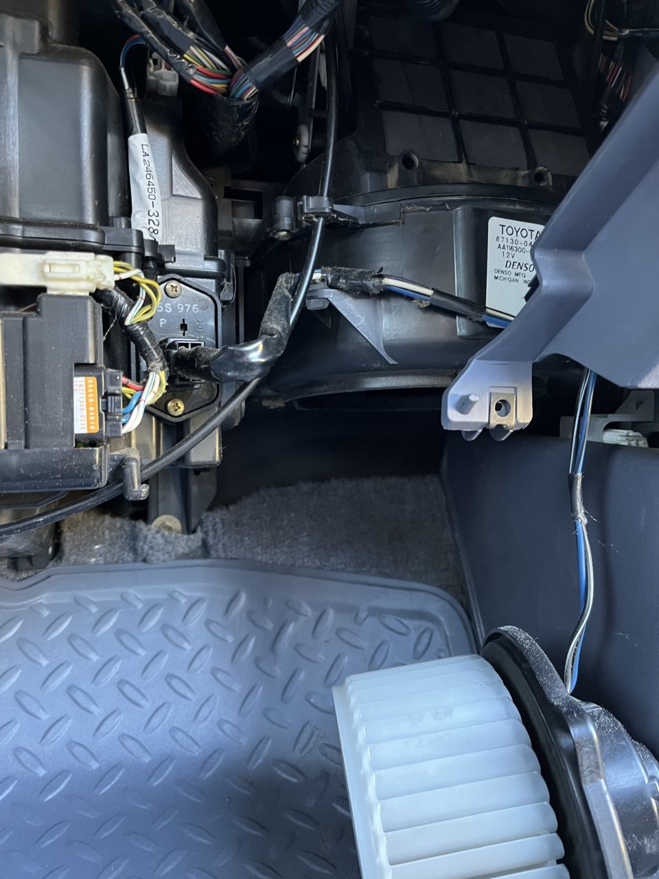

    Sep 14, 2014
    #138280
    94
    This is the blower dropped, run your arm up through there with fresh air door open. I removed my glove box but it isn’t necessary.
