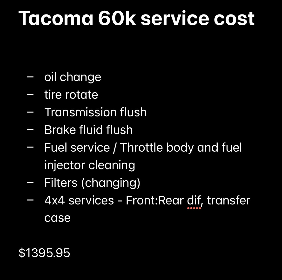

    This is the cost for the entire service they are trying to sell me on.
    I’m prob just going to have an actual reputable transmission shop drain and fill for me. May just have them do it all, this price seems too high.

    Or save over a grand by doing it yourself on a Saturday if you've got basic mechanical skills.

    Only thing on the list that makes me even a little nervous is the tranny. Some people say don’t even drain and fill. Idk how in 2022 there is still so much conflicting information on tranny services lol.

    Curious what the whole fuel injection cleaning involves; a can of fuel additive? On injectors that clean themselves?

    That is Mercedes-priced maintenance right there! I wouldn't spend that much to maintain my Tacoma. Not even on a Mercedes. But I like doing this stuff myself. I find it relaxing (I just serviced the fancy Airmatic suspension on my wife's GL450, and saved about $3,000).
