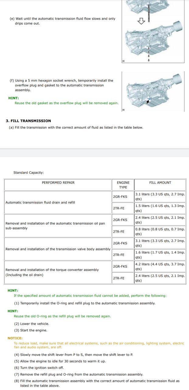

    You will need 6 qts of the tranny fluid for this operation.

    how much atf do you need for a drain and fill? i'm planning on doing one drain and fill every 15k miles.

    What you want to plan for is having 4 quarts on hand. About 3 quarts should drain out, so you need to replace more than that so you have an overage by which to observe the draining fluid slow to a trickle. If you drop the pan, plan on 5 quarts on hand. Just replace a 1/3 to 1/2 a quart more than what the chart above quotes is the drained amount. Don’t go by what actually drained, it may not have been full.

    oh wow. one 5 quart jug is enough for 3 drain/fills with the 2.7L. nice.

    Maybe I shoulda done my math better. But 2.4 extra quarts to come out just from dropping the pan after draining it? Maybe that includes pulling the screen. But I recall only draining a total of 4.5 quarts when I dropped the pan.
    No harm in having extra tranny fluid around though.

    Yah, they all seem to be a little different.
    I got another 1/2 qt out when I changed my filter, so that's part of it too.
    And if someone is going to drop the pan, then it's very easy, and 5 extra minutes, to also change the filter while they're in there.
