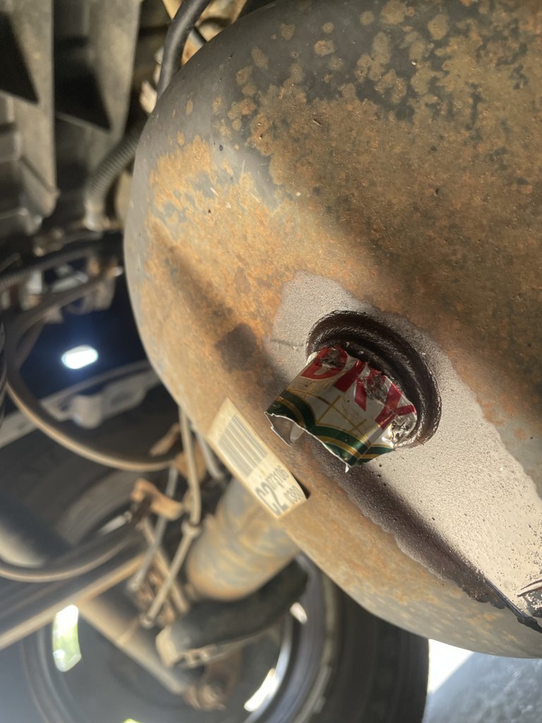

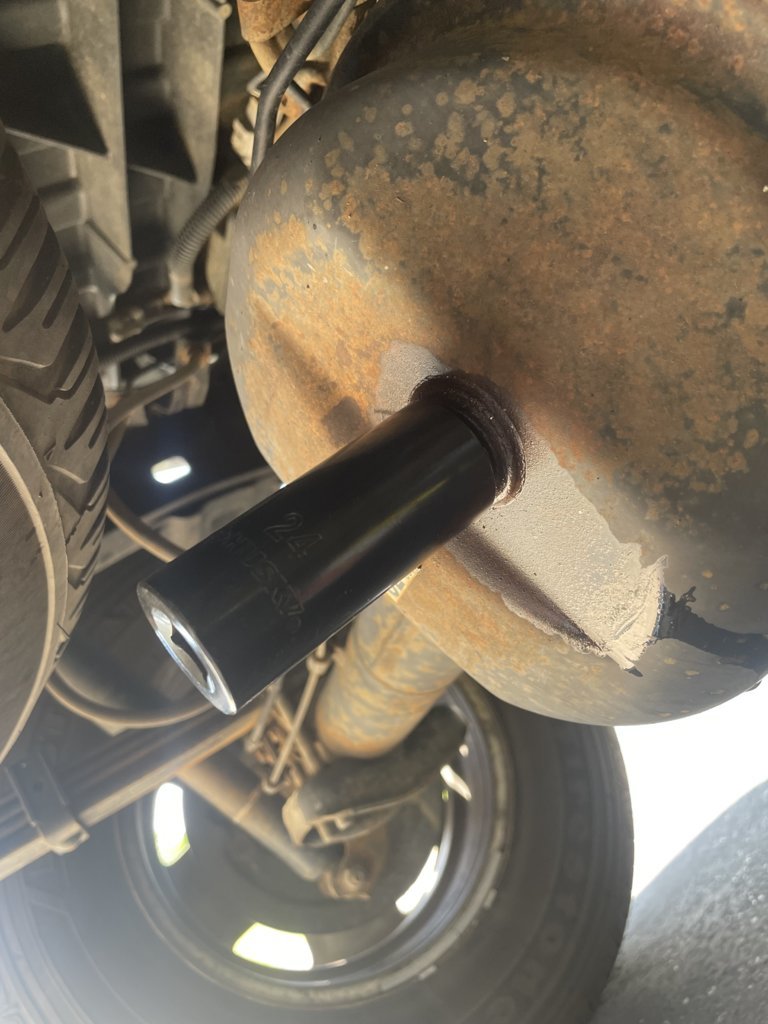

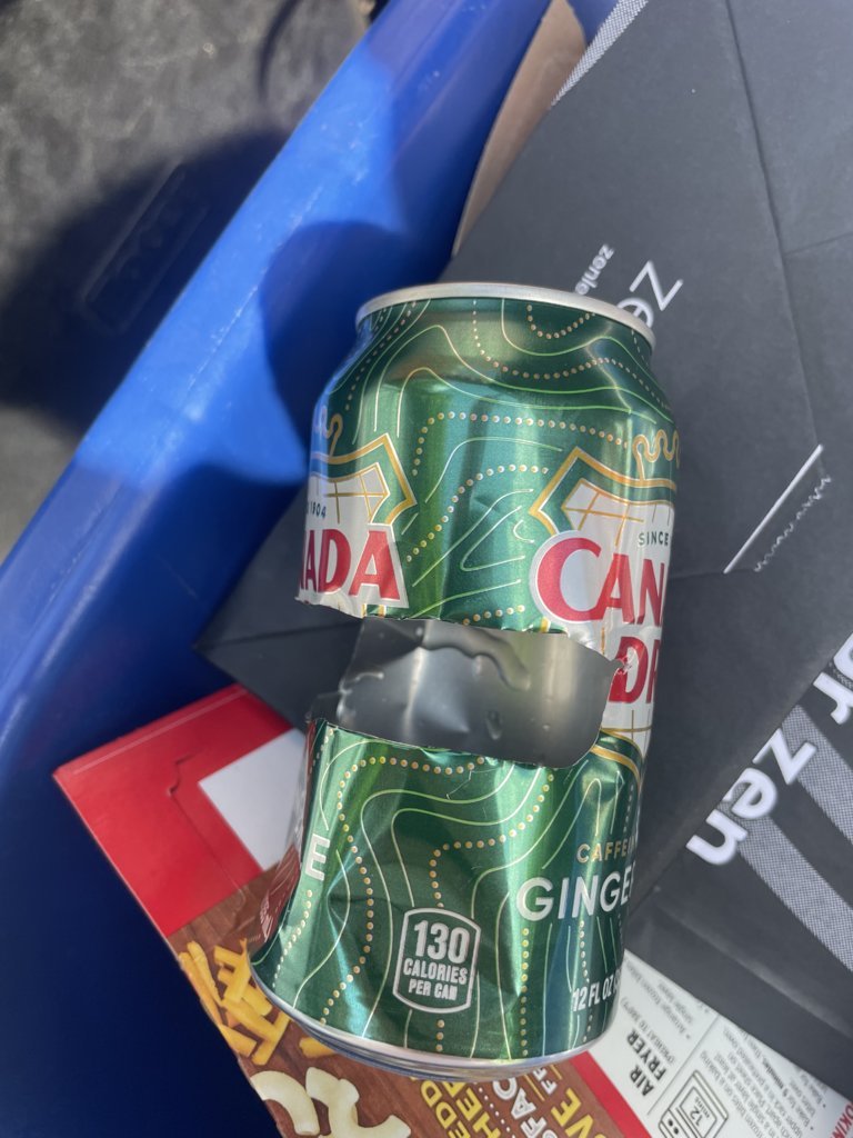

    I’ve posted this before but this is what I had to do, cut a slice, wrap it, and tap it on with a deep socket. I know, I’m terrible, lol

    OMG great effin idea!
