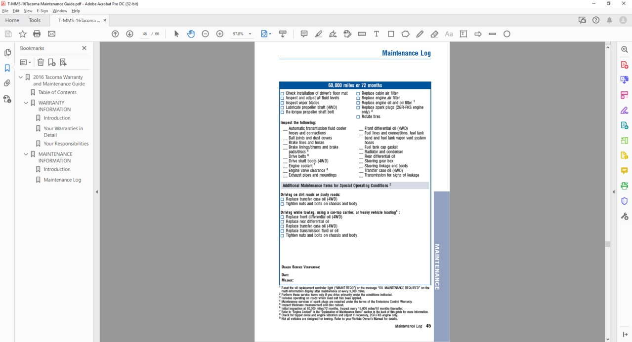

    have over 87k on mine and runs fine, hasn't been changed yet and the maintenance manual does not state Replace at 25k, even at 60k it is only replaced if special conditions occur.
