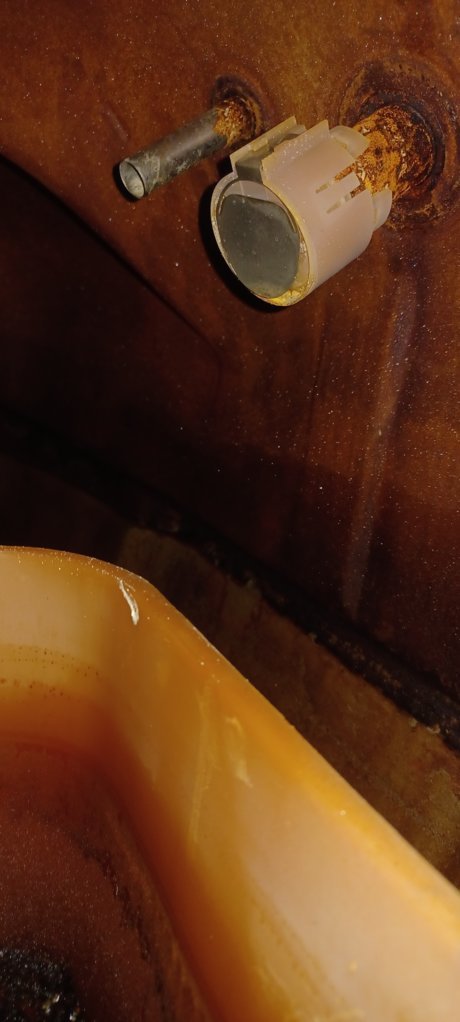

    This is a Pic of the inside of the 18.5 gallon gas tank. That flapper cover on the end of the fill tube messed with me when I tried to put a siphon in there to get old gas out. Hence me pulling the tank while troubleshooting a tacoma that had very old gas in it. My 2 cents.
    I have pics of all my Tacoma repair adventures. It needed a cleaning and got a new fuel pump and sock.

    It looks pretty simple, but it seems like the picture you shared doesn’t have the same removable plate. I don’t know what mine has.

    IIRC, I could push it thru with some force but I could not get at the bulk of the fuel. ( to the good spot on the bottom in a low area of the tank ) I had a half of tank of gas and siphoned some but I think I was fighting with the tub that surrounds the foot print of the hanger assembly. And when I was yanking out the hose I knew something wasn't cooperating and i didnt want to break it. Yeah if you don't need to drop tank. I understand, I'm a common sense guy also but as you can see from pics my tank was bad and I didn't want that crap in my newly installed engine. Whatever works for you is best. Cheers

    If thats the inside of the tank I wouldn't even bother and replace the tank.

    Whatever, if you want to spend an arm and a leg or get a aftermarket tank. Mine polished up beautiful with dawn dish soap and a pressure washer but to each his own.

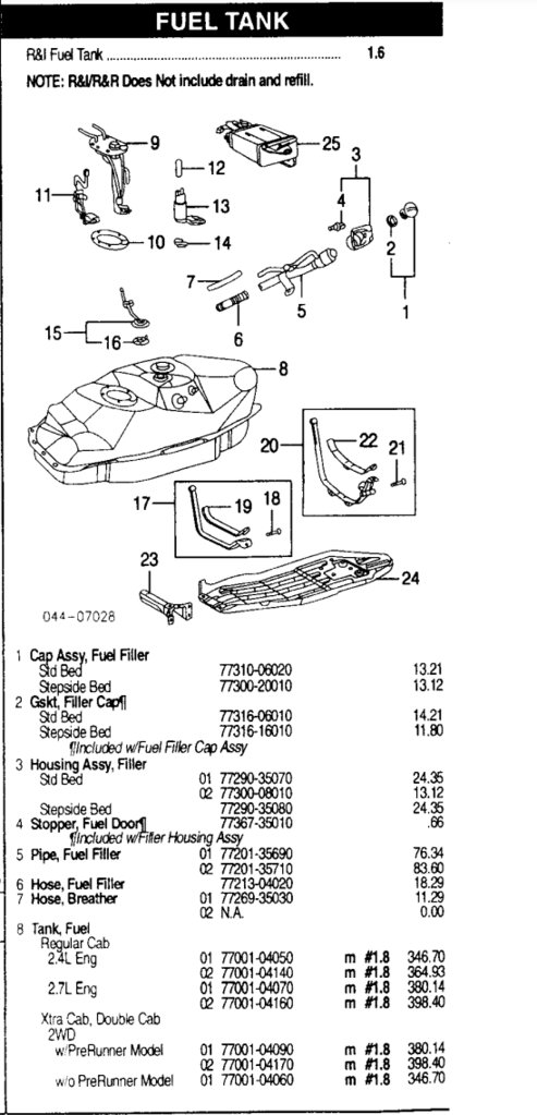

    Do you by chance have the part# for the filler neck tube that goes with your VIN
    I am very curious if my 97 is the same part with that little screen at the end inside the tank

    I didn't replace anything on mine but the fuel pump and sock. So no sir. Sorry. I have the 2001 FSM but it does not have part numbers.

    2001-2002 Parts List
