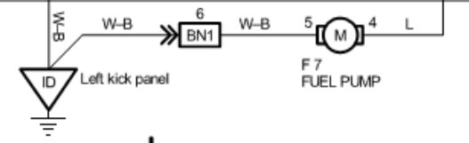

    Nice.
    Even easier.
    This should make it "easier" for OP.
    No guessing.
    Blue pin is power.
    White/Black pin is Ground
    Thunderbucket2000[OP] likes this.

    Yup, and the two relevant pins on the top of the tank are bigger for the pump and on the opposite side from the 3 smaller pins for the level and low fuel senders
