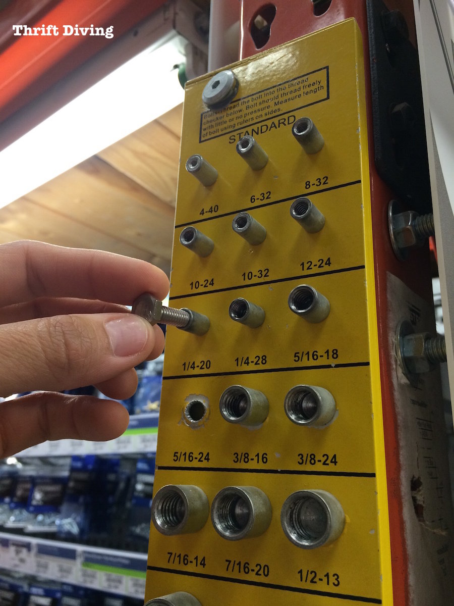

    Its simple question that i could not find answer too.
    What is size/ thread designation for manual transmission fill plug and drain plug?
    Like M18-1.5 or something like that...
    What is size/ thread designation for rear differential fill plug?
    I have 2013 5 lug.

    Will i have to buy fill plugs and use thread checker ? Somebody knows...come on guy

    Should be M18x1.5. That's the size of everything except 4x4 front diff drain plugs (which you don't have, its M24x1.5 FWIW) and maybe automatics (I dunno those).
