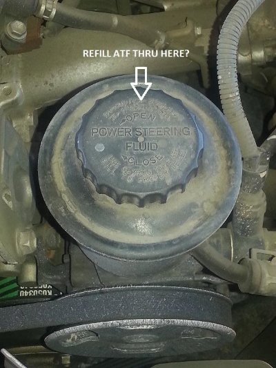

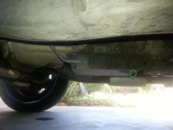

    New to this site. Wanting to drain and refill the automatic transmission fluid in my '04 tacoma (2wd). I have been able to find youtube vids & walkthroughs for the 2nd gen but not much on the 1st gen tacomas. From what I gather its a little more straight forward with the 1st gen so maybe thats why theres not as much info out there.
    Im more of a visual person so I just wanted to confirm if these were the correct drain plug and refill locations?

    Refill via your tranny dipstick hole. I know, it is small.

    When you drain, drain in to a container that had measurement marks on it so you can replace exactly how much you drained out.

    I thought the power steering was the wrong place to refill, that's why I wanted to confirm. However, I cant locate where the transmission dipstick is. All I can find is the yellow oil dipstick and the power steering.
    Anybody have a picture of the atf dipstick location on the 1st gen? Does it have a red handle?

    your filler tube is in your first picture , follow that pipe up from transmission pan to the engine compartment and you will know where to add / check transmission fluid level .

    Alright found it! Haha not sure why I was having such a hard time locating it. It's on the driver side below the brake fluid compartment. Thanks for the help guys!
