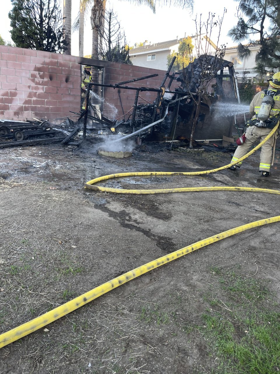

    I suppose I’ve been over thinking my 2 stroke fuel. What I’ve been doing is filling my small can with about .75 gallon, then adding the 2 stroke oil. That just about makes it for 2 cuttings 2 weeks apart. The bigger can gets about 1 gallon for the 4 stroke mower. After the second cutting, I dump what’s left in the big can in the truck. The premixed gets dumped on the weeds. Then I refill the cans. Not really an issue at this point, my shed burnt to the ground destroying everything in it.

    I appreciate it. I’m planning to put something up, probably lay a cement pad first. I couldn’t keep critters from making their home under the floor.

    Well damn. That sucks. Do you know what caused it?

    I don’t. The investigator kept asking what was in this area. A gas can, cans of premixed 2 stroke gas you buy at Home Depot. Oddly, those cans that were 95% empty were laying on the ground burnt outside with liquid still in them.
