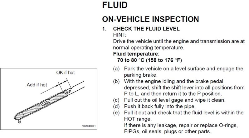

    On the atf dip stick there are three marks. I assume one is low and one is high, What's the middle mark?
    Also just want to confirm with one more person that the atf fluid is filled via the dipstick on an 2012 2.7 Tacoma. Not that I don't trust car78412.... I just want to be 100 percent sure... Today has been the day of bonehead moves and I just want to not do another.

    Not 'earlier' but the sealed unit (no dipstick) models that are behind V6s. Our transmissions are more traditional in architecture, with the bonus of a drain plug, which you already found. :D
    I'd put in whatever it takes to read full under the conditions you should have to read the dipstick properly. You don't know if it was spot on, high or low previously. I'd probably put in a little over 3 qts, then start checking and adding, repeat till it's good.
    It may take exactly what you drained............. or not.
