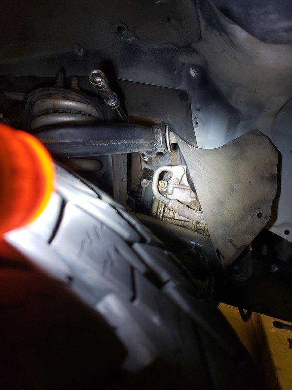

    I would drain the block as it collects junk in there that will leave though the block drain- mainly scale and grit. It’s very easy to do, you need about 2’ of extensions, a ratchet, and a 12 or 14 mm socket. You can use a catch pan or masons tub to catch it all. Good time to inspect all your other coolant hoses, especially the IACV hoses under your intake.

    I collected this pic of the location of the block drain plug here on TW a while back. (Very sorry to say I cannot credit the photographer/OP.)
