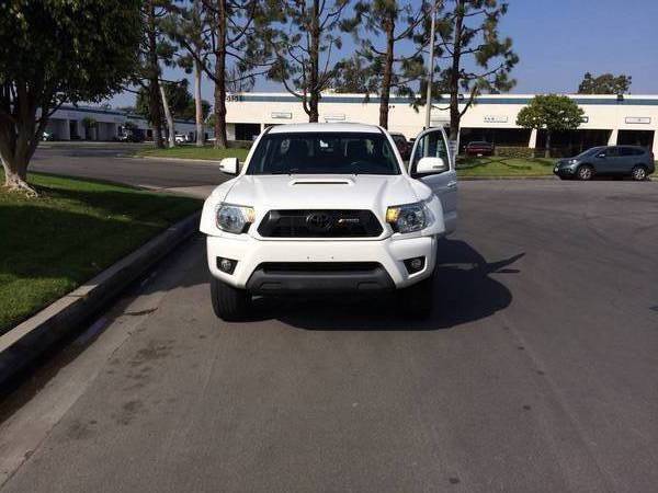

    Upside down pics ????

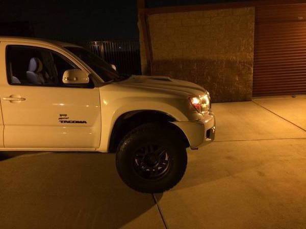

    I'll fix them, it was my stupid phone.....ok they should be corrected now. Here are a couple more finished pics. Going to look goofy until I get my front bumper in May. Also there is no suspension on the truck just yet, I definitely need a cab mount chop. I will have plenty of pics for the install process and final pics of the suspension next week, I would say either Thursday or Friday next week.

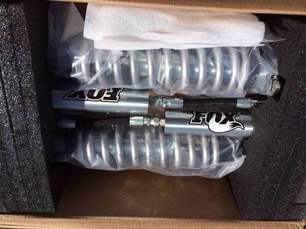

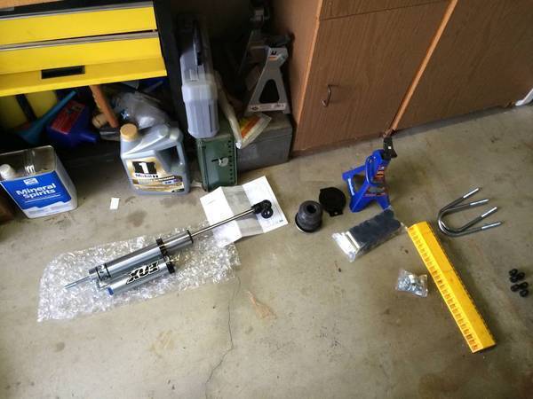

    So i finally got my coilovers. Im super excited, tomorrow the long travel is going on my truck!

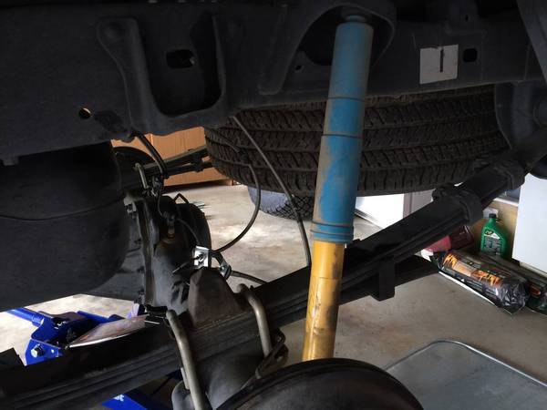

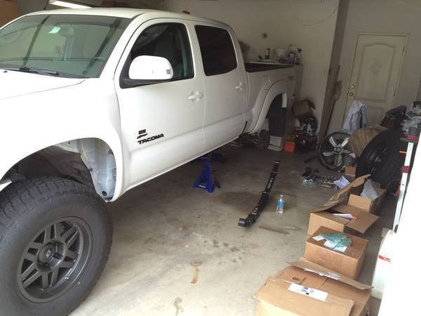

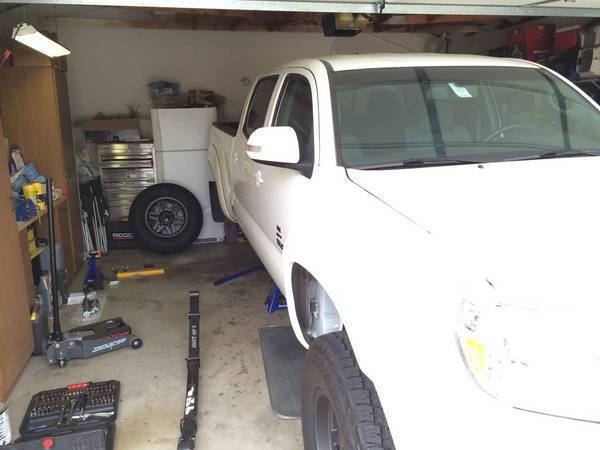

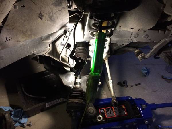

    So I hit a snag installing the suspension. Got the rear on fine, and all finished there. I am now stuck on the cv axle inner spider. I may just take it somewhere to have them do it. Here is what I did today, I will try to get more pics later. I am so tired.

    Ok, so after 3 days of problem after problem it's finally done. Unfortunately it was too late and dark when we finished so I will take pictures tomorrow. Until then, here is this picture. I'll explain a couple of the issues we had as well.

    So a little background on some issues that arose. The biggest issue we had was really the cv axles. So getting them off the truck was a pain. We had to really fight pulling it out of the hub. Then finally got it off the truck and we had issues getting the spider gear off. Finally got that off with a lot of cussing and hammer swings. Then came time for the fun part, the outter cv joint. Tried the pipe trick numerous times. Took it to a shop where they tried several things. Nothing worked. They ended up cutting the axle and pressing the end out of the cv joint. Everything went back together without a hitch. Then came time for getting the spindles back on and getting the upper control arms on.....wait what?! Oh nice the driver side control arm has no metal insert for the bushings on either side. Ok, called all pro and they had to overnight me the parts since he said he had none at the shop. Then I got them the next day and low and behold, they were for a lower control arm. So I called them back and luckily he said he had one :confused: So he must of been thinking I said lower control arm the day before. Anyways, I drove down and just swapped control arms with them. Finally got back and we started going to town putting everything back together. Then realized there were no bolts provided for the lower control arm ball joint to spinder adapter.....jesus I cant take this anymore. So we used the stock bolts, which are too long mind you, and just used spacers to torque them to spec. Ok, cool now we are good to go on that (which btw all of the bolt holes had too much powder coat and had to be dremeled out. We finally got everything back on and were finished. If I wanted to do this again, I will just pay someone to install it. I don't want to go through any of this again ever lol. Oh and btw, the truck was backed into a garage where the nose stuck out in the rain, couldnt close the garage for 3 days. It felt like a nightmare, but all is good now. I had a little mishap today that could have been very bad, but turned out ok. I was driving to work and everything felt fine right before I got on the freeway the brakes felt like they were grinding. I pulled into a gas station instead and found that a caliper bolt had fallen out on the passenger side. I had forgotten to torque the bolts on the caliper to the spindle and only hand tightened. I was so tired last night that I completely forgot about it since it was one of the last things I did. luckily it doesnt look like it caused any damage, and I already ordered a new bolt. Glad nothing bad happened, but I feel like a dope for letting that one slip. I will upload new pics when I get home from work for you guys :D

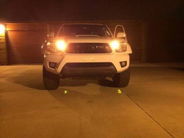

    Here we go as I promised :D

    On a side note, does it look to anyone else like I need to rais the front a little to level it out? it does to me, just want to see what everyone elses thoughts were on that.
