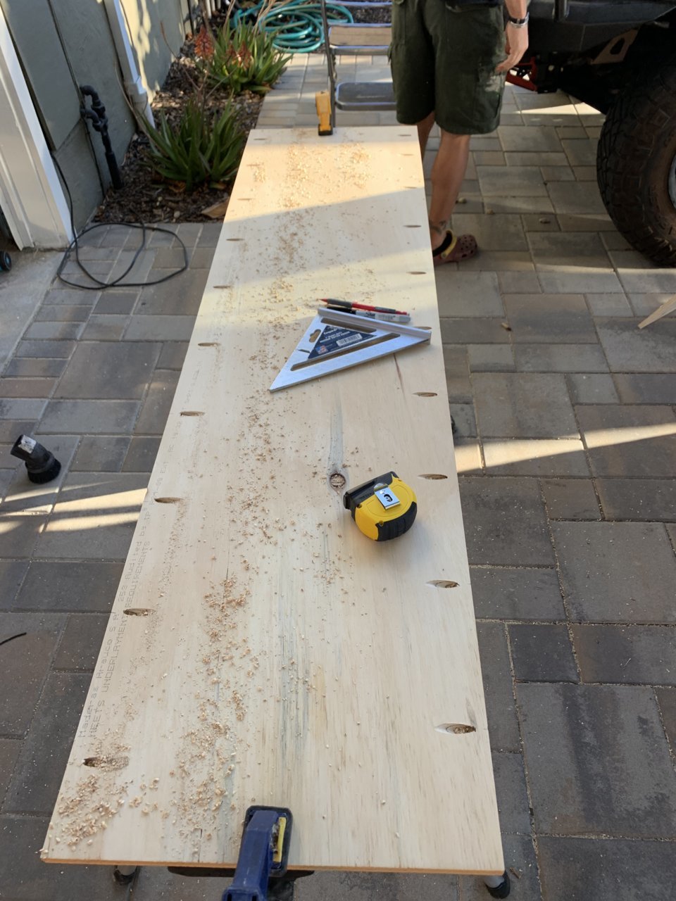

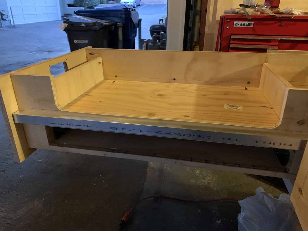

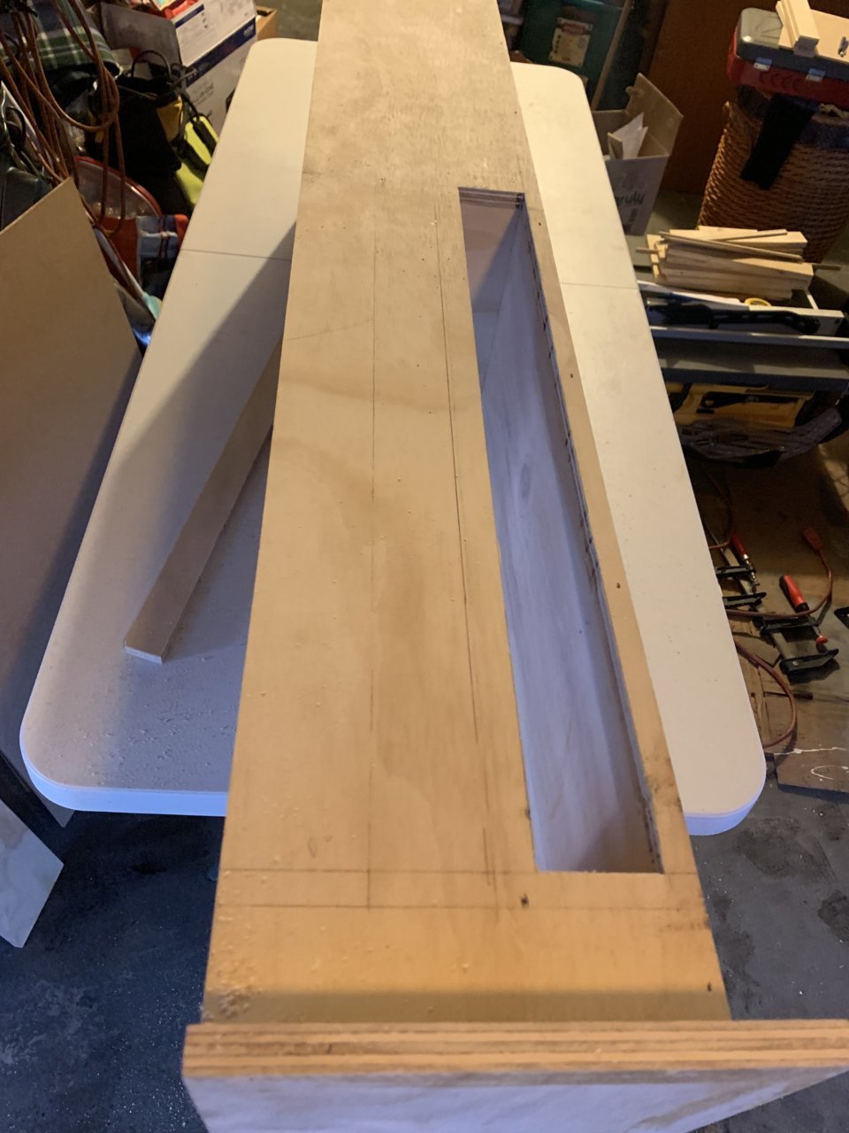

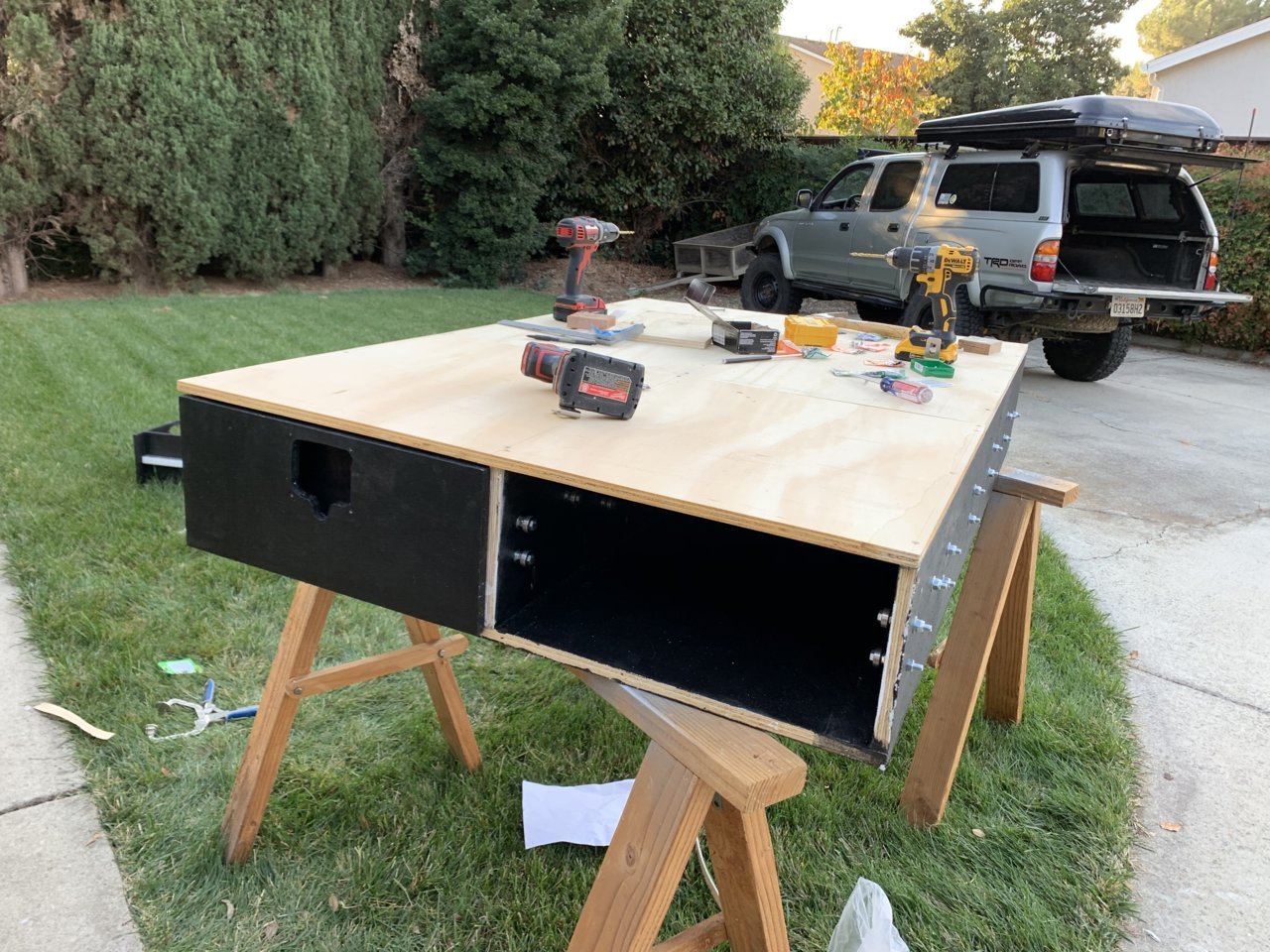

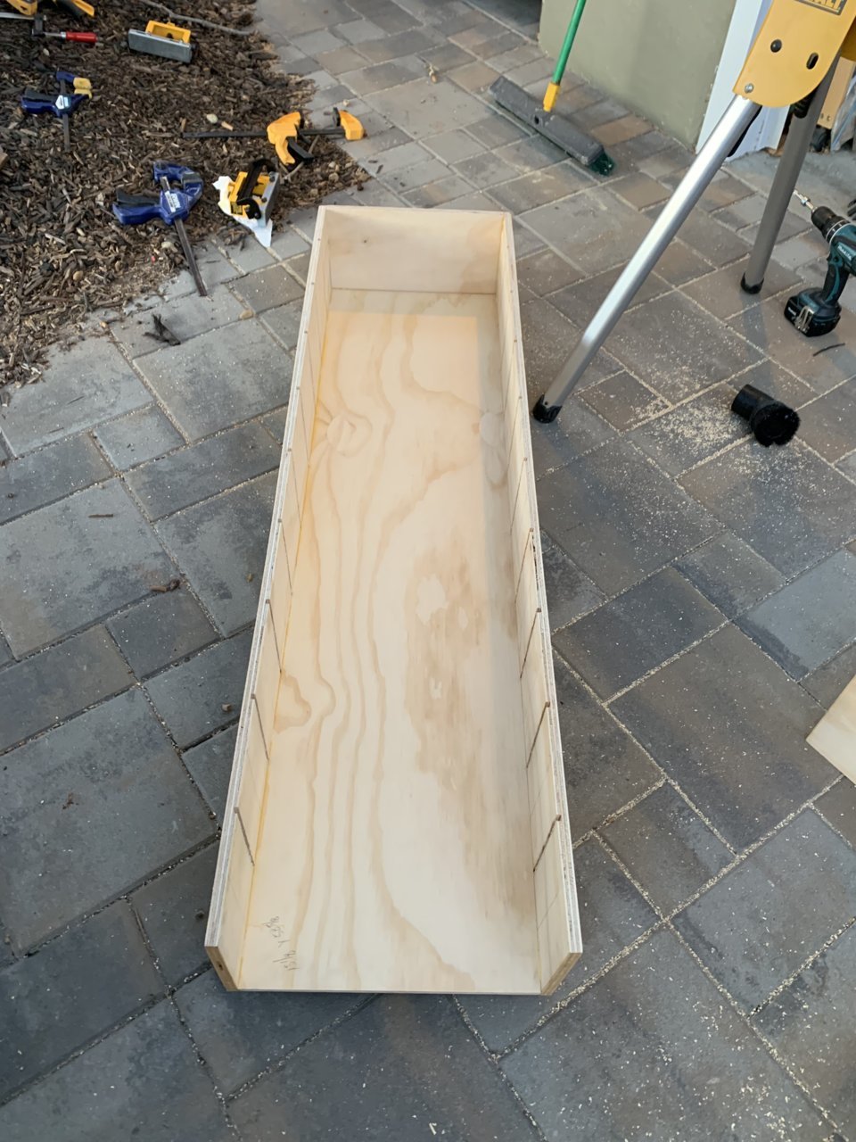

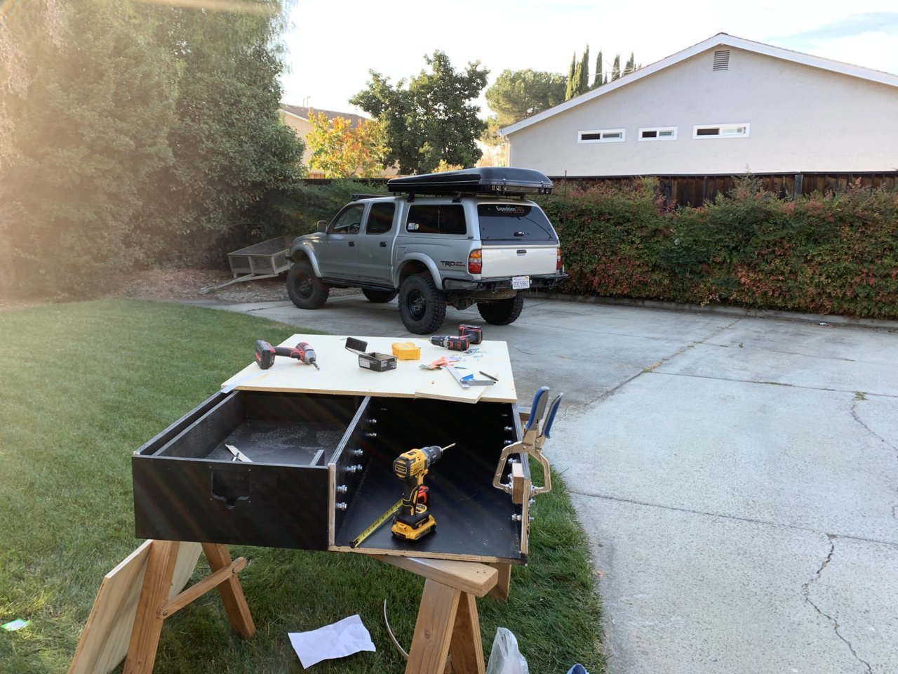

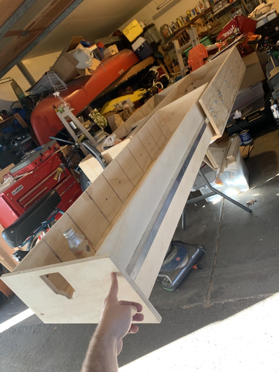

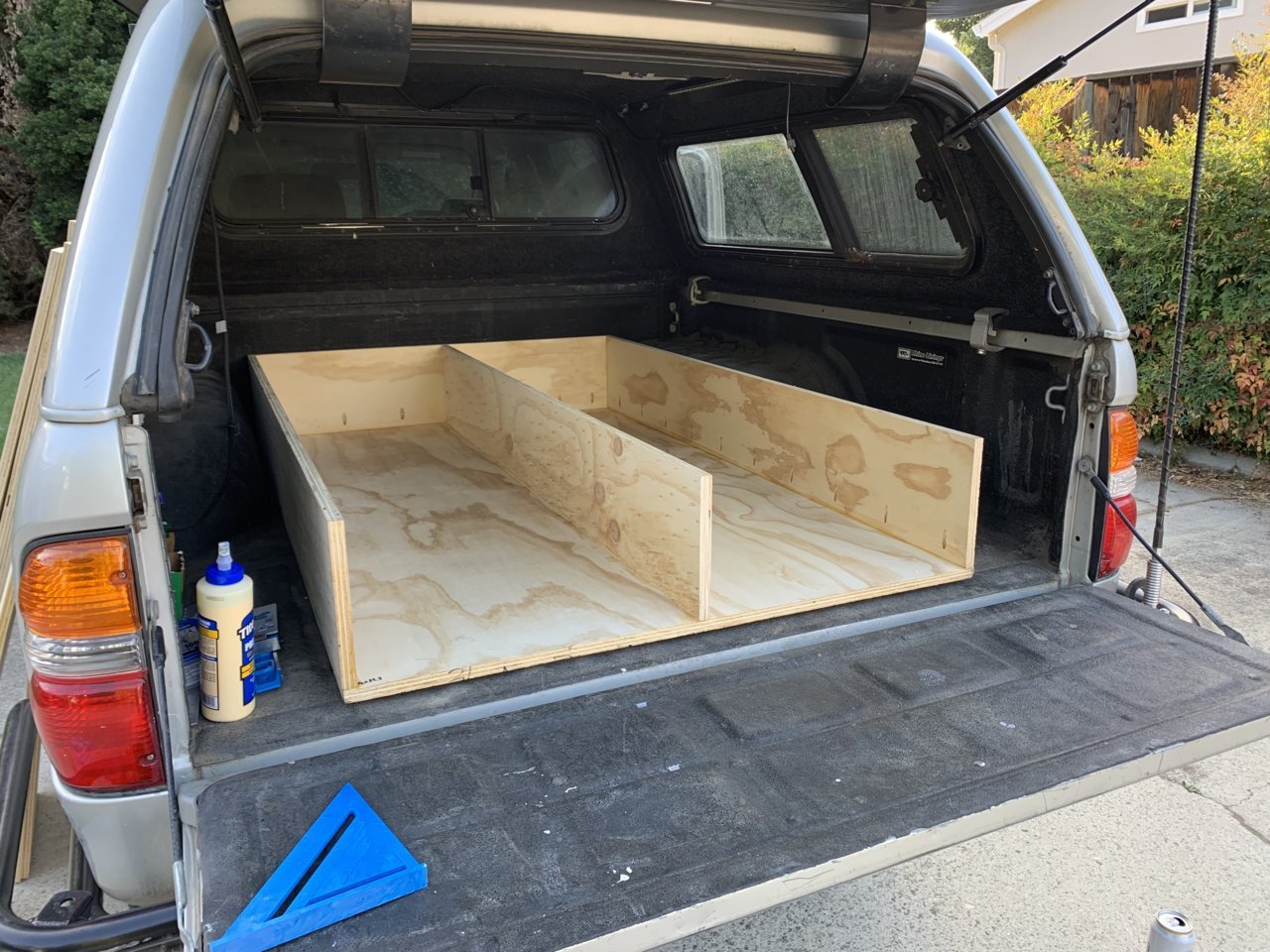

    Decided to build a drawer set up for the truck. I've been using a 3 box system where I keep all my stuff in those boxes for camping but decided to switch it up because:
    1. I don't like crawling in there and getting the boxes.
    2. Limited garage space to store boxes/stuff.
    3. Stresses me out having to pack on a busy work week. With this I can leave it in there, add food and leave at short moment notice.
    4. I want to sleep in the shell for more stealth when I'm fishing public areas where there isn't dispersed camping.
    5. Convenient to sleep in when crappy weather.

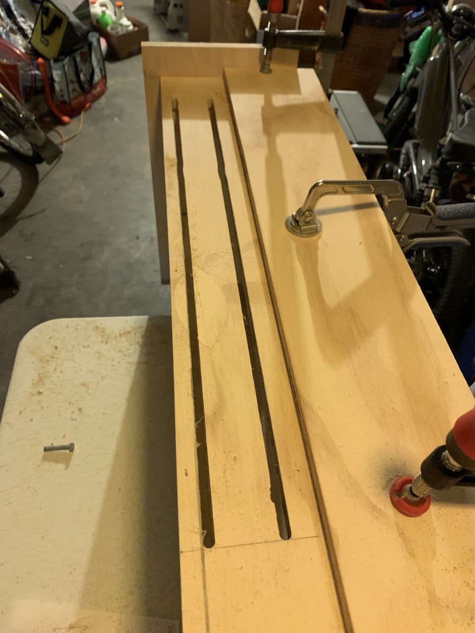

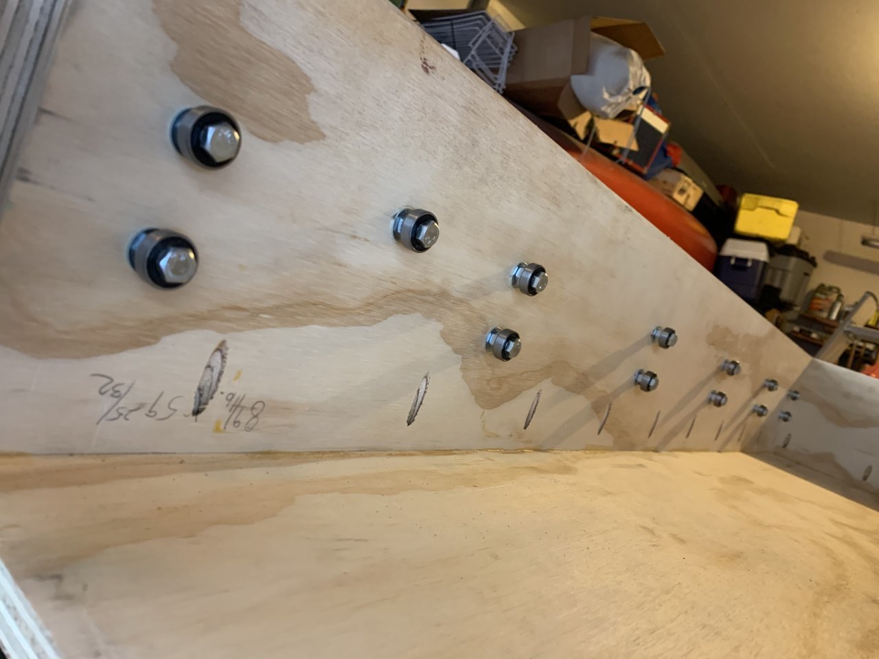

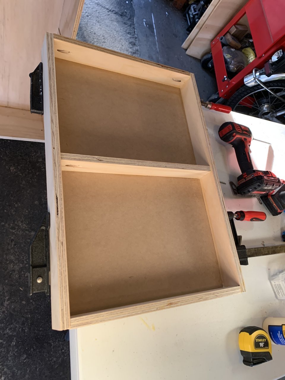

    Initial regrets, not using 1/2" ply for the drawers.
    The base is 3/4 and the drawers are 5/8. The whole set up is heavy, but again, depending on the trail, the truck slams around violently so it needs to be beefy.
    As a disclaimer, I live in an HOA, so I have to be very concious of noise, work times, mess, etc etc in a garage full of crap. I had to bum around a few buddies houses to borrow tools etc.
    So the project is not perfect but gotta make do.
    Did the dimensioning in cad. I had to trim some areas and would adjust some of the dimensions if I were to rebuild it. So cad is accurate , but user needs slight trimming or adjustments. If anyone wants a STEP file, lmk. Bed dimensions r good.
    Still some work to do before its all done. Need to create a top platform, paint the stuff and mount my water port.
    IMG_5520.jpgIMG_5625.jpgIMG_5631.jpgIMG_5663.jpg IMG_5665.jpg IMG_5627.jpg IMG_5755.jpg IMG_5758.jpg IMG_5772.jpg IMG_5807.jpg IMG_5823.jpgIMG_5888.jpg IMG_5917.jpg IMG_5920.jpg IMG_5927.jpgIMG_5932.jpgIMG_5935.jpg IMG_5952.jpg

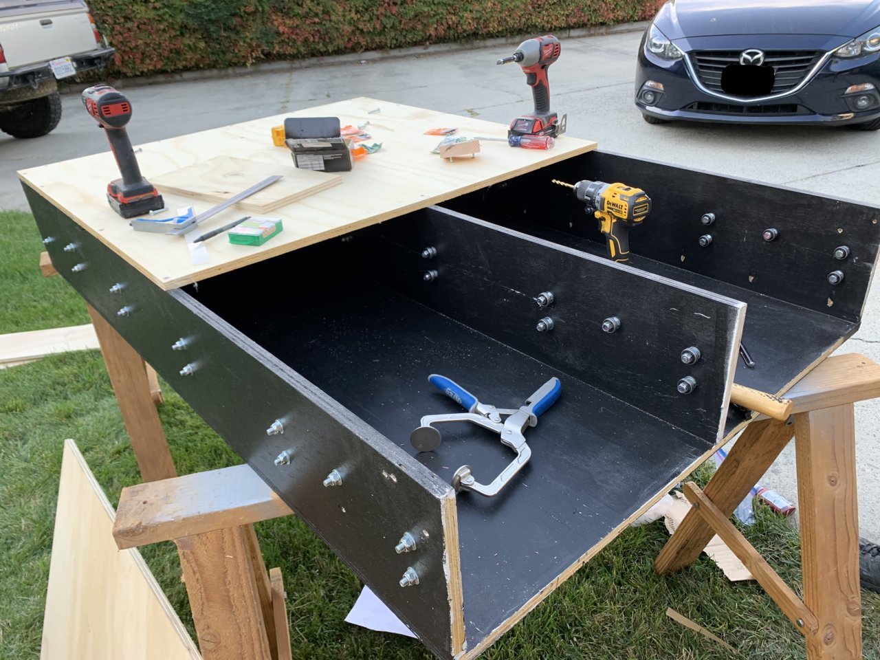

    The paint was a total PIA.
    Used some KellyMoore AcryShield wood primer and the KM AcryShield premium enamel carbon black.

    I think the base can be made lighter. The bottom can be 5/8" the uprights that support the bearings should be 3/4 and the drawrs can be half inch.
    I prefer beefy cus I'm hard on my stuff, but I think what I said above would be good.

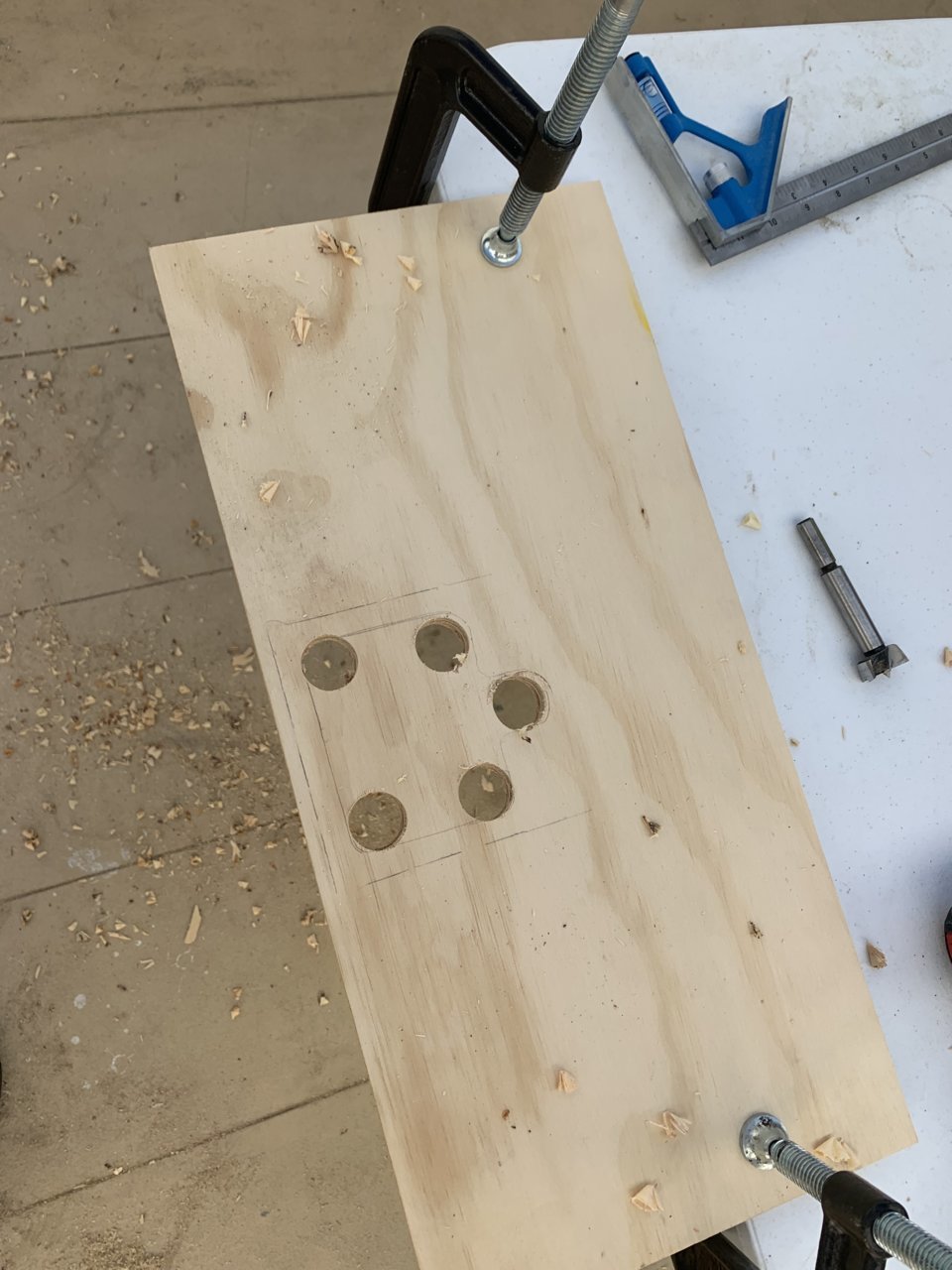

    Honestly, this is pretty much my first time really working with wood.(no pun intended). I saw this thing called a Kreg Jig on youtube, it makes pocket holes, which makes assembling wood pretty easy.
    I got it all done in cad so that I could pay my lumber yard to cut every piece you see. They cut the base, the uprights, and most the drawer parts.
    (There is no way I could have done this project without me designing the drawers first, and paying lumber yard to cut).
    Then the rest I used a few simple tools, but I do have a fabrication background which I think helps with the thought process.
    The hardest part of the project is my little working space and HOA. I share the garage and it's full of stuff. So I have to do one thing at a time, cant have all my crap laid out. Then the noise and HOA crap.
    Shoulda seen me primer these things with a little light bulb over my head last night haha. Should have more pics this weekend, heading over to a friends to try and wrap most of it up.

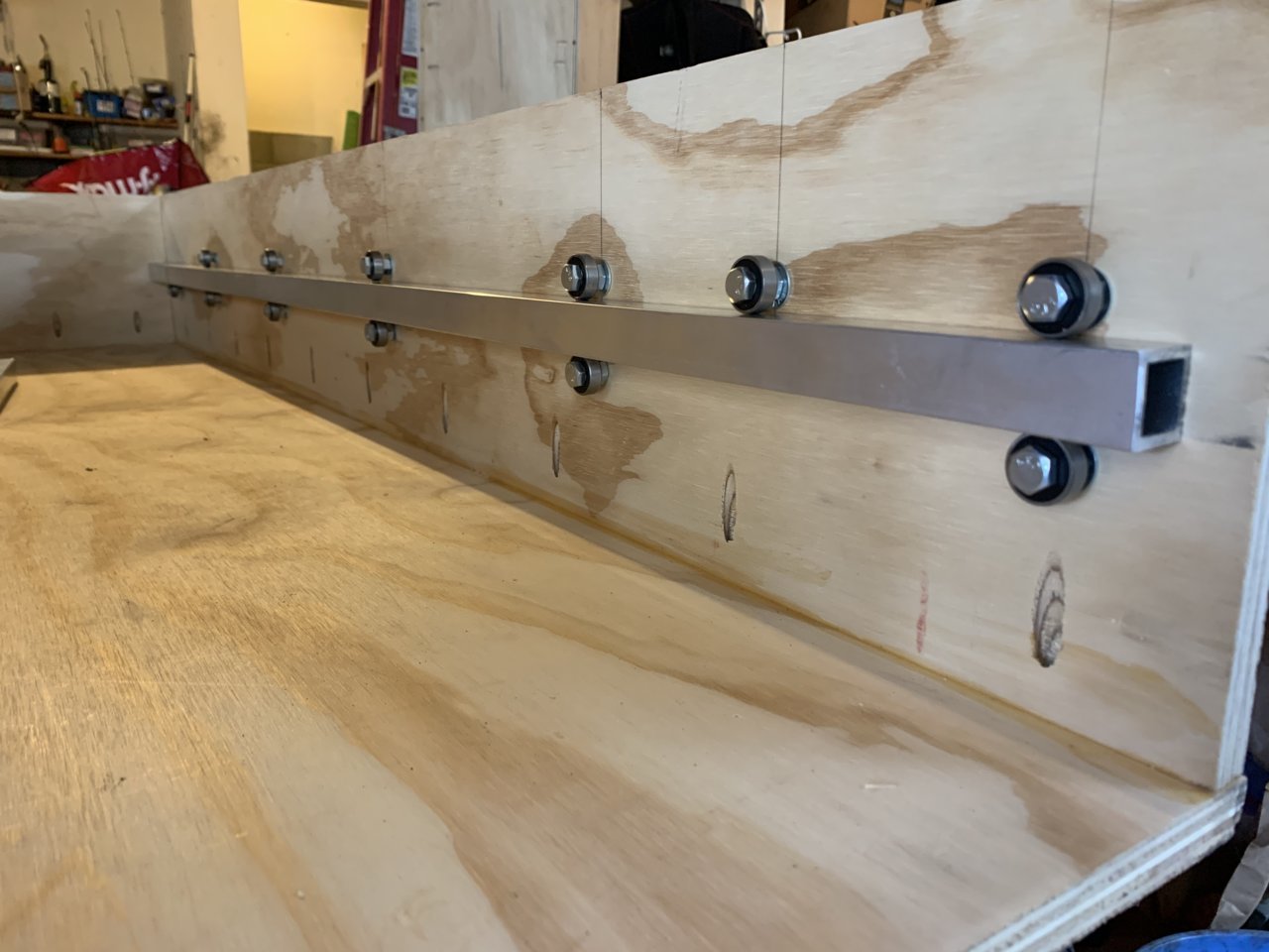

    How is the square aluminum attached to the drawer? With the drawers fully loaded and extended have you leaned the drawer. My concern is the aluminum bending under weight when fully loaded and extended. Will the whole box lift up with both drawers fully extended or is it secured to the bed?
  16. Nov 21, 2019 at 11:05 AM
    #16

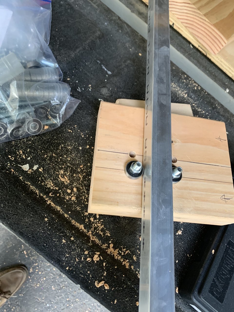

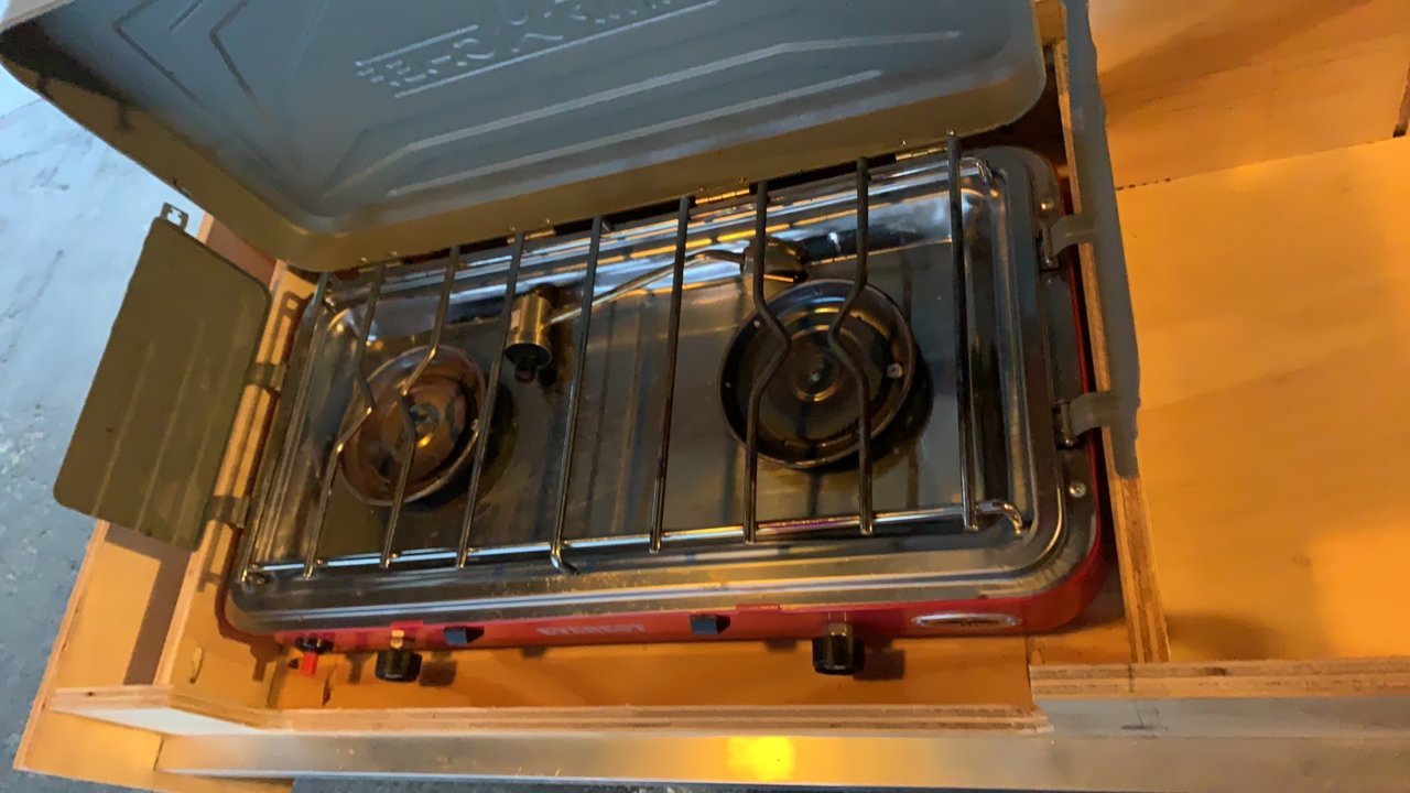

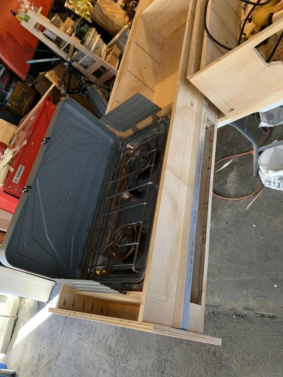

    They're mounted with Teks self taping screws. The tube is 6061T6 1/8" wall 1x1 so it's been working fine. I've had the left drawer loaded no problem.
    I get a lot of the same comments. It depends on the application. If I were running a plumbing operation I'd go with steel and change a few things because you're loading the drawers with dense metal tools. I'm not packing these with steel tools lol. The box will get mounted to the rear tie down points soon. But once again, I will not have both drawers open at once because I don't have a need for it. One is for cooking and food, and the other is for other crap like my fishing gear. It's easier to access one drawer at a time than two to put things way.
    EDIT:
    If you look at the last picture with the stove, what do you expect to put in there that would bend the tubes? That's kind of my point, nothing. The drawer has utensils and spices, and the back will be all food with a pot and pan/cups.
    The worst case on that drawer would be two boiling pots of water. That would be the worst case because of the large mass at the end of the drawer.

    mine will be filled with tools, lots of them thats why I asked.
  20. Nov 21, 2019 at 11:30 AM
    #20
    frenchee
    frenchee [OP] Favorite Member
    Aug 4, 2015
    #161024
    2,131
    Oceanside CA Area
    2003 Tacoma TRD Double Cab 4x4
    Converted to 4WD DD VW MK6 TDI
    Yeah I would go with steel then.
    I would also drill holes in the bed for mounting, which I don't wanna do on mine.
