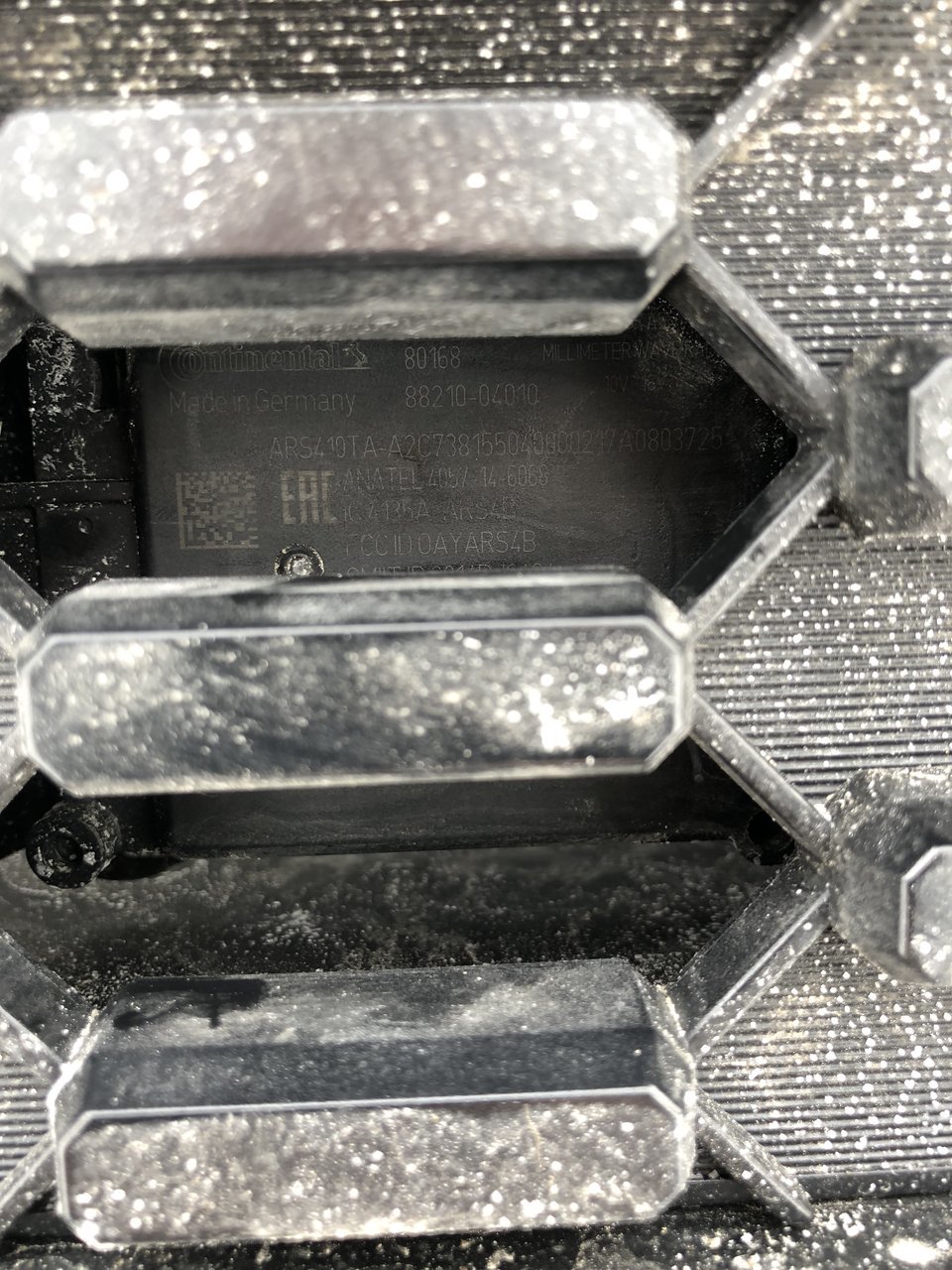

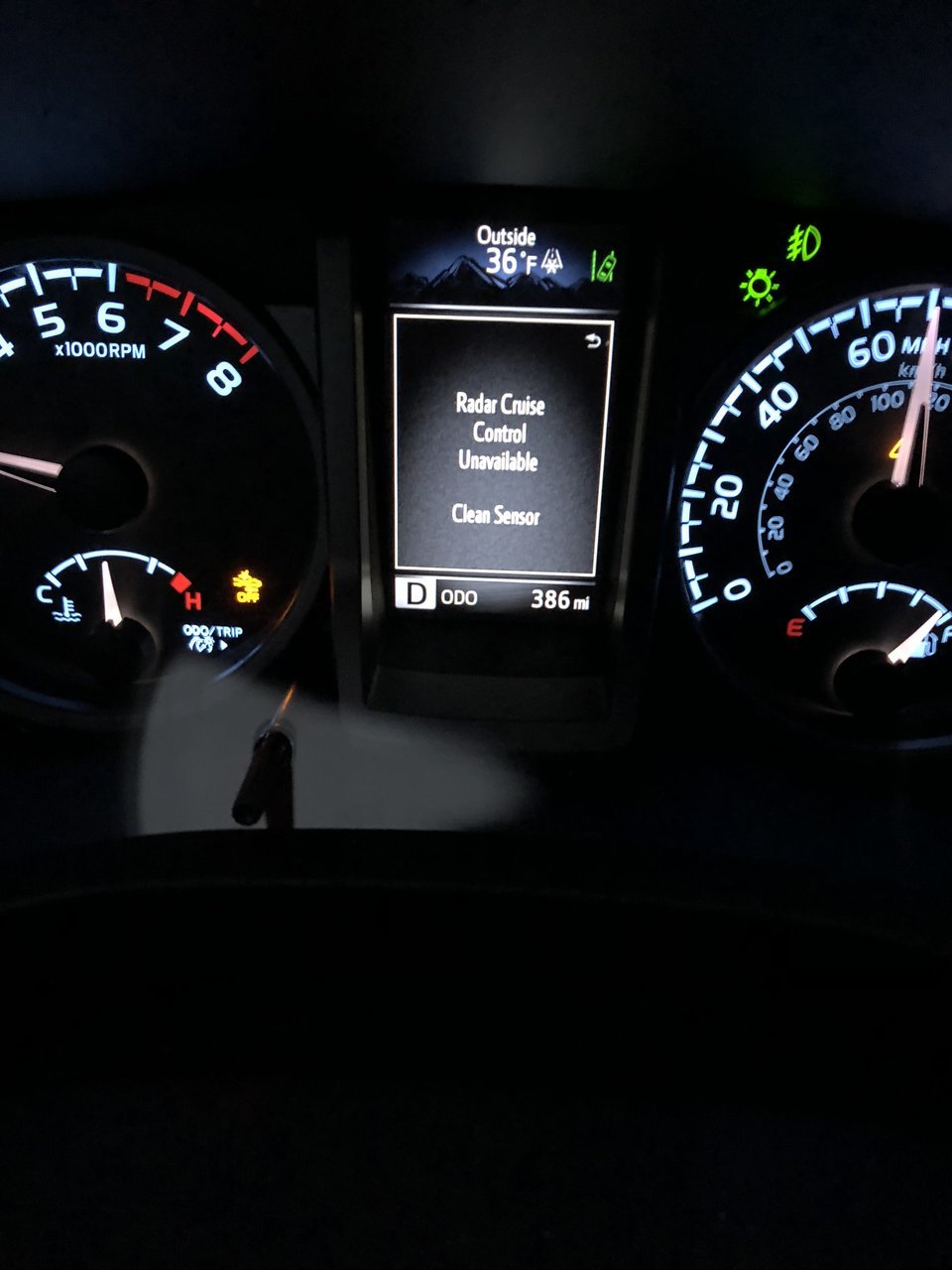

    The first upgrade I made to my 2018 TRD Off-road was to change out the standard grill with an OEM TRD Pro grill. I have the dynamic radar cruise control which used to mount directly behind the Toyota emblem, but with the TRD Pro grill it mounts under the TOYOTA writing and is mostly exposed by the vent holes in the grill. Now anytime I drive I get a message that “radar cruise control unavailable clean sensor”. There has to be a cover of some sorts that must be added if you have DRCC on a TRD Pro. Help!

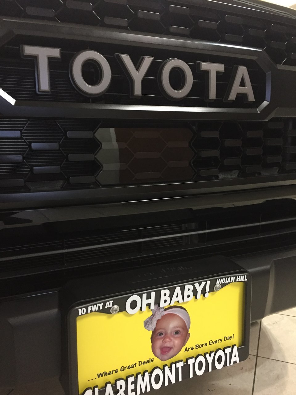

    Just happened to have a picture of a 2018 Pro I took last week
    Hope it helps
