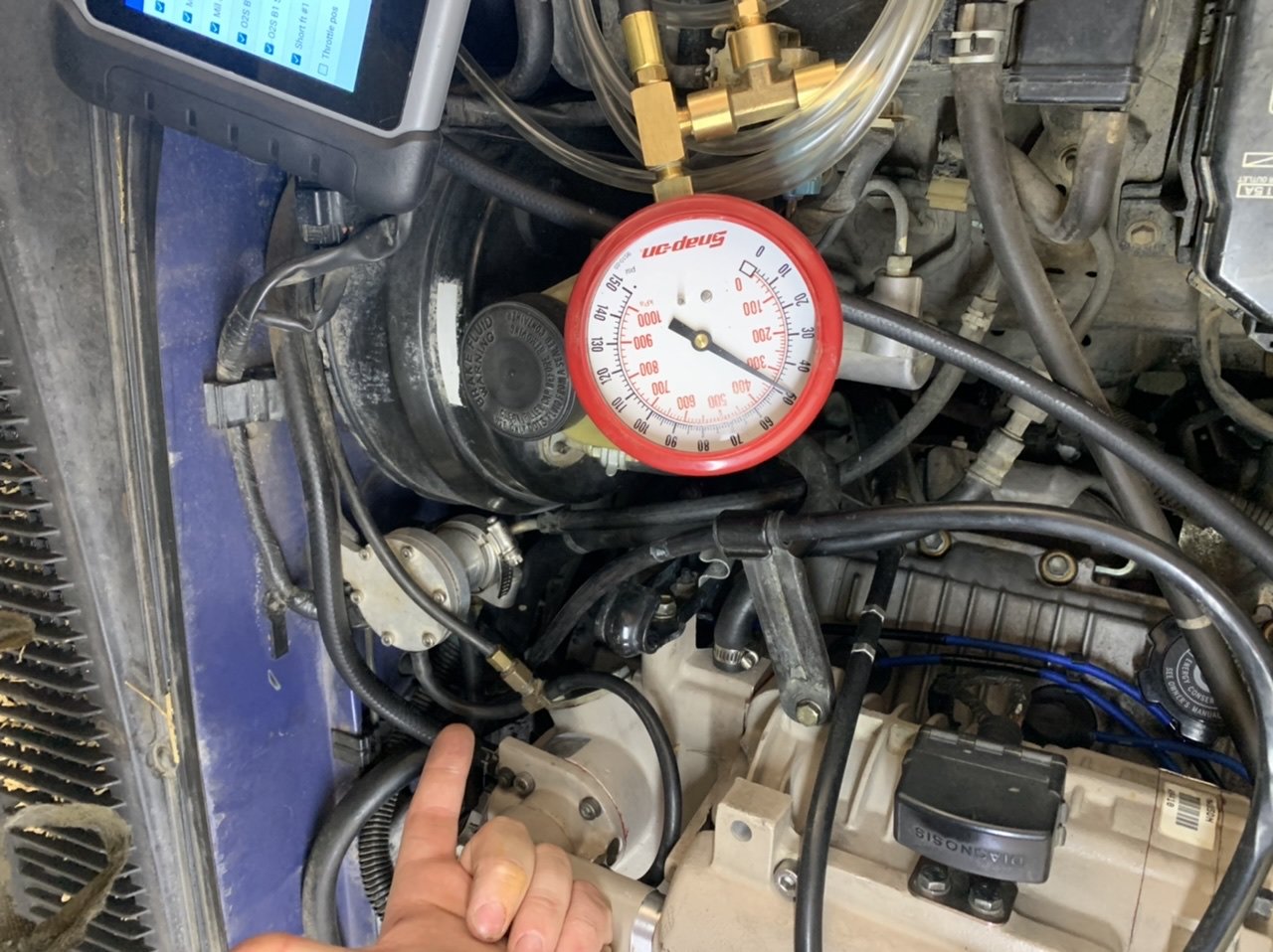

    Hello all. Been working on the rig a lot lately. Started out as a leaking injector shooting fuel all over. Got that resealed and now stuck with a P0172 and I have reset the ECM numerous times. Replaced MAF and Upstream 02 sensor with genuine Denso parts, injectors from LCE Engineering that are sonic cleaned, flow tested Aisin injectors. Verified crank and camshafts timing, compression is 165-180 cold. Leak down test showed very minor loss through piston rings. Plugs look good, Denso plugs and are gapped within specs. They ohm out good, wires ohm out good and coil packs. Fuel pressure holds rock solid after prime and engine shutdown. Running idle fuel pressure is around 48 PSI. Does seem a little high maybe. I disconnect the vacuum line to pressure regulator and no change, stays at 48 PSI which seems odd. No fuel out of regulator though. Possibly a failed spring inside the regulator? This pressure regulator has no name or part number. Does it look familiar to anybody? No change with hoses from charcoal canister removed. I’ve completely verified no vacuum leaks. Upstream 02 switches rich/lean once in closed loop and downstream stays lean like it should. I create a vacuum leak and they both show go lean on the voltages. My short term fuel trim will hang around -2 to -6 at idle and my long term fuel trim will stay pretty much at -40 Mh long term will barely get better with some load or RPM, but at idle it’s stuck at -40. Thank you anyone with some input!! Feels like a slight hesitation at idle, but off the line runs perfect. Truck has 312K Pulls like a mofo through the gears still even running like it does now.

    If you’re running iridium plugs keep the gap that they come with. Don’t gap to stock spec.

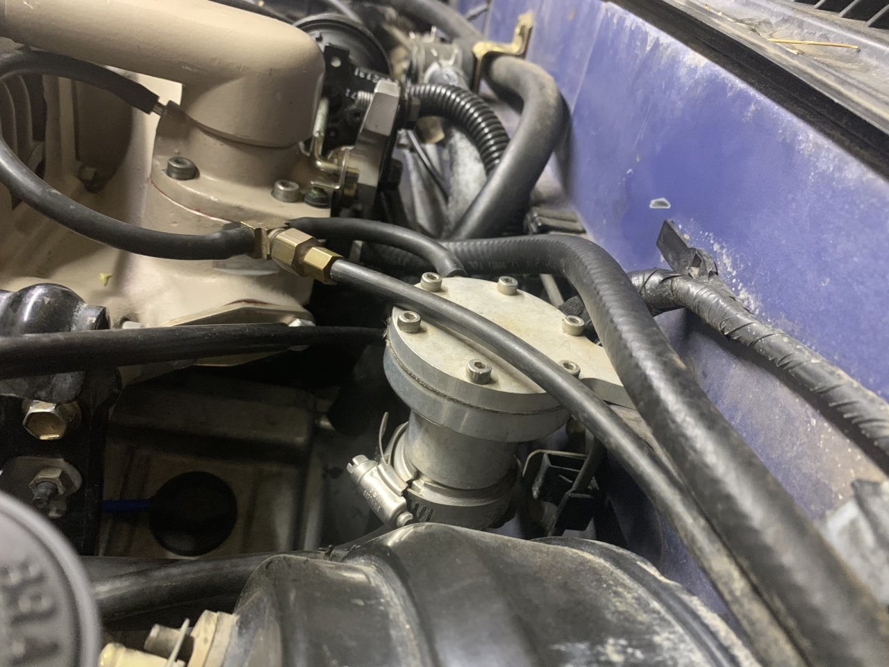

    also, get rid of that fuel pressure booster. Run methanol for extra fuel up high and make sure you’re referencing boost 1:1 by having the FPR plugged into the manifold boost port on the s/c.

    I will double check the plugs again to verify! This fuel pressure regulator setup has been on this truck for at least the last 150K running fine with no check engine light.The other vacuum hose runs to the PCV valve on the passenger valve cover? Is this correct?

    48psi seems too high. I’m pretty sure it needs to be around 43. but I don’t think that would explain throwing a code for running rich.

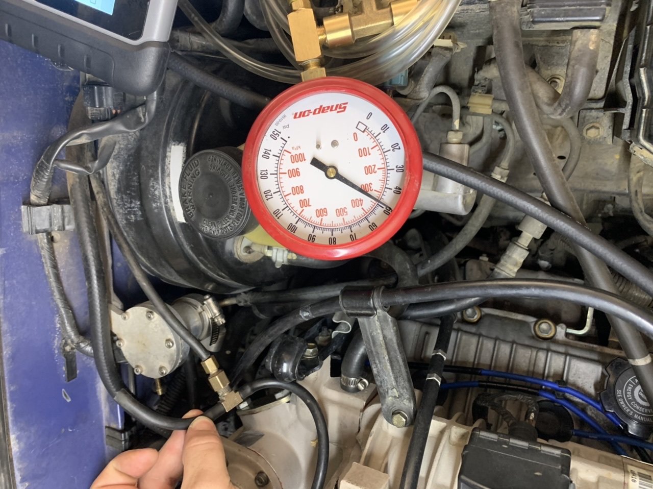

    Someone shoot me. I’m hung up on the fuel pressure still. Sits at 48 psi at idle. Unplug vacuum line and still sits at 48 psi with no change.

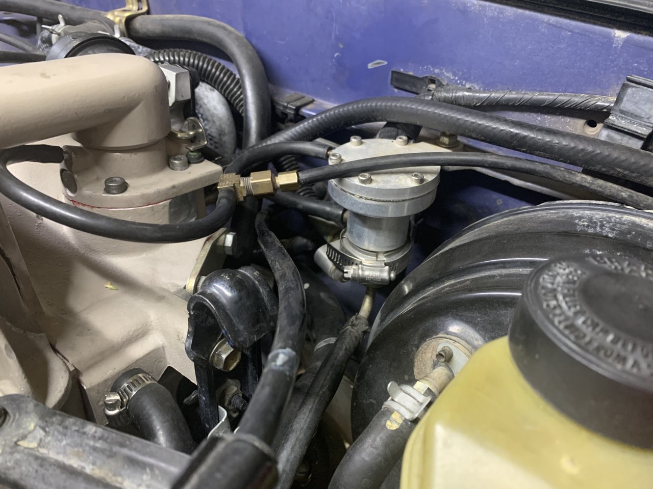

    Has anyone experienced a fuel pressure regulator like this. I’ve ran into the usual fuel squirting out because of a rupture diaphragm. Not the opposite.

    If I understand your post... the LTFT reading of -40 is telling you that the front O2 sensor is maxed out tyring to take fuel out of the system in an off idle situation. If possible I would locate a fuel pressure regulator that can be used in both a normally aspirated and boosted applications that is adjustable. Aeromotive makes a good line of regulators. I would drop the pressure to 44 and see what happens. I think shortman5 is correct... you regulator might have an enrichment factor greater than 1:1 and with the flowed injectors it could just be too much. The problem is is driveway engineering rarley works and you get stuck with fixing and patching a system that doesnt have matched components that are know to work together. Electronics can only do so much.

    Not saying that any of this is a bad idea, just unnecessary. OP should replace the FPR and make sure the vacuum line is hooked up to the lower manifold port on the S/C.
    You don’t need an adjustable reg, those are largely for motors that are converted over to a fuel tank return system.
    40-43psi is what you want. And that’s it. If it’s not running properly with a new reg and that pressure you’re problem is somewhere else.

    Would it be ok to go back to the factory FPR even with the supercharger? This truck is bone stock.
