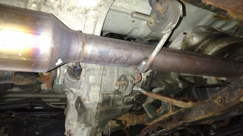

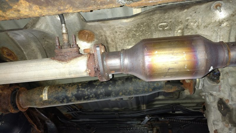

    Here's what it looks like (pardon cellphone pic). Don't know if you can tell what it is by looking at it brand wise.
  14. Apr 12, 2017 at 7:53 AM
    cruxofthebisquit
    cruxofthebisquit Well-Known Member
    Jun 26, 2009
    #18936
    5,308
    John
    Orange Texas
    2000 TRD
    OME and worth every penny.
    In theory, since the cat IS new, just not up to snuff for the ECU. The resister and capacitor (cheap-o simulator) should work.
