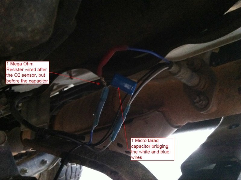

    In TX, you are allowed 2 not readies on OBD2 up to '03, (I think)
    Only 1 after '03 (I think).
    Anyway, you can have 1 'not ready' as long as the light is not on and you have completed 'the cycle' meaning the ECU has tried it's best to 'ready'.
    The cheap-o route is a resister (to slow down inputs) and a capacitor (to slowly feed them back in).
    Sometimes (if cat is actually working, just not as well as Toyota likes it) the cheapo will 'ready'.
    if cat is shot it will not 'ready' but continue on in a 'not ready' state forever. just never trip the CEL.
    So if you can have 1 'not ready' by law, all you have to do is build one, drive 100 miles to set everything else and go get checked.
    They see 1 'not ready' tell you that's all that's allowed and you get your cert.

    Sorry to need to be spoon fed here but you're saying (well, most likely) that the O2 simulator will do what I need done?
    Sandman, I get ya. I do. The cat in it is new. It runs flawless. A quick Google search shows $800-1000+ for an OEM replacement. I don't exactly have unlimited funds or a desire to unbolt and toss a brand new cat in the dumpster.

    It will mask the problem from the computer (and inspection place) making the light go away.
    Masking the code is ridiculous.. Fixing the problem is the right way.

    He says he can have 1 "not ready".
    That means pass.
    The contraption above may or may not 'ready' depending on the state of the cat. but it will not let the light come back on.
    They hook up to our ports here, this is how people beat it.
    W/o buying cats. You want it perfect, buy a cat. A Toyota cat.
    You could try Cataclean.

    Take some pride in your Taco! Fix it correctly so the pcm is getting the info it needs to run the engine. If you start messing with oxygen sensor signals the fuel calculations get messed up. You will get poor mpg and risk damaging your "dream car"
