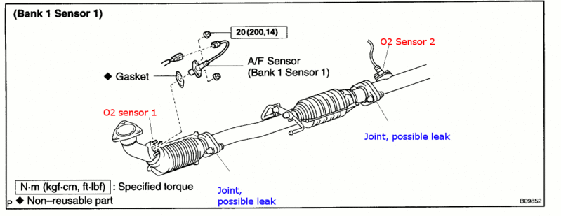

    An exhaust leak for example, would show that the front cat is bad.. Notice the placement of the O2 sensors. The code is thrown because the rear sensor is reading the oxygen content is incorrect(too much/too little Oxygen). This is why we keep saying check for exhaust leaks. The stealership would suggest a whole new pipe/cat because it would correct the problem, example an exhaust leak, and it's money in their pocket.

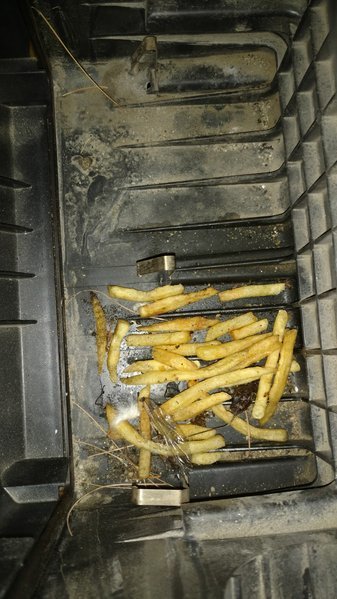

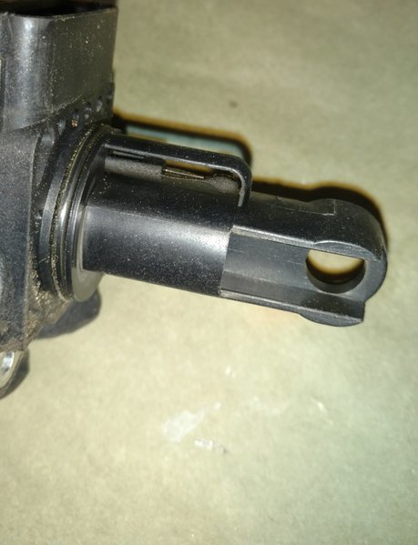

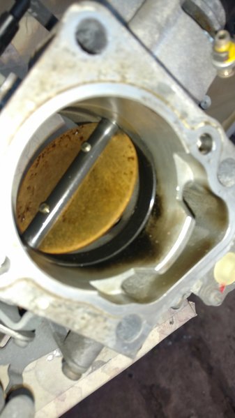

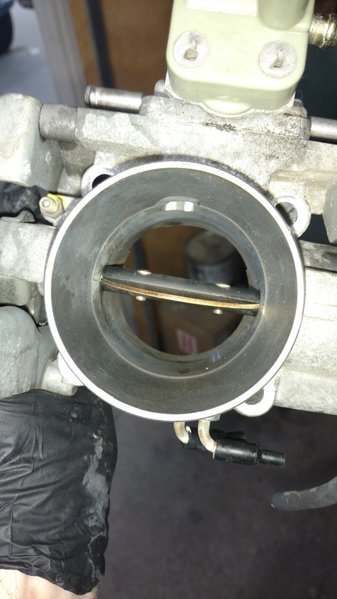

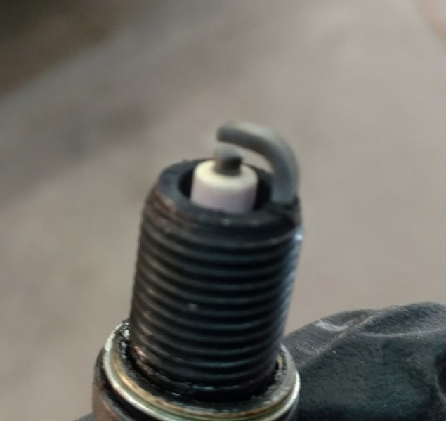

    As of now, I've done what I would consider low cost maintenance items that may have needed doing anyway. I cleaned the MAF with the proper cleaner. Looked like a dirty matchstick in there so I'll guess it needed it. Also removed and cleaned the throttle body. Even sprang for a brand new toothbrush to do it. Pulled the plugs and was pleasantly surprised to see they were in fact, new.
    Took a few pics. Will upload tomorrow. Even found some french fries (yes) in the airbox ahead of the filter. Airbox was warm and so were the fries. This will make a great snack on my hour drive home.

    Had a few mins so thought I'd share:
    Mmmmm. These are still warm.
    Dirty MAF (forgot to take a clean pic)
    Dirty throttle body. Used proper cleaner for it, fresh toothbrush (I'm a big spender).
    All clean.
    Plugs looked perfectly fine more pizza money for me since I won't need to get new ones.
