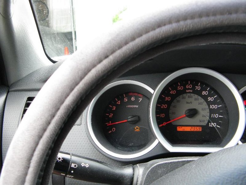

    I've had my Tacoma now for 6 years without a problem. Last Saturday while on a short trip, the CEL light came on. My process to cure this is the basis for this post. Hopefully it will assist you in fixing your CEL and saving a few bucks. Photos are embedded as links and attached at bottom.

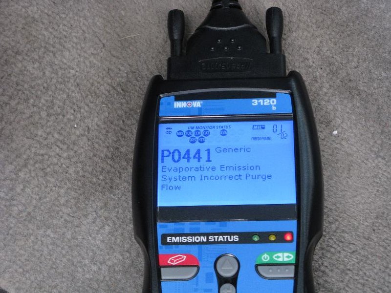

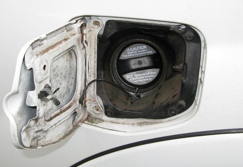

    I hooked up my Innova unit and pulled the code. A PO441 Evaporative Emission System Incorrect Purge Flow.

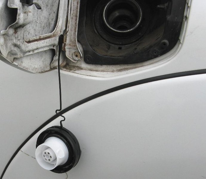

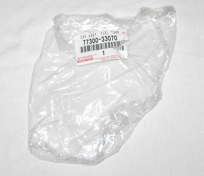

    I did some research and found that three components could be the culprit. Bad Gas Cap, Control Valve, or Canister. This was provided there were no rotted or defective hoses. I checked all of my hoses and they were all good, and supple. I ordered a new Gas Cap from Toyota. It was $30. It was a quick install.
    I used the Innova to reset the code and get rid of the CEL. I drove the truck for about 2 days before the CEL reappeared.

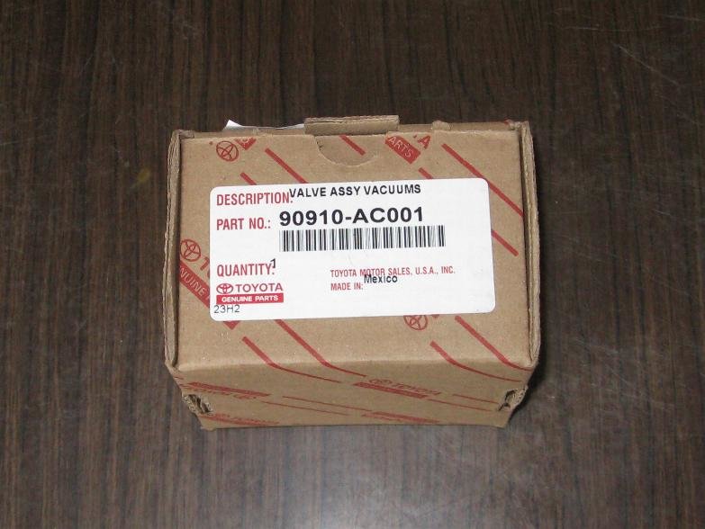

    I was not going to spend the cash for a Charcoal Canister unless I was sure it was the problem. So I stopped by my local dealer, Price Toyota, and they ran diagnostics for $99. It was the Control Valve, and it had to be ordered. I ordered it and it was in the next morning. They allowed me to do the install and part order to save me some money. I avoided the mark up on the price of the part and the labor cost.

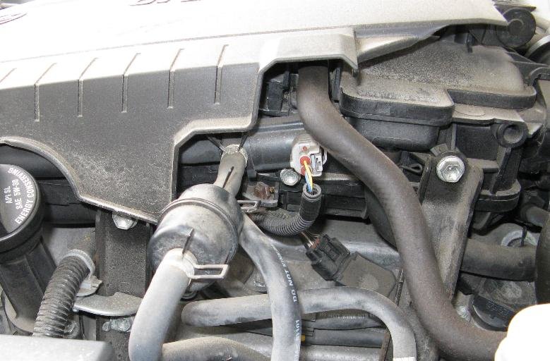

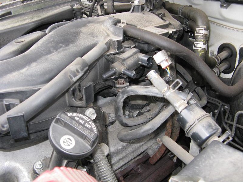

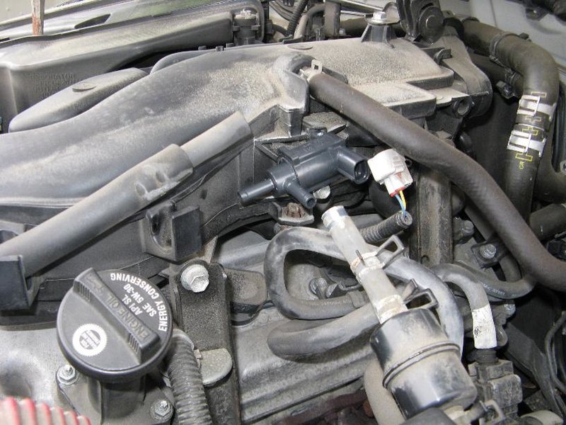

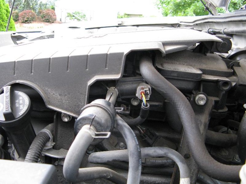

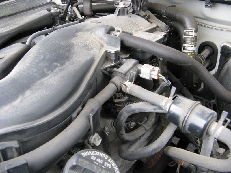

    The Valve is very easy to get to, its right on the side of the intake assembly.
    You'll need a 10mm socket. Remove the screws to the intake cover and prop it up. Now you can clearly see the valve.

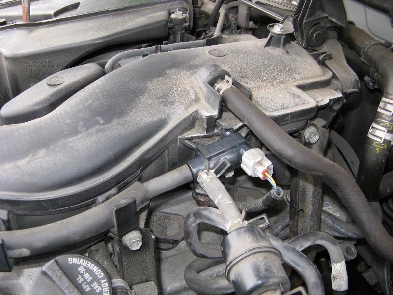

    You do not need any tools to get the electrical connector off, and the hoses, the one clamp you can do by hand. Remove all connections.

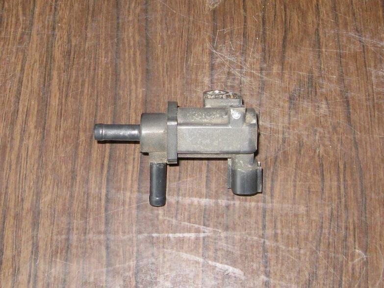

    Use a 10mm socket to remove the lone bolt on the bottom and remove the old valve. It does not look bad and there is no way to open it to try a cleaning.
    Install the new valve using the lone bolt snugging it up a little.
    Hook up your hoses and electrical connection, takes all of 30 seconds.
    Secure your intake cover and close the hood, your done here. Hook up the Innova and clear your code.
