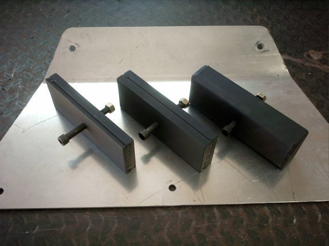

    You're on the right track with shimming the rear, but not a tapered one. Those tapered degree shims are junk anyway. The material is a cast material and cracks in half, plus they pull the leaf pin out of the hole on the axle. since they sandwich in between.
    These are safer and better to use. Flat steel ones that bolt to the pack. 1/4", 1/2", 3/4", & 1".
    http://stores.streetacos.com/-strse-56/BLOCK--fdsh--ONE--fdsh-/Detail.bok
    http://stores.streetacos.com/-strse-57/BLOCK--fdsh--ONE--fdsh-/Detail.bok

    In order to use tapered shims with the Dakars you should get centre pin collars to make sure there is a good connection between the centre pin and the axle

    Thanks for the link, I may go with these. How do they install?

    You remove your leaf pack , C clamp them together , remove the centre pin , install the shim to the bottom of the pack with the through bolt , re install the leaf pack
