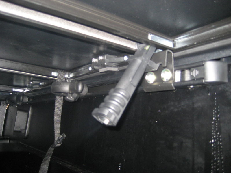

    Another for the Extang Trifecta. I drove through the heaviest rain one could imagine with a bed full of luggage on a several hundred mile trip. The rain never let up. It was bone dry in there.
    It uses the rail system with 4 brackets, plus you can use the factory cleats in the rail too since it sits above those.
    Here's a look from the inside:
    http://www.tacomaworld.com/forum/attachment.php?attachmentid=20356&stc=1&d=1232488731

    That's pretty dry... The drips on the side are form water sneaking under the side seal/between the hinge gaps then hitting the accessory rail then dripping down. How dry does the tailgate stay?

    Actually that's just a random picture I took to show how the rail system remains usable. Have to take my word on the dryness.
