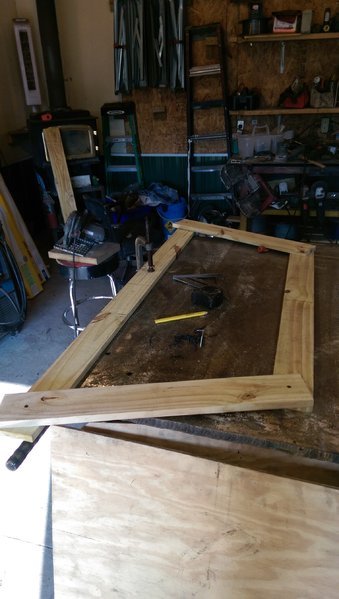

    First off the frames for the shape of the boat needed to be constructed. The plans I purchased gave me the dimensions for these. There is a bunch and they are different sizes.
    The boat sides will be attached to these to create the shape of the boat.

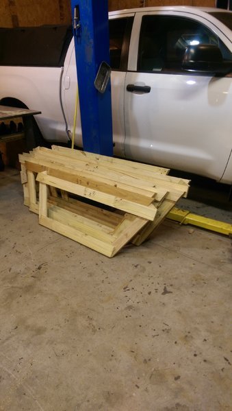

    Here is all 8 of the forms. The owner of the plans calls them "strong backs". I dunno? They are forms to me.

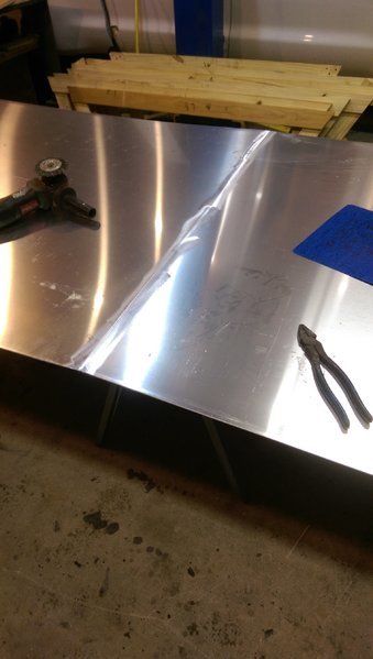

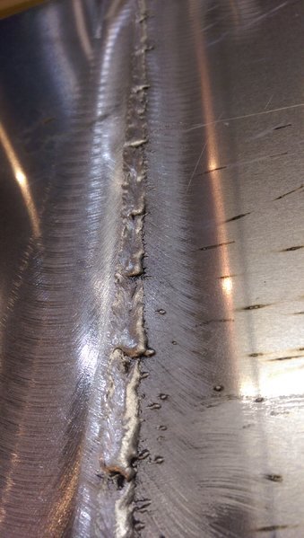

    The boat sides are made from 2 sheets of aluminum seamed together. This will make a boat roughly 15' long.
    The 1st pic is of my welds. At that time I was unaware that my spool gun was defective. I just figured it had been so long since I welded, that I was out of practice. I was not proud, but I figured I better show that good welders make shitty welds at times.

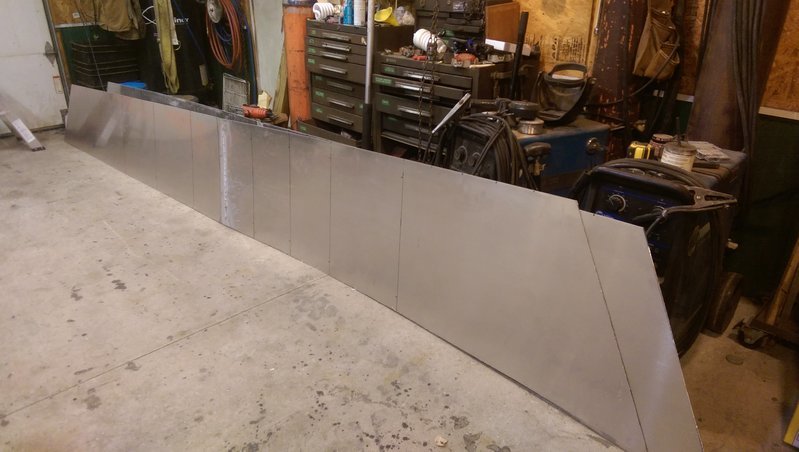

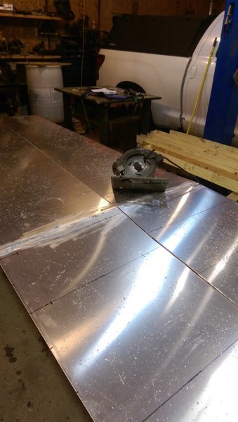

    The 2, 4 x 8 seamed together. This will be the 2 sides.

    Ripping the sheet to make the 2 sides. A carbide tipped blade does a very good job cutting this stuff.

    The 2 sides cut to size and the location of the forms marked on the sheet.

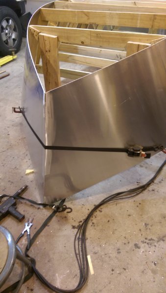

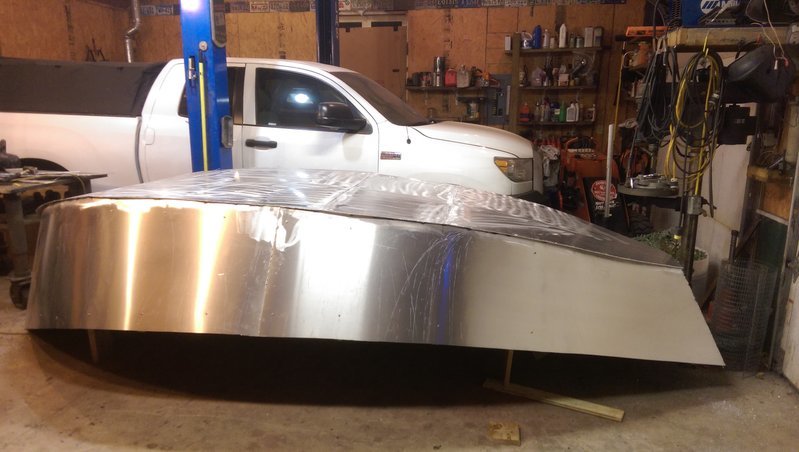

    Wrapping the sides around the 1st of the forms. I will note that this part of the job kicked my ass. Next time I will have a second person assist me. Trying to control 2, 35 lbs. pieces of sheeting is work!
    I do remember how excited I was when I got to this stage! It looks like a boat!...kinda.

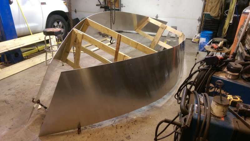

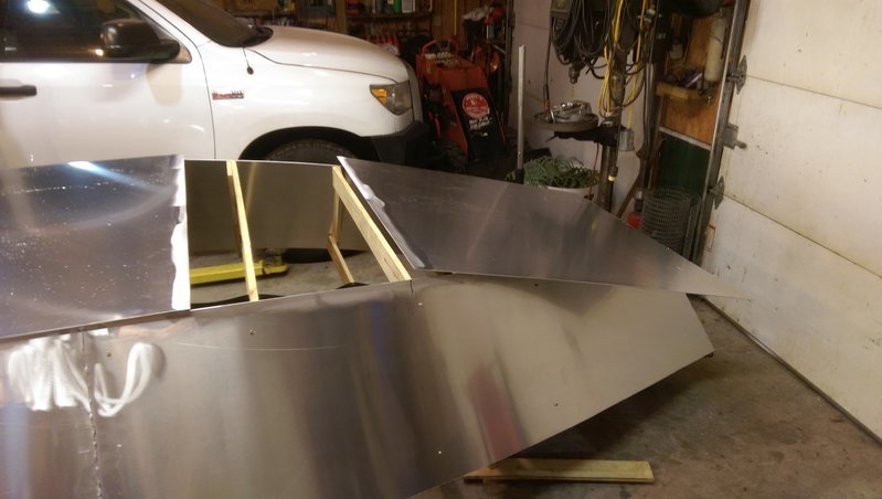

    Sides are attached to the forms with drywall screws driven into the forms.
    I made legs for the 1st and last form to get the boat off the ground.
    I remembering being very worried that my welds would crack. I was happy to see they flexed just fine.

    Pulling the sides together to form the bow. Whoever invented winch straps, I want to shake their hand. You will never run out of uses for them.
