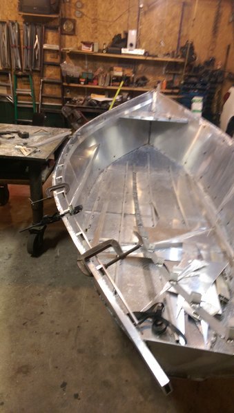

    Reserected from the dead.
    Installing inner rub rail.

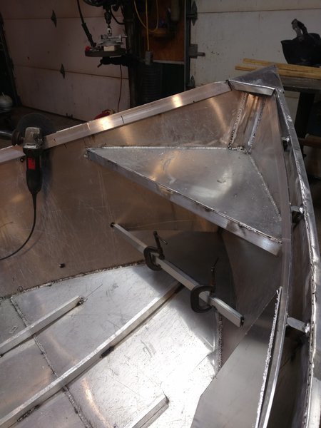

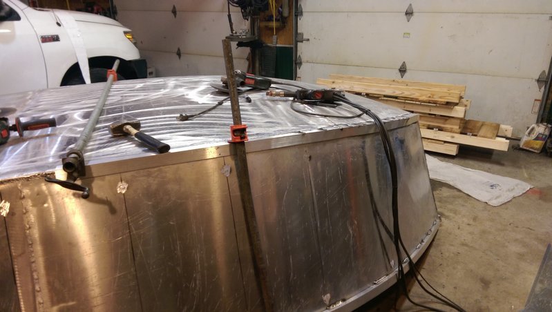

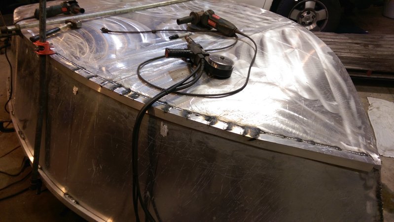

    Back inside. Installing the trim chine. This covers up the weld and gives it a more professional look. This was not a lot of fun.
    I used 2" x 2" angle. That stuff does not want to bend. I ended up cutting relief cuts so I could make it go where I wanted it to go. Next time I will use something thinner and more flexible.

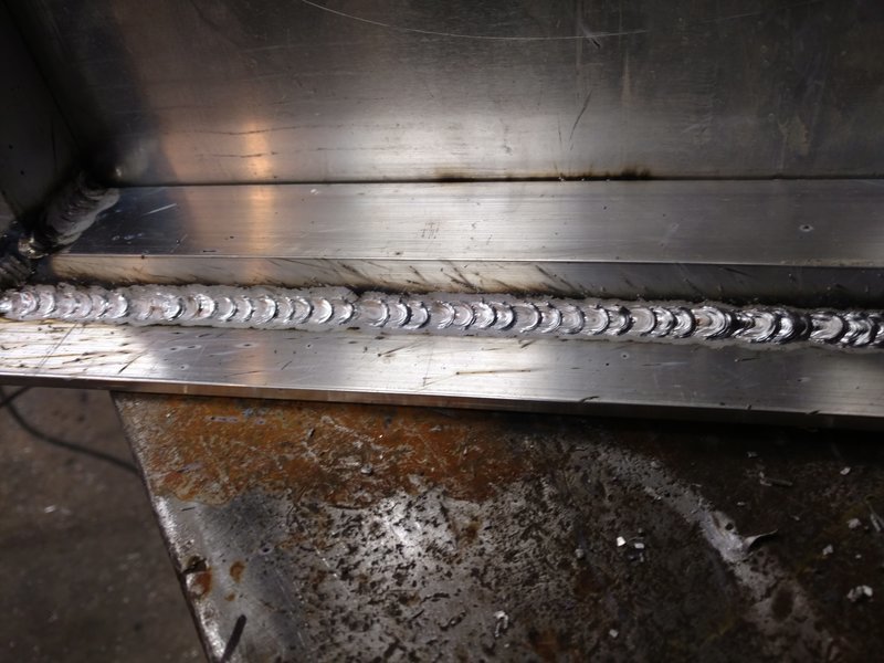

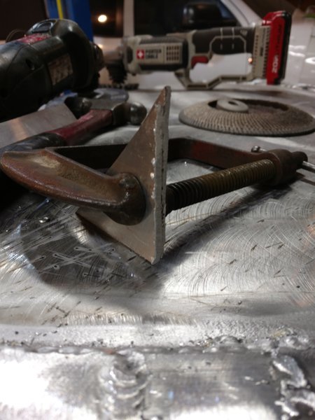

    Attached another layer of sheeting in the back to make the plug area 1/2" thick.[​IMG]

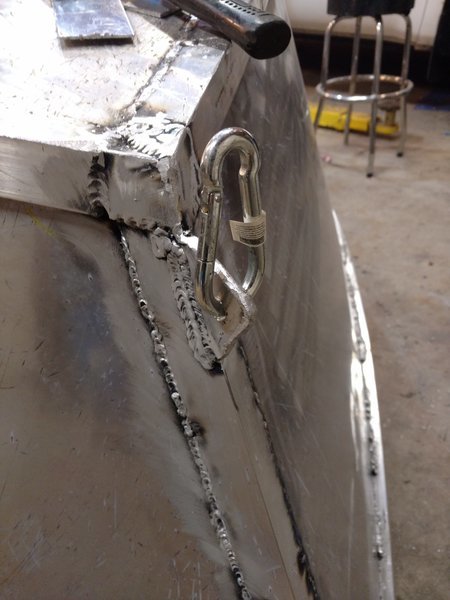

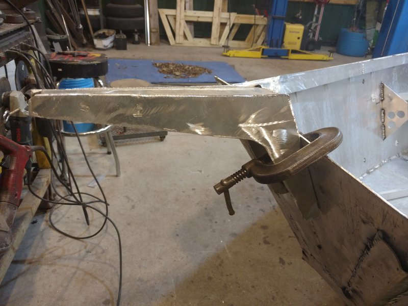

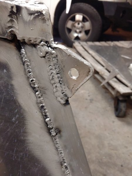

    Making the winch hook for the bow. Again, I only had 1/8" material, so I laminated 2, together to make 1/2".

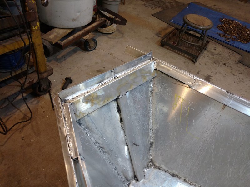

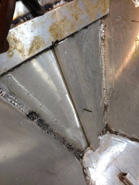

    Fabbing up the transom. The vertical piece of tube and the stern had a 1/2" gab because the sheeting had bowed. I had to drive a self tapping screw in to pull the pieces together.

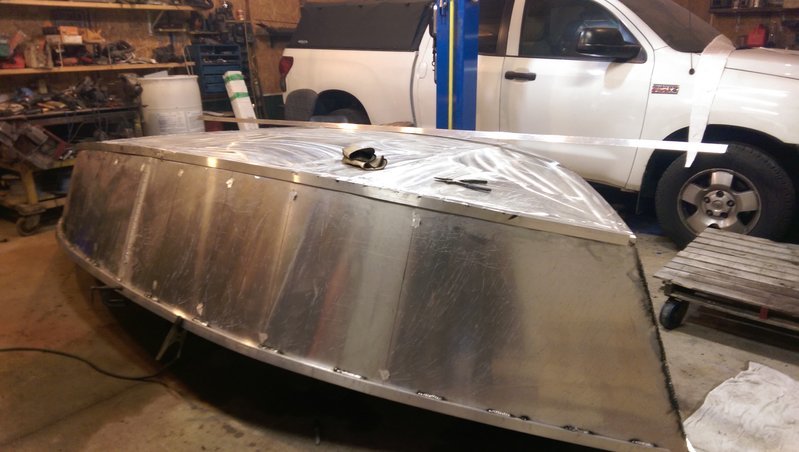

    Fabbing up the bow trim.[​IMG] [​IMG] [​IMG] [​IMG]

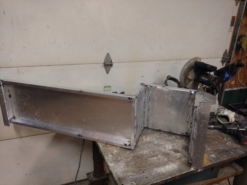

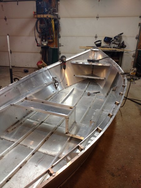

    Starting to fab up the rowers seat. This has changed and will be evident in later pictures.[​IMG] [​IMG] [​IMG]
    This size material is a dream to weld on.

    Should have included this pic with the last bunch. I wanted a "walk thru" style seat. Often we have to move front to back very rapidly when we get a big steelhead or salmon on the line. As non of us are getting any younger and all seem to be getting a bit "top heavy", anything to help us keep our balance is a good investment.

    Fabbing up the foot shelf. It's wasted space, so I decided to put a shelf there.

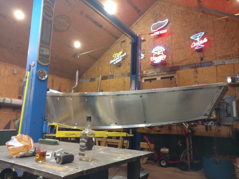

    Needed to clean the shop. Moved the Tundra outside to get washed, since you couldn't see thru the window from all the aluminum dust on it.
    Put the boat on the hoist so I could do a deep clean everywhere else.
    Took a much needed break, while promptly losing the cap to my bottle. Bummer;)

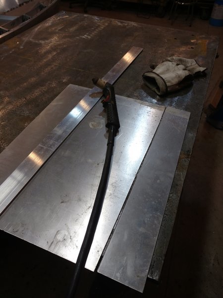

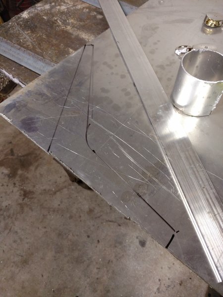

    Took a little detour.
    Fabbing up some drink holders. Started off by ripping some sheeting into 2" strips. Plasma cutter works great for this.
    Had some old axle tube laying around. I used that to wrap the aluminum around to form the drink holder.
    I figured these 25 ouncers would be the largest anyone would have for drinks. [​IMG] [​IMG]
