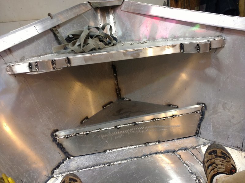

    Welding in the floor supports. My left foot is standing between two of them. this will support the center of the floor. I welded similar "L" bracket to the boat sides to support the floor edge.

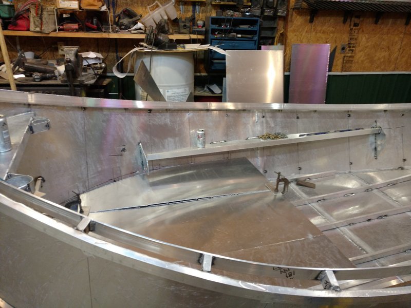

    I didn't feel like cutting a brand, new sheet of aluminum for the floor, so I seemed some scraps. The floor is getting some sort of coating, so a seem hurts nothing. [​IMG]

    Shot of the seamed floor and the floor supports can be seen as well.

    I closed off the section below the foot shelf. I figured that was no man's land. Anything that fell in there would never be seen again or could really stink.

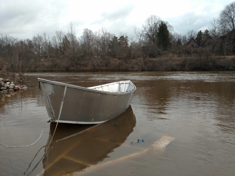

    Borrowed a buddies fishing boat trailer. Put the boat in for its water test. I couldn't take the boat out. I had no oars yet. No water was present after sitting for 15 minutes. I was happy.

    Sits nice in the water

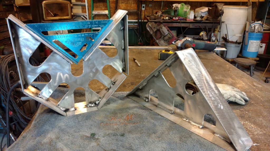

    [​IMG] [​IMG] [​IMG] I came across these squares/jigs on youtube. I wanted to try them out, but wasn't going to pay the money. I decided to make my own. They work awesome for guys like me. They really help with fabricating small parts that need to be fairly square.

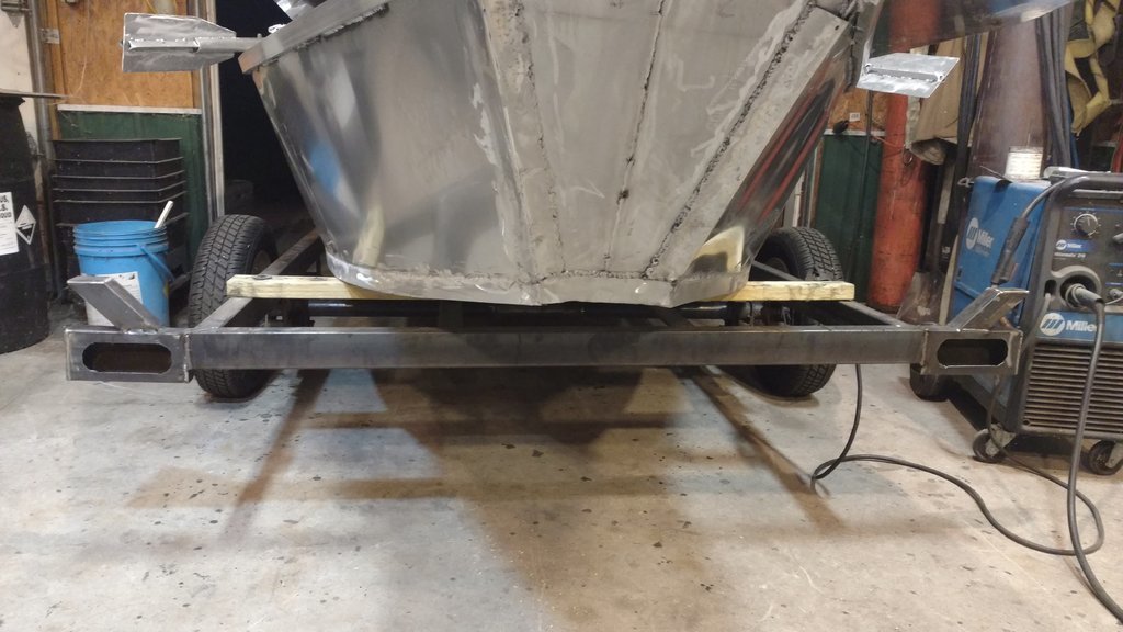

    At this time I got tired of the boat taking up space in the shop. I decided to build a STEEL trailer. Here I using my new fabrication squares to build tail light brac[​IMG] [​IMG] [​IMG] kets for the trailer.
    medic2230 likes this.

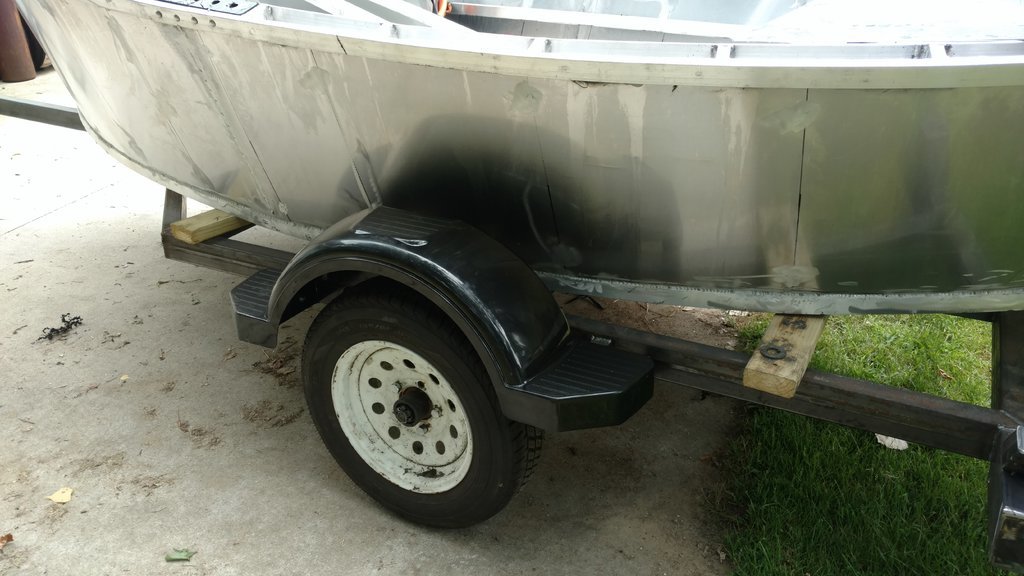

    Picked up these plastic fenders off of Amazon. they should be pretty nice for preventing scratches to the boat during loading and unloading.

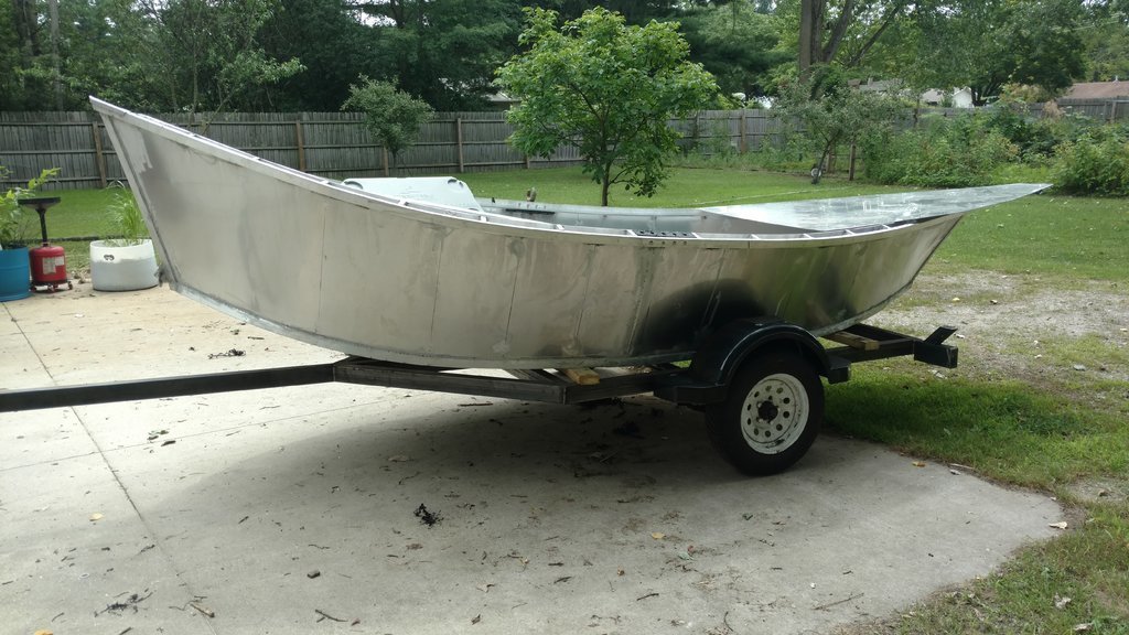

  20. Sep 20, 2017 at 6:25 PM
    #80
    koditten
    koditten [OP] Well-Known Member
    Sep 8, 2013
    #112077
    19,887
    Kirk
    Central Michigan
    04 trd x-cab 4 x 4 3.4l
    Reserected from the dead.
    Another shot of the boat and trailer.
