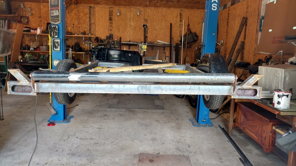

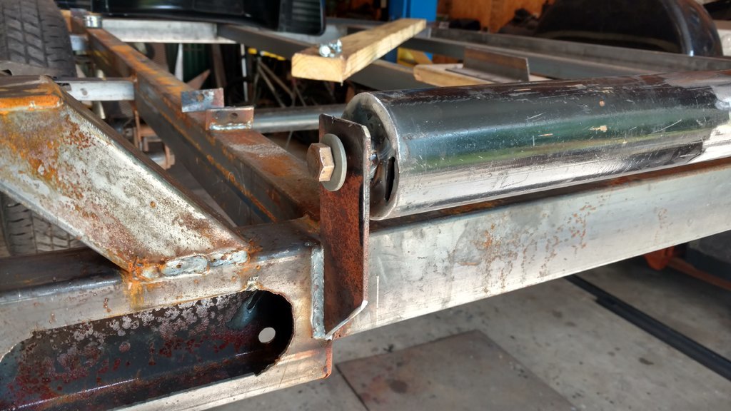

    I needed to fab up a roller for the rear of the boat. this assists with loading and unloading at unimproved launches.
    Side story time:
    I mentioned to one of the contractors that I work with that I needed a piece of 2 1/2" pipe to make the roller. His name is Tom. He told me he would look thru his scrap pipe pile. He asked for my address and told me he would drop off a piece in the next few days.
    Anyways, a day goes by, while at work I get a call on the radio from a coworker wanting my location to meet up.
    Mark (coworker) shows up with a "100 watt" grin tells me "Tom called and wanted me to tell you that he just got done laying some pipe at your house". "Want to tell me about that"? I guess you had to be there. He thought he was some funny shit, and it was.

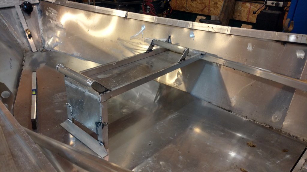

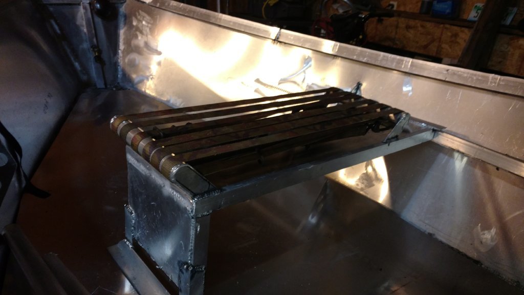

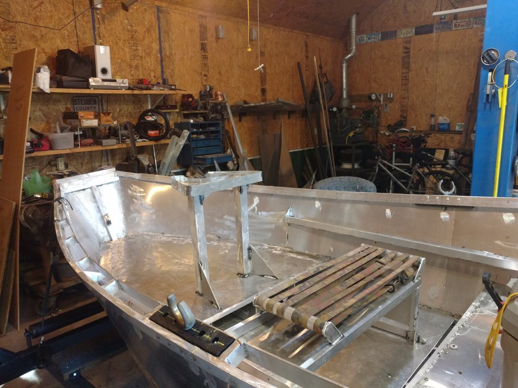

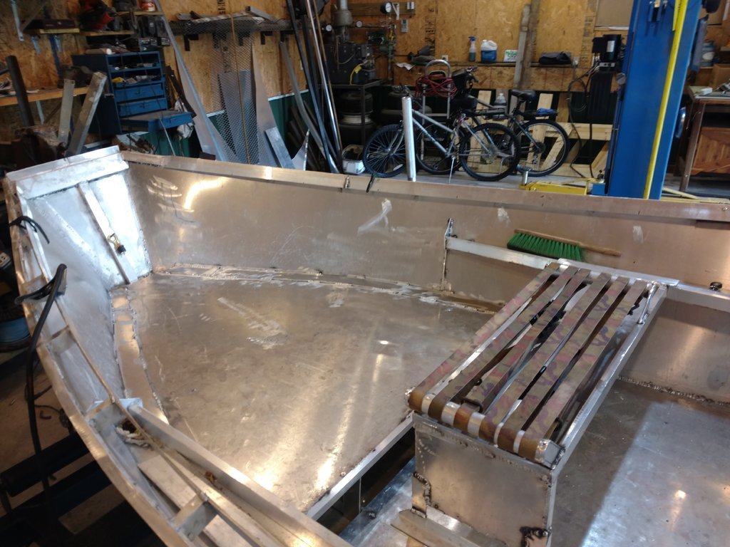

    Working on the rowers seat/bench. I didn't like the way the walk thru style looked. I decided to hack off the walk thru side and just bolt it to the floor. I just looks cleaner to me. The main reason I constructed it previously was for side to side rigidity. This boat does not need it. It is plenty rigid and strong. In addition, we don't have any white water rivers in this state.
    I cheated for the seat bottom material. The usual material is plain old rope. I used a 20' winch strap. I can make it tighter or looser...and you never know when you might need an extra winch strap.

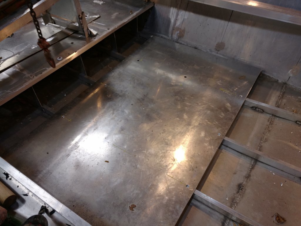

    Installing the floor for the rowers portion of the boat. Trying something different. The front floor section is attached via stainless steel screws. T his section I decided to try plug welding the sheeting to the supports below. After grinding flat, I really like it. I hope it stays put.

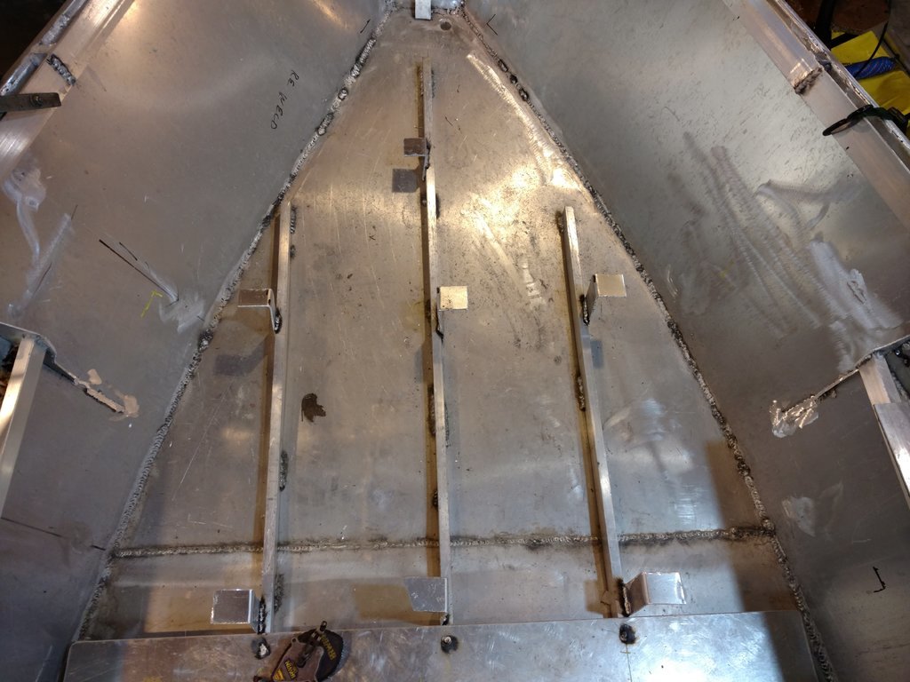

    The rear section is getting the same floor style as the front. I plug welded this sheet down as well.
    Another screw up. My sheeting was not wide enough, so I had to make edge trim extensions. No big deal, again, its getting carpet or some heavy coating.

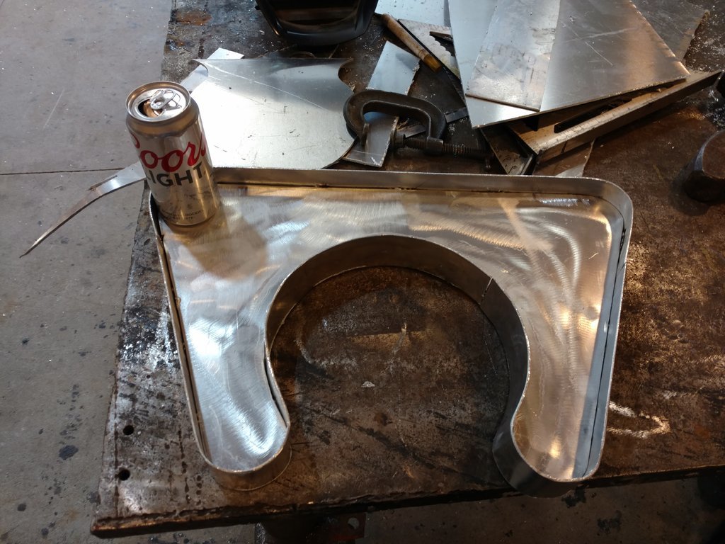

    Fabbing up the thigh brace. The idea is you place one of your legs into the cut out. This enables you to maintain balance while standing. They work very well.
    The radii of the edges matching the beer can was completely coincidental.:rolleyes:

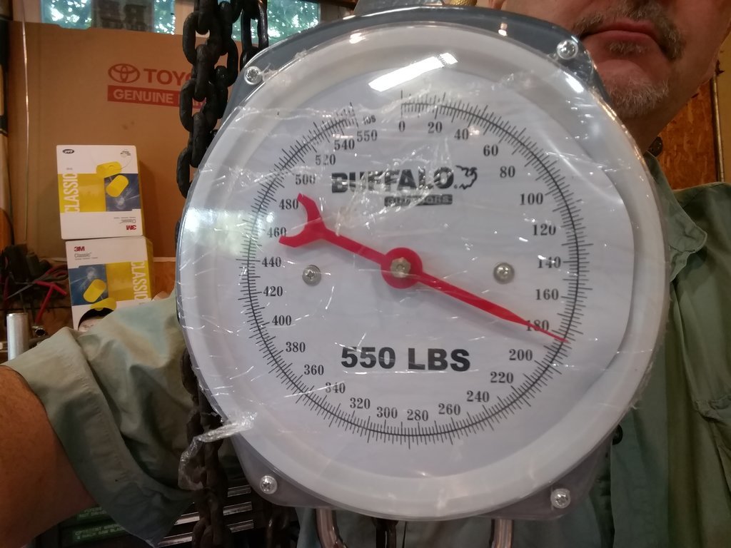

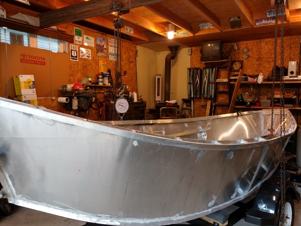

    I wanted to know what the boat weighed. I picked up a cheap game scale. The boat is balance between the 2 chain falls with the scale supporting half the boat. I was happy. It came in under 400lbs.
