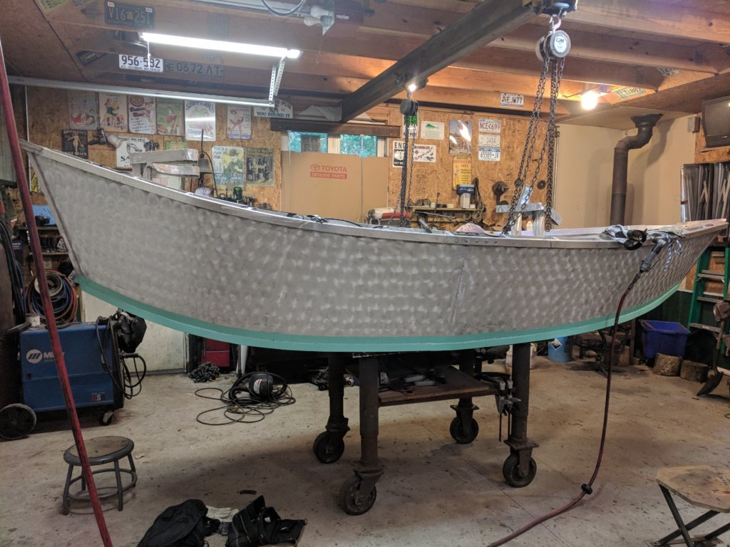

    I thought long and hard on what I wanted to do for the outside finish. This boat is meant to be beat up and abused. I figured a fancy paint job would only make me want to baby the thing.
    I ended up using Scotch Brite polishing pads to make the swirl pattern. This worked great in my humble opinion. The swirl hides lots of imperfections...almost all imperfections. I couldn't hide the side panel seam completely.
    In case any one is wondering about the bent up thigh brace, yeah, I fucked up.
    I had the boat upside down on the trailer and was lifting it up to roll out the trailer. The anchor rope was wrapped around the thigh brace and the loose end was under one of the tires. I can fix it.

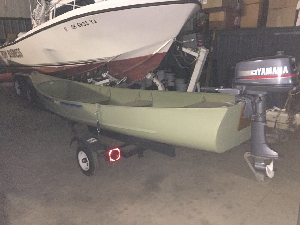

    Just stumbled onto this... Beautiful work. I live in northern Ohio near steelhead alley... Ohio law is really screwed up. If you are floating on the water, you aren't trespassing. If you are wading in the water you are breaking the law. I fish out of an old Grumman sport boat that we restored. This is very tempting. Amazing skill set you have sir! I am fearless with steel but I always shy away from aluminum. IMG_1227.jpg

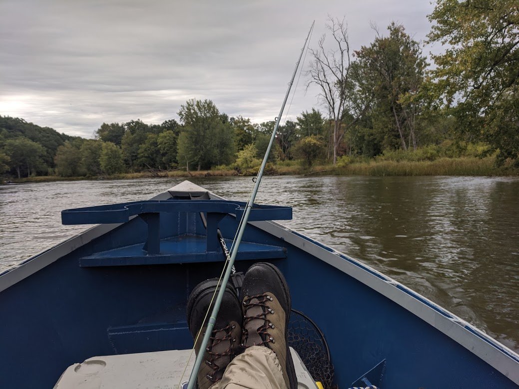

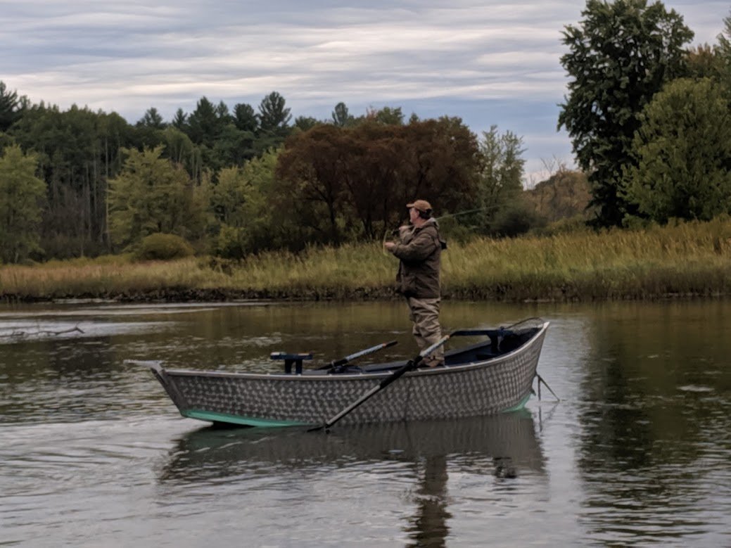

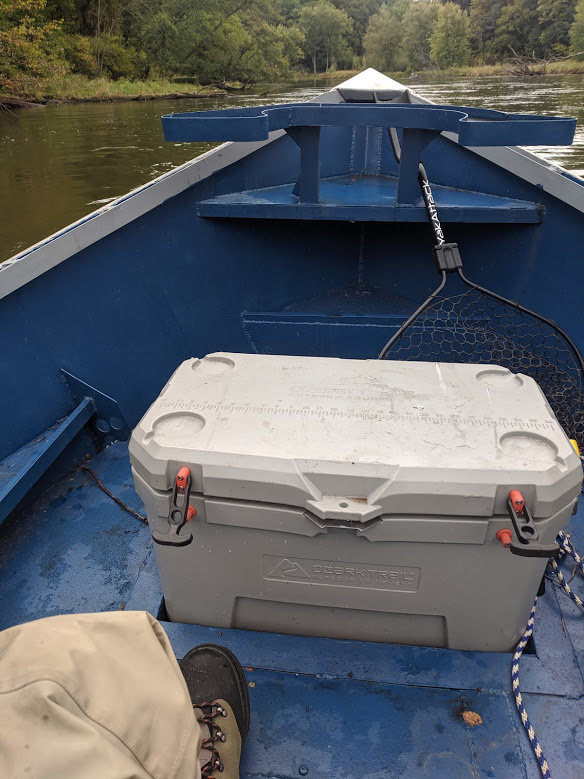

    Moar pics.
