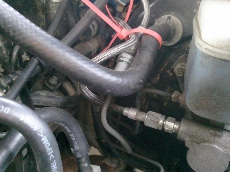

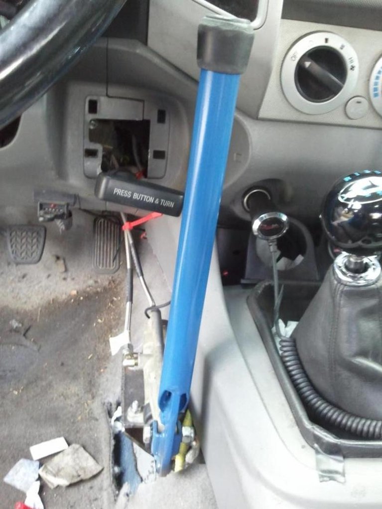

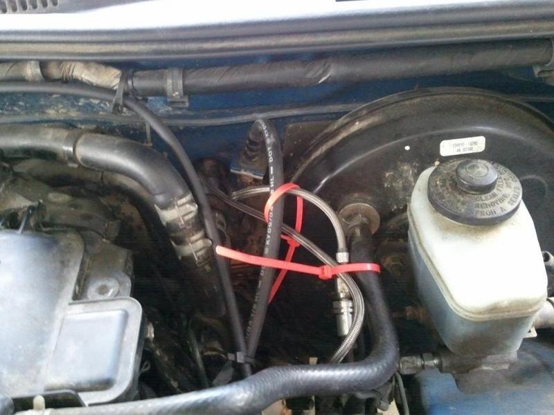

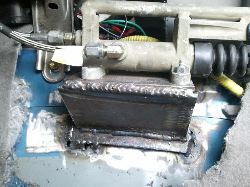

    This is the guy. Damn pictures didn't follow. I'll post them in a few.

    He never was one to make it look pretty. All about function. You get the idea though.

    To add to the pictures of the member's truck, which I posted, he eventually swapped to rear disk brakes.
