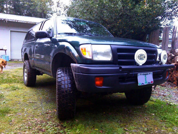

    Custom built light bar w/2 Hella 500's

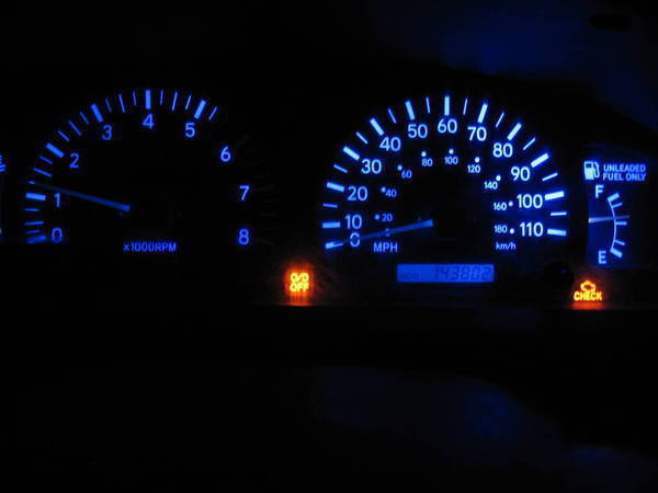

    Gauge cluster light swap

    Found out about Plasti-Dip :crapstorm: and did the grill, emblem, and accents? etc.

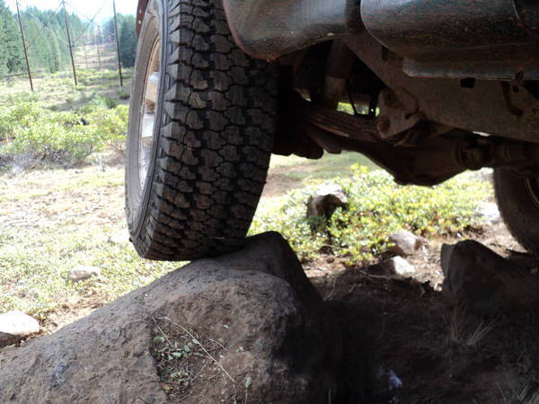

    Flexing the front OME w/swaybar removed:

    Swapped out the pea green gauge cluster lights for some blue LED's:
