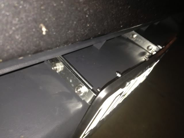

    Brackets from a hardware store.

    Is that sold as a license plate bracket or did you rig that up yourself? Looks good!

    Rigged it up myself. Four 4" straight brackets. Two L brackets. Nuts and bolts. Sandwich them on the lower grill. Voila. Custom license plate mount.

    The regular mounting points require drilling into the bumper. That's a no go for me.
