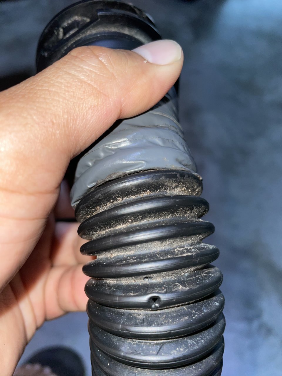

    A few folks have drilled through the filler neck by not using a drill stop.

    I’ve replaced 8 filler necks at work due to this…

    It happens when people drill where the photo has a screw driver sittin in the bed. Just use a drill stop and your fine.

    On the short beds, the gas fill neck is less than an inch below the drain hole on the driver side. Trust me I know ….

    wish I had read this first
    mine is in the shop getting a new filler neck
    ugh
