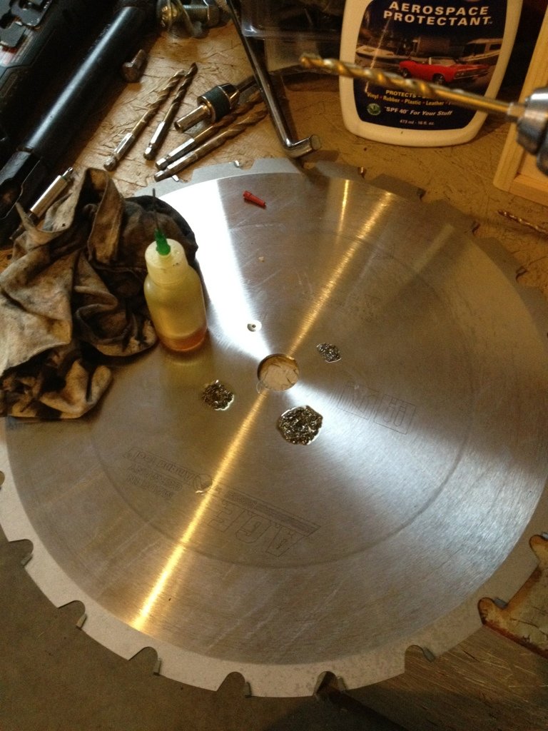

    Need tips on drilling holes in stainless steel saw blade for my rear tine tiller converted to wire trencher.
    Basically I have a 14" fire and rescue blade that needs 4, 3/8" holes for the hub/collar to mount up (I'll get pics up later).
    Anyway I'd tried this years ago with regular drill bits and it was a joke.
    I know I need low rpms and some oil. What I don't know is exactly what kind of bit is best????titanium, carbide etc.
    Please help any recommendations appreciated.

    Oh yeah I know better, but my drill press and two others locally are all too small a radius for a 14" blade to set on so I figured F it, I'll just go slow and use an ass load of oil and see what happens. I've actually made good progress . I'm probably 10-20% along after 45 min of work LMFAO. Definitely sacrificing several bits to appease the gods of cutting mayhem.

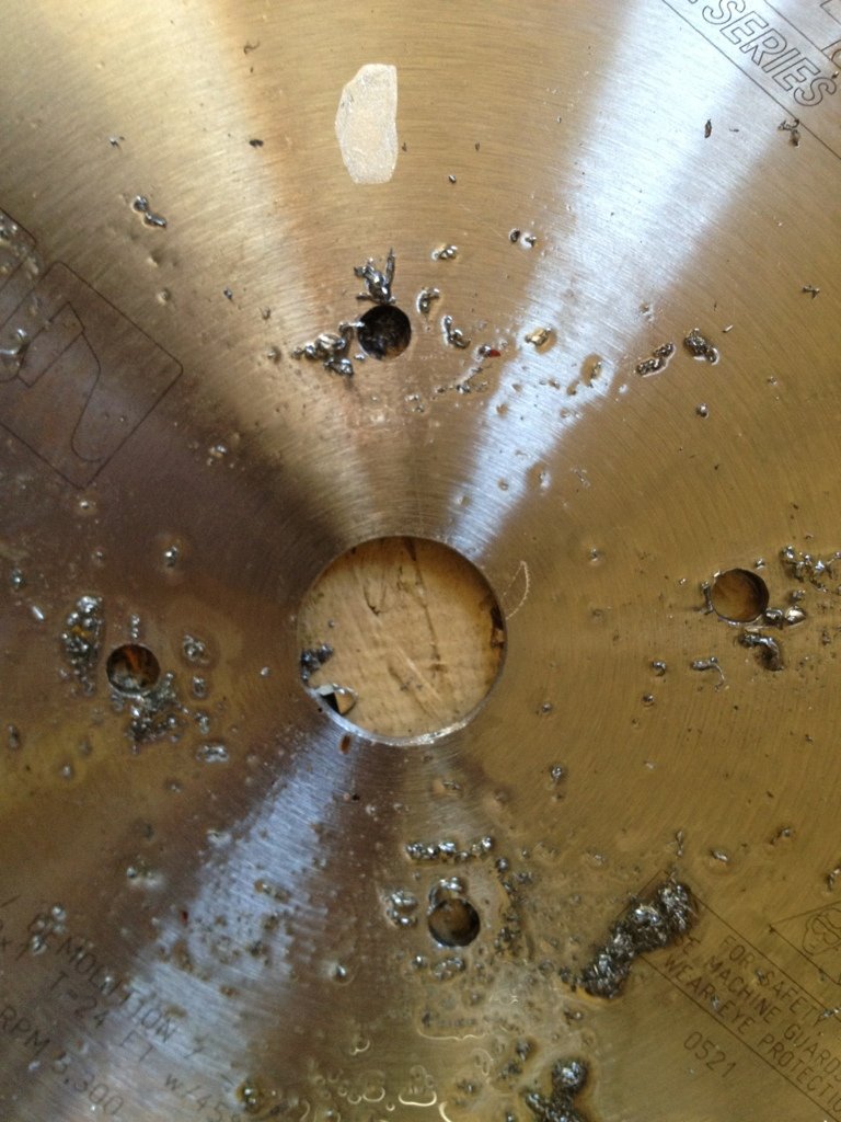

    Got a set of cobalt bits and finished up. Went surprisingly well. Probably another 45 minutes of work.
