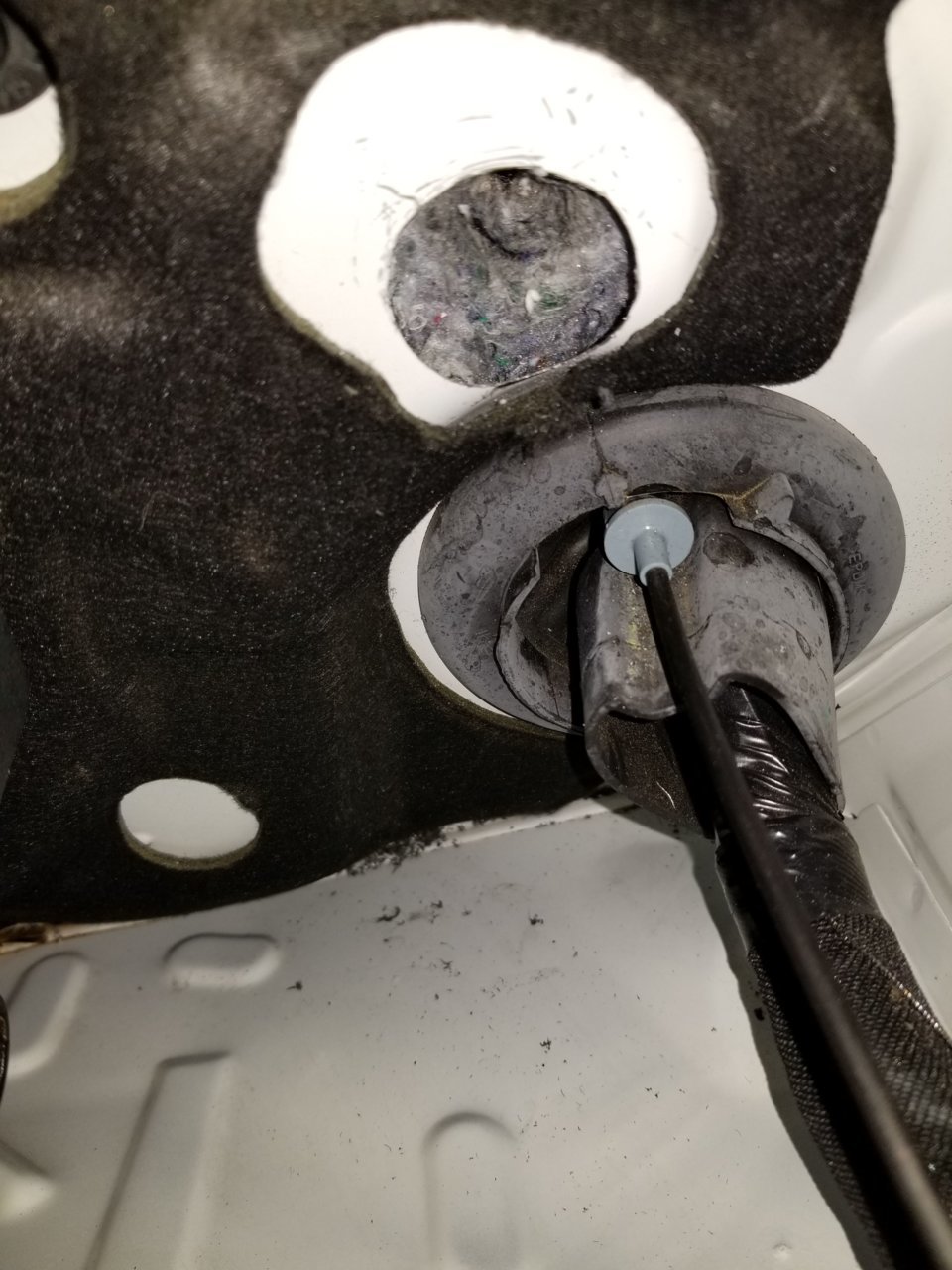

    Thanks all, from your comments I guess I must have gone too fast, pushed too hard, and heated it up, which caused the thin steel to flange out instead of getting cut.
    I just got a new harbor freight step bit and will try again. I've been using tap oil.
    If this doesn't work, I'll order a traditional 1-1/4" drill bit with a 1/2" shank.

    You can go fast at the start, but at 1.25" diameter you don't want to be over 250 rpm.
    A new bit and and cutting as slow as you can should get you there. Slower is always better than faster here.
    I have a harbor freight step drill and it has successfully put 6 holes of this approximate size in heavy gauge 18-8 stainless. Still looks new, too.

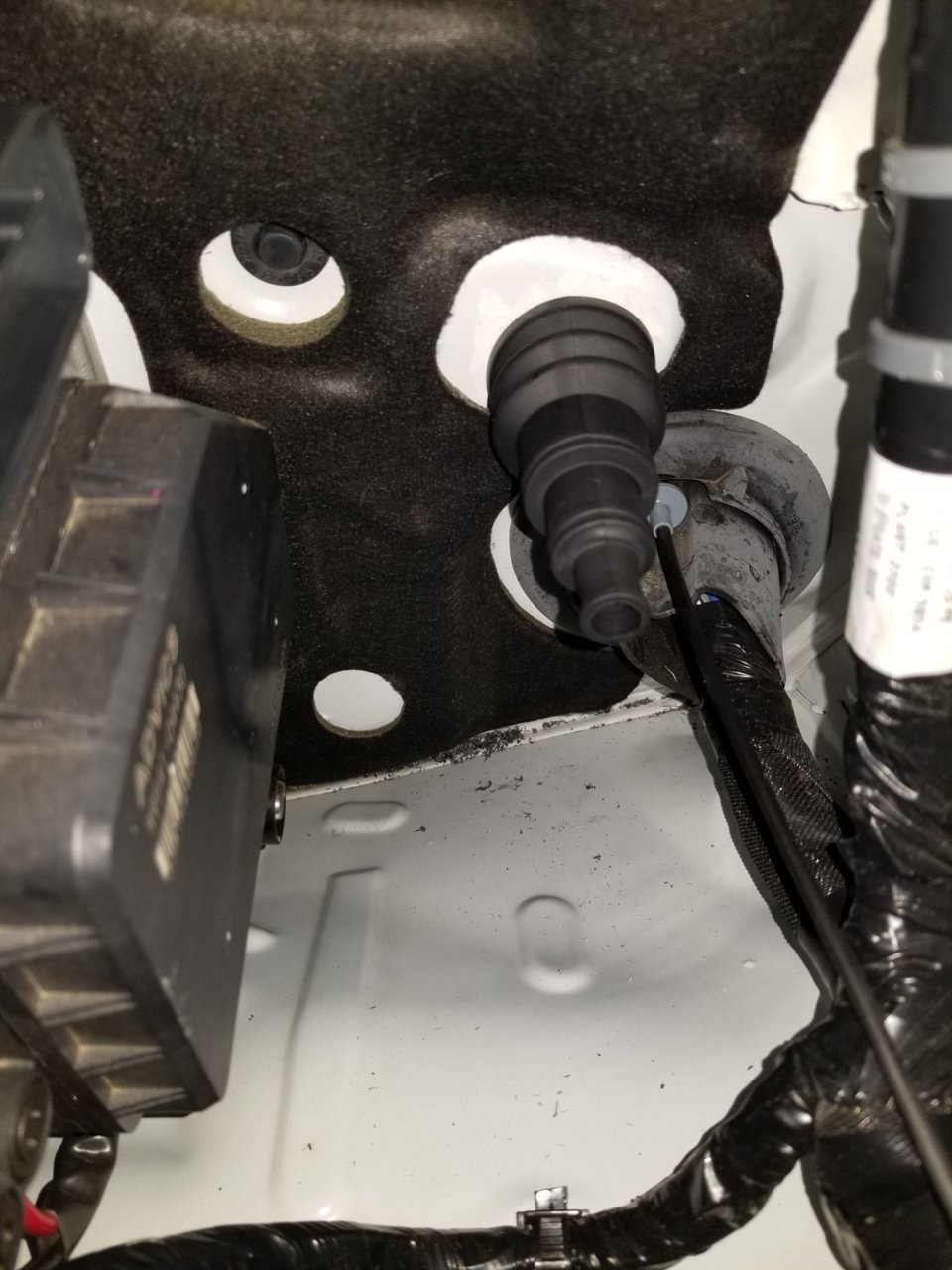

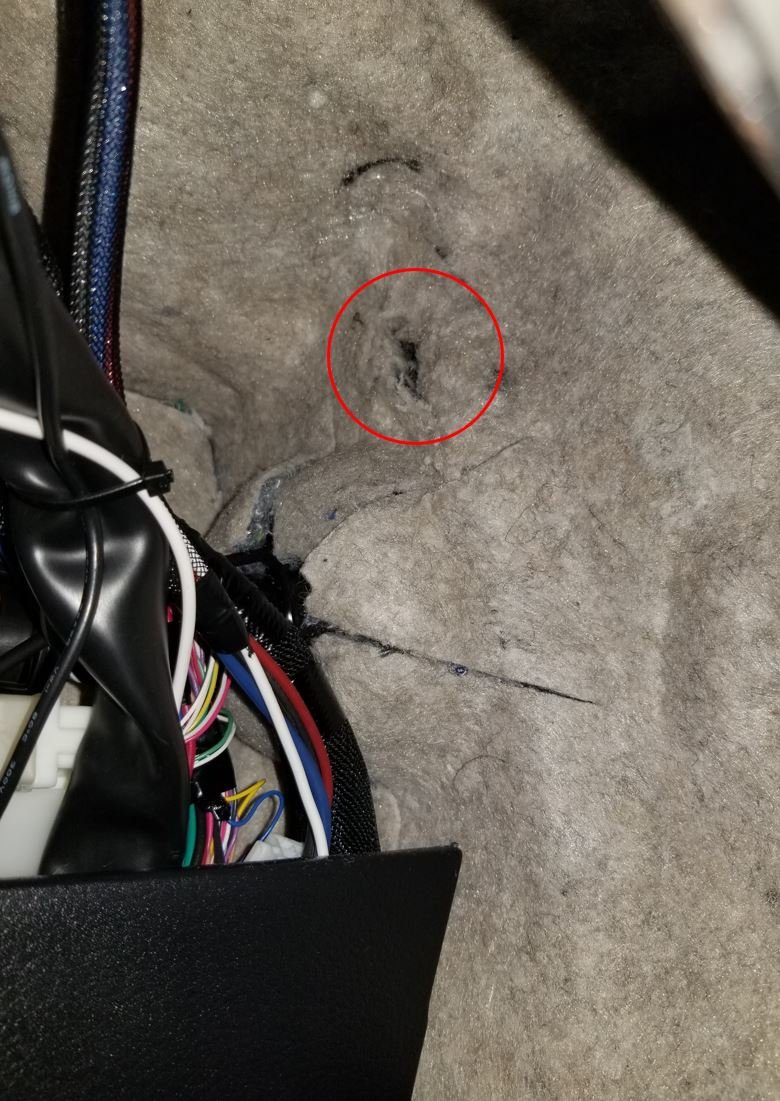

    Got it done. The new step bit and going slow and cleaning the bit and re-lubing every 20 seconds or so with tapping fluid did it for me. Thanks for the tips!
    It was nice to see that flange that had formed get cut off. I was able to just pull it out. The third picture shows where the cables will come into the cab.
