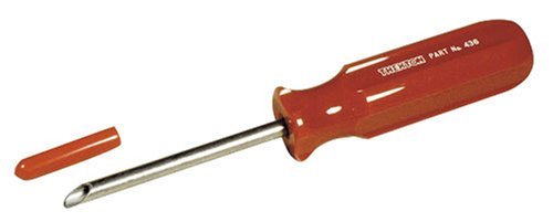

    7,489
    Stab this through, feed wire through, remove tool.

    They sell these in the prison commissaries don't they?!?
    That's on mean looking tool. Never seen one, but I am sure it would work great!

    Sold as "Cellmate Core Sample Tool" at Ace Hardware.

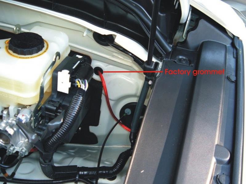

    There is a small 3/4” grommet up above and sort of left of the main firewall boot. There is another one same size on the passenger side firewall above the AC line boot. Use either of those if you haven’t yet. They are super easy to run wires through.
  11. Apr 10, 2019 at 4:37 AM
    JdevTac
    JdevTac Well-Known Member
    Jan 8, 2012
    #70234
    6,267
    Josh
    GA/WA
    2nd gen
    See my pic below for grommet location:
    The Daystar firewall boot with 2 loomed wire bundles comes out is where the factory 3/4” grommet is. I enlarged this hole and added the Daystar boot to be able to run more wires. I didn’t want to drill a whole other hole.

    This is an FJ cruiser but the red wire is going through the other 3/4” grommet I mentioned:
