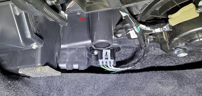

    Pulled out my endoscope and did some playing around. Originally I was thinking here by the blower resistor but I'm not too sure now

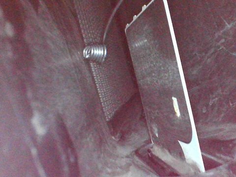

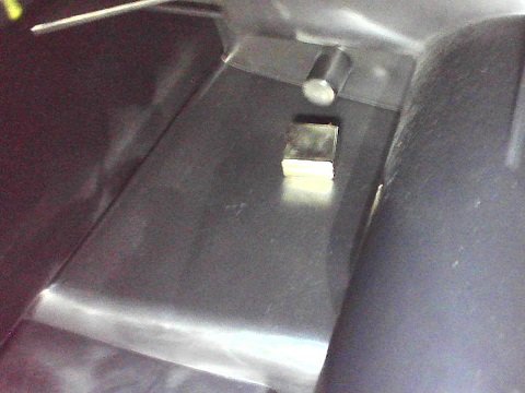

    I used some chicken wire coiled up and a magnet to confirm exactly what is on the other side of that spot
    This would in theory work but I feel like it would dump a lot of the contents of the evap cleaner towards the blower fan. The instructions for BG Frigi-clean instructs you to drill into the HVAC box and empty the can while the blower fan is on, probably for this reason? I think the best spot would be on the back side of this box more towards the driver side but it's impossible to get to. Or maybe I could just use that hole but make sure I stick the spray tube as far in as I can before emptying it.
    Another idea was to maybe do it on the drivers side of the evap but I couldn't oriented myself like I did with the resistor.

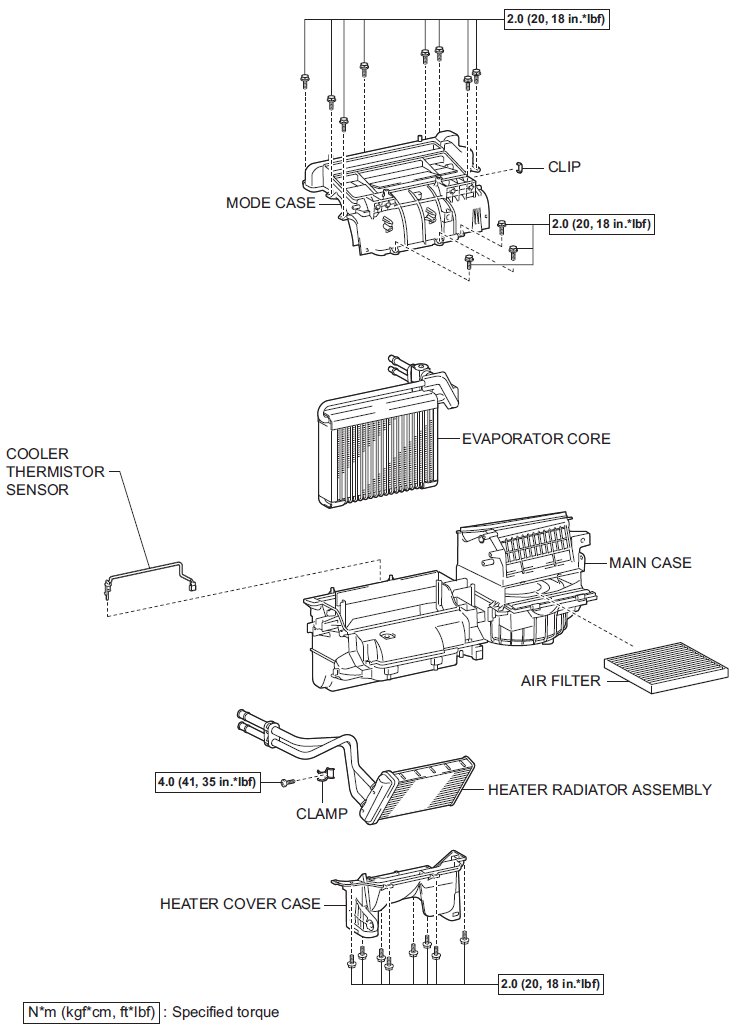

    Mike,Dropped blower motor. Hand cleaned black grime off of each fan blade and inside lower main case. New cabin filter for now. I like your idea and will try to cap duct to inject foam cleaner.
    Caribe, thanks for exploded view. Looks like need to take off cover to heater core and clean that separately.

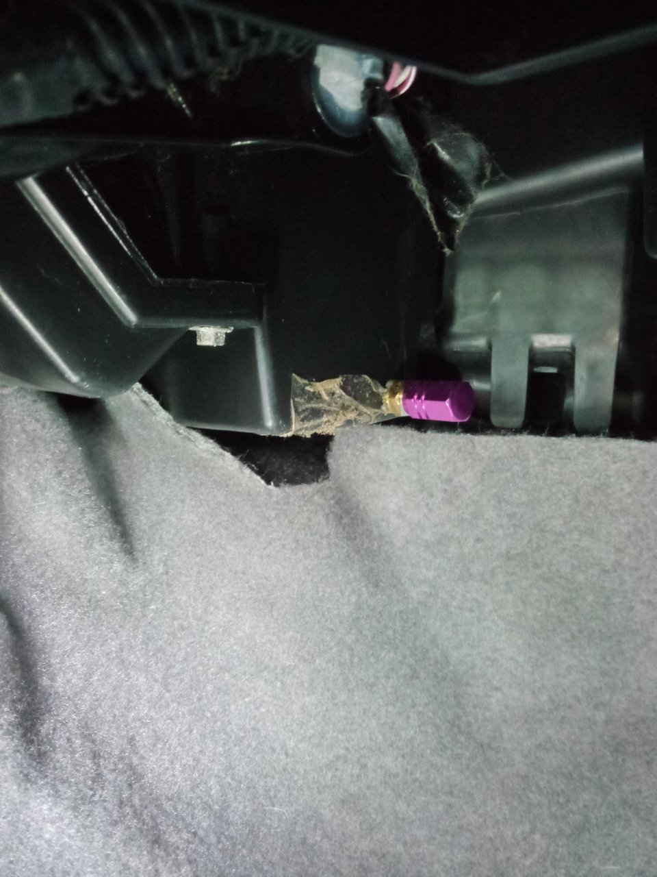

    Use a drill bit, thats the only proper way for a nice round hole. I don't remember what size bit I used but I just eyeballed it, not too big not too small. One end of the brass adapter included in the kit has course threads on it that self tap the hole and actually do a pretty nice job of it, for extra insurance I did coat the threads with a little epoxy before snugging it down. I'll have a pic for you by tonight!

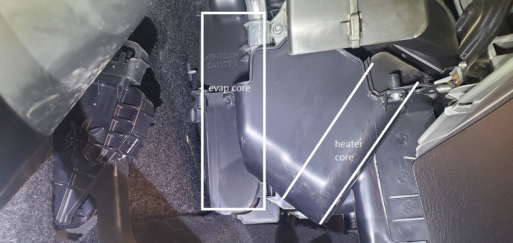

    This is useful, do you know if you can take the heatercore cover off without pulling the dash, just for inspection? Both my heat and AC smell nasty and I've been dealing with this for years. The original owner must've done something special. Next stop is to try ozone treating my system.

    This is where I ended up installing my port. I looked at as many pictures as I could but at the end of the day I just took a educated guess. I will say though that after spraying in the Frigi-Clean in per the instructions I had foam cleaner spitting out of my ac vents in the cab as well as coming out of my A/C drain hose, felt confident is worked its way around the whole system. Can't recommend the stuff enough. (please ignore that oem nasty tape, I don't know what that stuff is made of but good lord it's on there!
