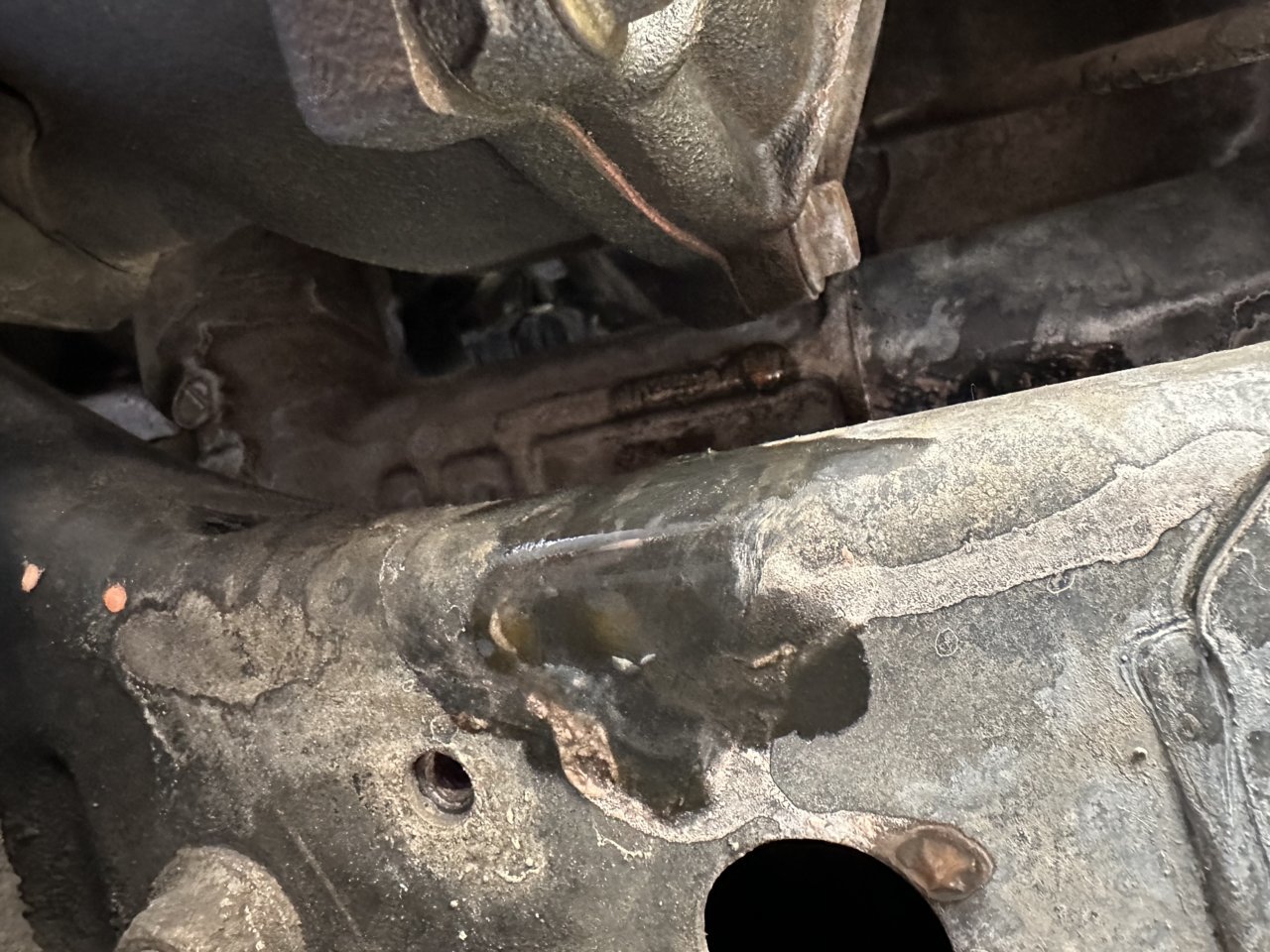

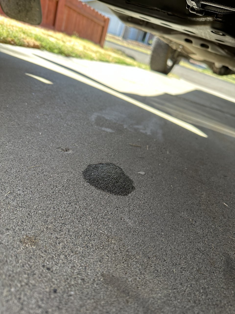

    Have an intermittent drip at the front of my 2011 Tacoma. It looks like water but is greasy and slightly sticky. No smell either. Just had my differentials and transfer case serviced. Check out the pictures for reference. Anyone have a clue as to what this could be or am I being paranoid about AC moisture?

    What side of the truck ?
    Kinda hard to tell from the 2nd pic.
    Maybe power steering ?

    If it’s water it’ll disappear when it dries. That’ll tell you if it’s not. Looks to me like a bit of oil possibly. I’d inspect around the engine, clean note all fluid levels and monitor.

    If that is pink crust on the frame then it's a coolant leak
    Check the water pump weep hole

    sorry middle.

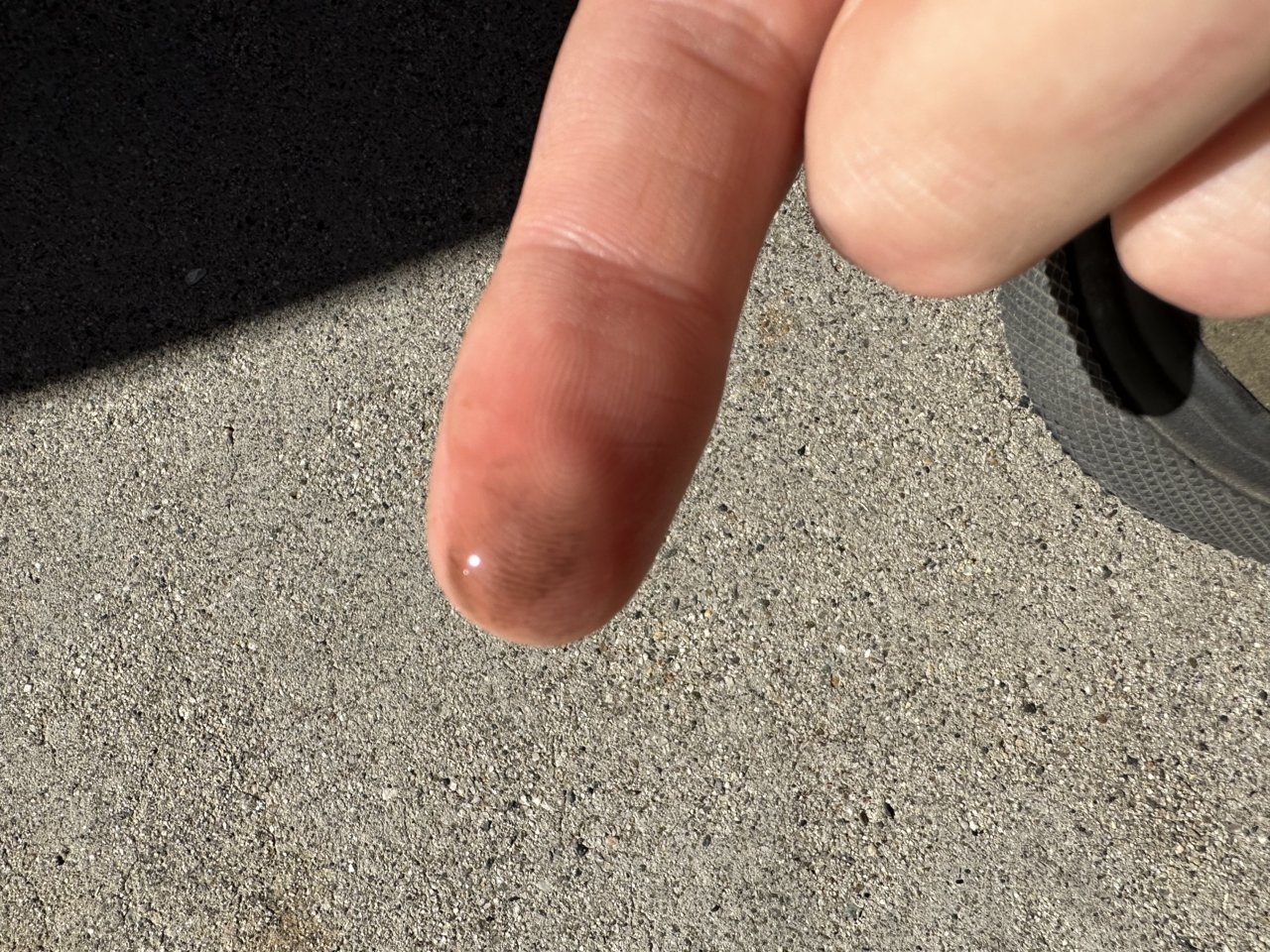

    So took another look and got some on my finger. It’s pink and just so happens my coolant is pink. Also looking a bit low since I just filled it.

    Sounds like that’s the issue !

    Yeah probably water pump seal failing. It happens.
    (if it was an i4 I was also going to suggest the coolant bypass pipe - not an issue on the v6)

    Check your power steering reservoir my line rusted out last week and had fluid everywhere. $300 later its fixed. I have 137k on mine seems the average miles for them to rust out
