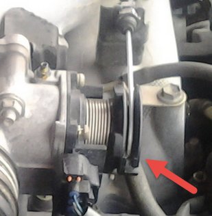

    As I said, there is still a cable attached. Also, it's not fly-by-wire or drive-by-wire, people seem to think generic terms apply. It is however under the same concept, the sensor tells the computer how much to open the butterfly valve in the TB. Unless only the 4wd got ETCS (unlikely, but never know) you should see the same as this:
    yes :thumbsup:

    Yeah my truck looks the same, except i have another wire for cruise control. So that wire that comes off your throttle goes strait to the pedal. But a computer still controls it, very interesting

    Another easy way to tell if it has the electrical wire/actuator.......
    If your throttle cable connects to black plastic on the front of the throttle body, then it's the electrical wire/actuator design.
    Pic from Frizzman's engine.
