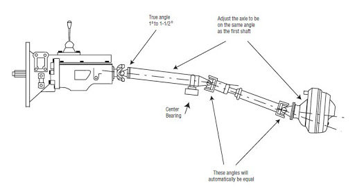

    The pinon angle must match the output shaft (1st drive shaft after the transmission) angle. If they don't match you're going to experience vibrations.
    See this Dana document for a comprehensive explanation. And this thread is also helpful.
