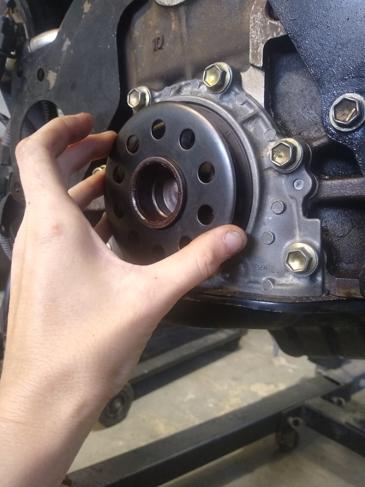

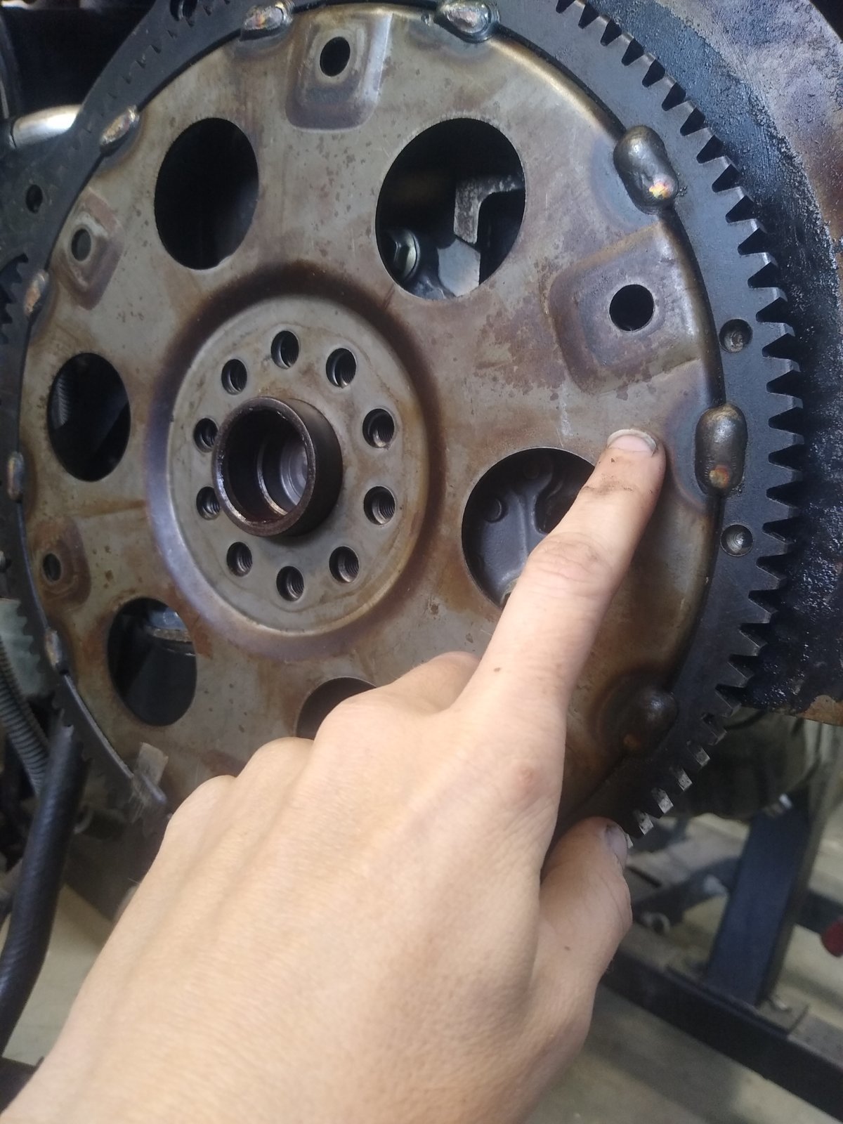

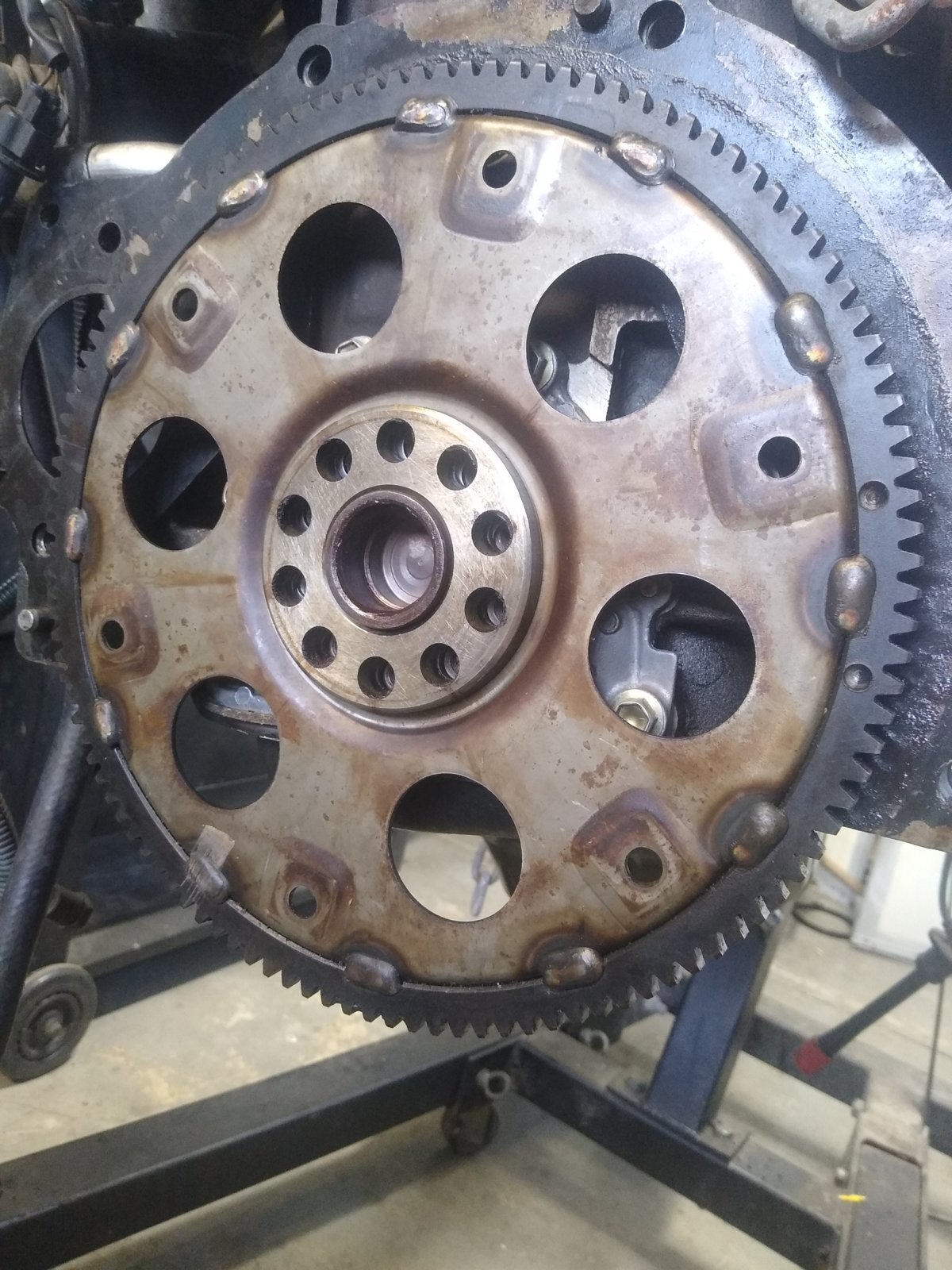

    Hi friends,
    Currently installing my drive plate/flex plate to the block. Found online the order of the spacers/ following FSM to guide.
    What haven't seen understood yet. .
    which side of the flex plate faces torque converter/which faces engine,
    this is where at right now for visual/see: pics below, current order of installation.
    Pic 1 black spacer to start
    Pic 2. nubs (torque to flex plate bolt in) point outward will face the torque. If that's right

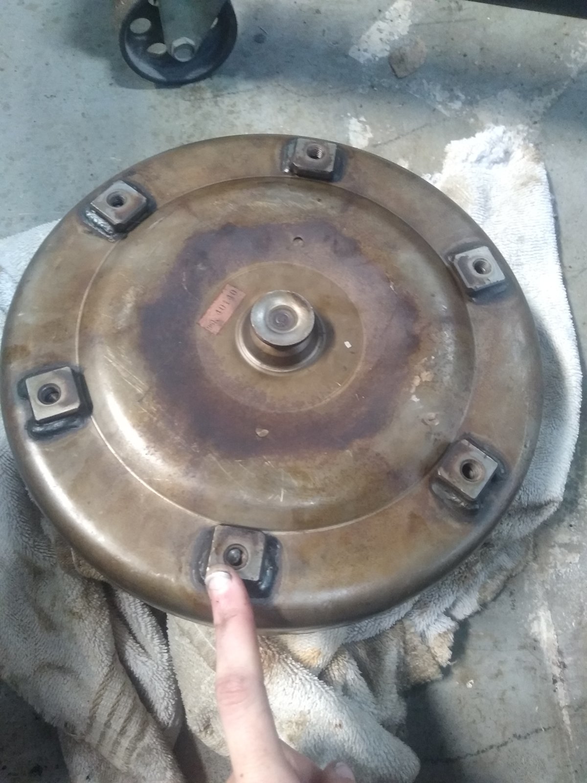

    Pic 4 silver metal space between flex plate n torque converter
    Does that spacer line up order n such (direction of flexplate to torque/engine block) look right, y'all?
    would appreciate anyone's input with these ?s ^_^

    Wrong orientation and assembly.
    Should go (Thick spacer - Flex plate *welds face towards engine* - thin spacer with dimples orientated correctly then bolted all together @ 61 ft/lbs.
