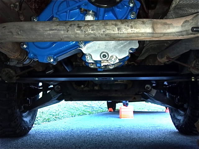

    Time for a one piece TW.;)

    Im running a one piece but not to much room for a carrier under my truck.:cool:

    BTW is your t-case mount bolted to your skid???
    oh nvm I see you deleted your cross member and tucked it up

    Yea cut that POS X-member out and flat bellied it with a custom X- member.

    I will be doing the same, but initial install and to not have to re do my skids Im staying with factory cross member until after moab

    See how far your yoke was being pulled out of the transmission. You need a longer driveshaft or a spacer to push the shaft further up in the transmission like it should be. Also you put added strain on your carrier bearing with the driveshaft being like that.
    Pic also added on how your yoke should be in the transmission
