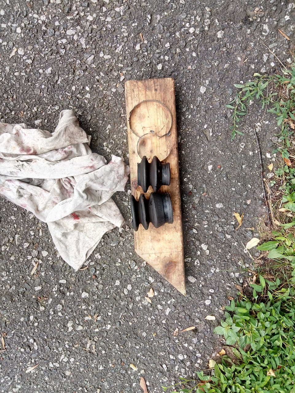

  6. Jul 19, 2021 at 4:06 PM
    tacofish
    tacofish [OP] Well-Known Member
    Oct 29, 2014
    #141318
    874
    N NJ
    14 ext cab 4x4
    3/1 lowrange spacer lift 285/70/17 wildpeaks
    Did the boot today
    Pretty straight forward
    One thing to remember is the splines on front of shaft only go in one way so the u joints line up
    At first I couldn’t figure out how come the shaft wouldn’t go back in, then I realized its i had to line up u joints
