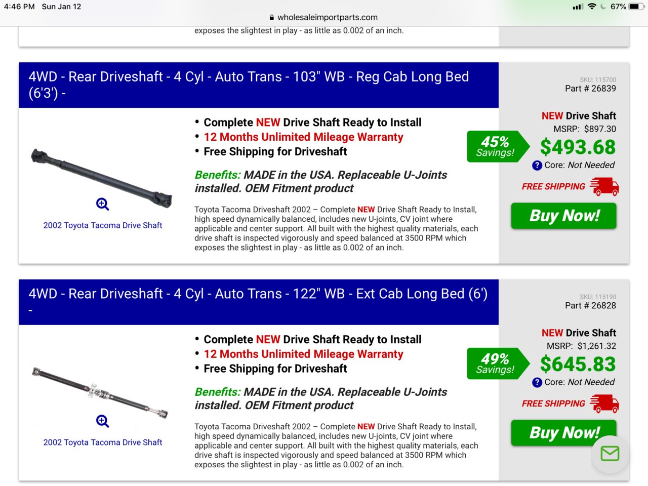

    I just got a completely new drive shaft two years ago.. Everything’s new! So won’t have to deal with any issues hopefully for another 500k miles. My slip joint and Cardin both were going out. These driveshafts have spicer parts and are replaceable if something happens.
    Took 30 minutes to remove and install
    From this site
    https://www.wholesaleimportparts.com/Toyota_Tacoma_Driveshaft_2002.php
