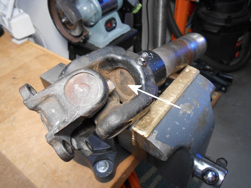

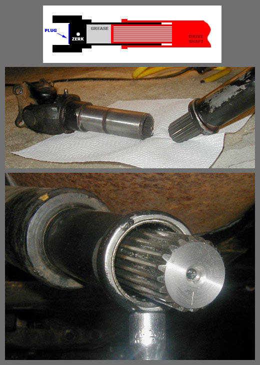

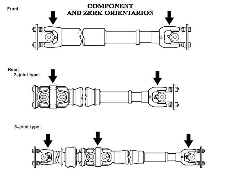

    Just one spline off is visually very obvious when compared to how it should be. The spline count is low so just one off is obvious. While they are balanced as a unit, the separate "halves" are still in balance and countless folks have swapped "halves" with other shafts with no vibration issues. Many folks carry just the rear half as a trail spare.
    Also note that if aftermarket u-joints have been installed, the kind with the zerks in the caps, who knows what orientation was used at assembly. In that case go with the yoke orientation from the drawing and test drive. Worst case, one or more of the joints is 180 deg out.
    There is a catch 22 with the grease fitting for the slip joint. The cavity at the end of the inside shaft is between the fitting and the splines. Therefore it is impossible to get grease to the splines without first filling up the cavity. Now if the cavity is full of grease, the first good "slip" of the joint can hydraulically pop out the core plug at the end of the yoke. Of course this depends on the condition of the joint, it's seal and if there are any air "bubbles" in the cavity. Been there.
    It's kind of a bad deal but it is what it is.
    The DC joint actually has a crude pressure relief valve. This prevents the centering ball from being hydraulically pressed out of position by pressure from a grease gun.
    When I occasionally use the slip joint zerk to "freshen" things up, I slowly bounce the rear of the truck up and down (with my weight, after greasing) a few times. Some folks go for a short drive or do the bounce with the zerk removed to get a little air cushion in there.

    This is why pulling the slip yoke out and manually greasing it is the best way to go in my opinion. Even if you fill the yoke with grease, the upper splines are still not getting lubricated because the yoke and propeller shaft would have to separate very far to draw grease to the upper splines and I don't think it's possible for the shaft to separate that far unless there's some excessive movement in your drivetrain.
