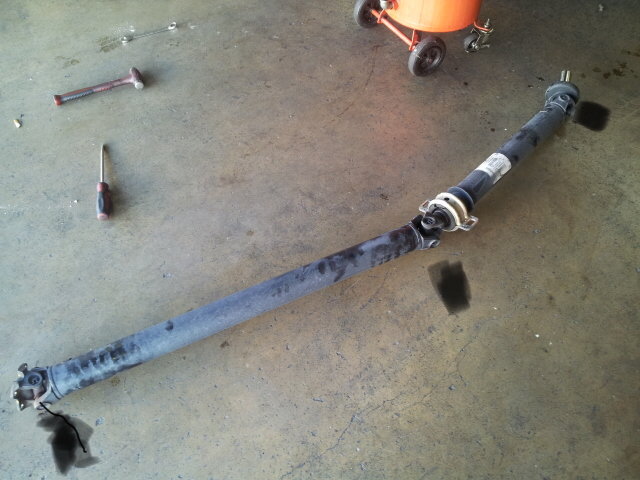

    Thanks again everyone- so I found 3 and I am embarrassed to say how nasty the old grease was. The ones I found were right on the knuckles on the shaft. I didn’t see the other two. Would someone be able to elaborate on their locations?

    lets be clear... you are talking about the U joints correct? as far as I know the slip joint is not greasable. U joints are

    not My drive shaft but here are the three spots I found today. Black hash marks. F6A261D1-2DA0-4B8C-9082-D7F674535833.jpg

    Front driveshaft.
    and those "knuckles" are u-joints
