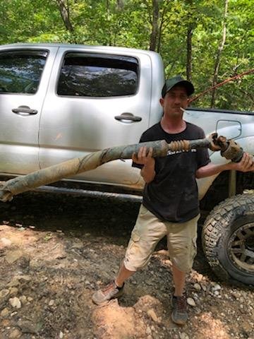

    Think Toyota would accept this for the DS campaign

    Why not, all you did was try to “rebalance” it to cure the vibes! Right?
    That didn’t work, so now you let the Pro at Toyota have a look. LoL
    BTW, Awesome pic.:thumbsup:

    Thanks. That thing got beat and finally decided to die. Just had a local shop rebuild it.
